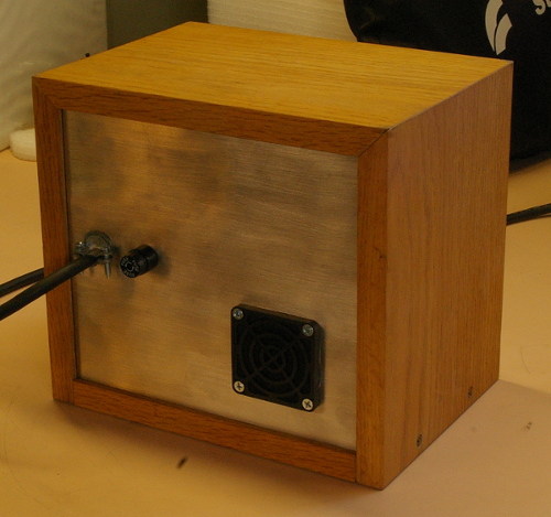

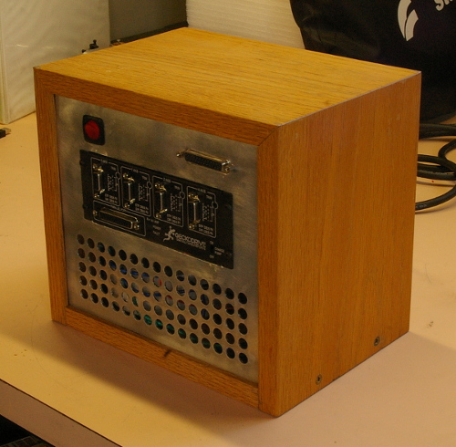

I've made some progress on the Sherline Lathe. I put together a driver box for the electronics. It has a toroidal transformer, 50V rectifier module, Gecko G540, 5v power supply, 60mm fan, switch and fuse holder. An old wooden stereo box had been sitting around for 15-20 years thatI re-purposed it for the driver box.
The separate DB25 plug at the upper right brings out the G540 terminal block and 5v supply.
The Lathe is so far a plain vanilla Sherline CNC conversion.

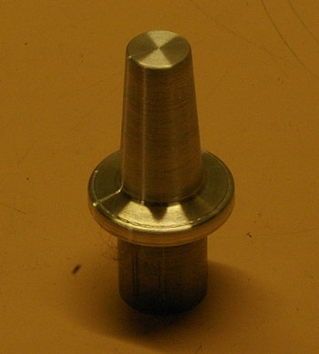

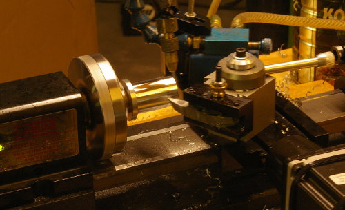

I've made some progress, mostly in learning how to run a CNC lathe. Seems a different ball game than a mill. It's only two axes, instead of three, so how could it be difficult? I set off learning the new turning portion of CamBam. It's not nearly as polished as the milling portion but eventually seemed workable. I couldn't get the roughing lead in moves to work, but that's a topic for the CamBam Forum. CamBam came with a LinuxCNC-turn post processor which I used without modification.
I had some learning difficulties, such as grabbing a scrap round of AL 1.5" diam saying that'll be large enough. The CAM was developed assuming a 1.25" stock. It didn't take too long to remember I had to cut the stock to 1.25". Then I had to come to grips with the Sherline. I have a 14" Goodway manual lathe and it took some experimenting to discover just how much less the Sherline can take off. After that it worked well. Here's a shot of the lathe during first cut.
The resulting part is one post of a towel rack for our trailer. There's a bobble around the flange, but I'm declaring it a good part.

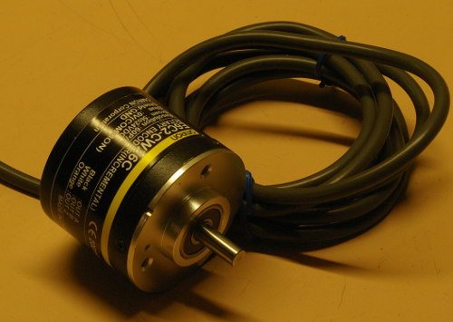

The slow boat from China did show up on our shores delivering a new encoder.
It is the same one mentioned above. It'll take some time to design and build the mounting, too many things getting in the way. But that is the plan. Then wire in the Sherline spindle speed control and maybe homing switches, although I may be OK without the switches. One step at a time.
