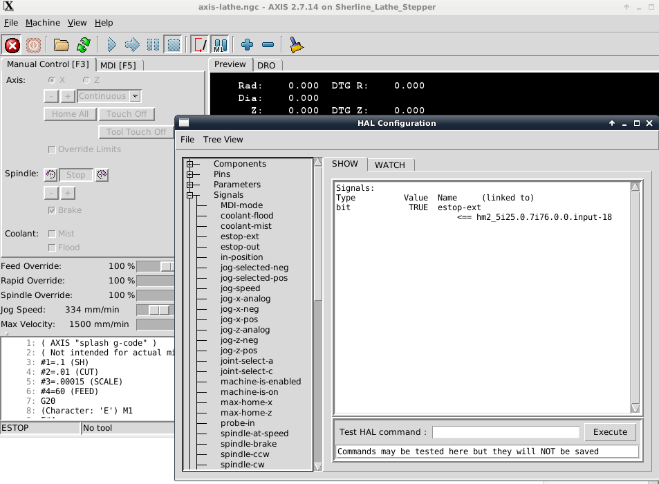

27 Aug 2018 20:48 #116688 by tml
Replied by tml on topic Emergency stop switch
Okay, I got the switch hooked up and it does disable the stepper motors when I press it (it's a latching type push switch). But on my Axis screen, the X button (emergency toggle) does not show it's pressed down. I've checked the "Show HAL Configuration" screen and can verify that it does change status from brown to yellow when I press the switch. Why the X button doesn't change when I press the switch I don't understand.
28 Aug 2018 05:09 #116695 by andypugh
Replied by andypugh on topic Emergency stop switch
Which HAL signals is the button connected to?
28 Aug 2018 11:08 - 28 Aug 2018 11:10 #116718 by tml
Hi Andy,
The button is connected to a signal called estop-ext. Attached is a screen shot of my HAL Configuration screen.
Last edit: 28 Aug 2018 11:10 by tml.
