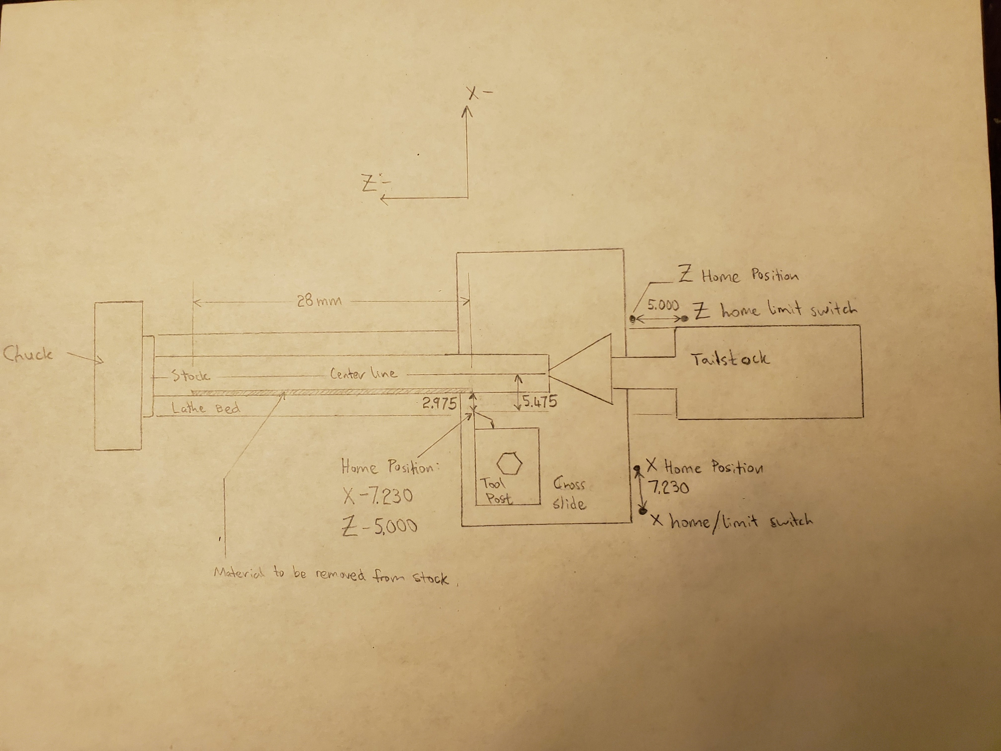

Can someone help me understand the relationship between the home position (X and Z after the home all button is clicked) and the X0 and Z0 coordinates? For example on a lathe setup X0 is located at the centerline of the starting stock and Z0 is located at the end of the stock sticking out from the lathe chuck. In this case, is the home position and X0 and Z0 the same or how should it be set up to be useful for running a CNC lathe program?

- Posts: 19899
05 Jun 2019 05:14 #135904
Replied by andypugh on topic Mini lathe conversion to CNC
Typically the home / zero position in machine coordinates will be all the way out for X and all the way right for Z
Then the working area for both axes will be in negative numbers, in machine coordinates.
But: you don’t work in machine coordinates, you work in work coordinates. Typically the X offset (stored as G54 and friends) will never change and will give true diameter for one tool, with other tools having tool offsets.
The Z offset in G54 will tend to be set to suit each job.

- Posts: 19899
07 Oct 2019 19:03 #147361
Here is how my lathe is set up, and how I use it.
X=0 is at the limit switch with the slide all the way out. Z=0 is at the limit switch at the tailstock end.
So, for all the work I do, the machine coordinates are both negative.
Then to set up I take a test cut with tool 1 (tool 1 is turning.facing and always has zero offsets in the tool table). I then set the G54 X offset to read the true diameter as measured with a micrometer.
Test cuts with other tools can then be used to set their _tool_table_ offsets. The Z-offsets of other tools are set by touch-off to a faced off test cut with tool 1. I use a broken 6mm end mill as a dowel, jogging the tools away from the faced-off face until the dowel slips through. I guess you could also use a test-cut shoulder and measure the true offset with a depth gauge.
From then on I never deliberately change the G54 X offset. But I change the G54 Z offset to suit the job regularly. Typically I figure out where a good z=0 will be with T1, touch-off G54 to zero at that length, then face off. If it doesn't clean up then I touch-off G54 to 0.5mm and repeat. (this is using a facing macro that I have, which starts from the current tool position and faces off incrementally to z=0)
You could, but it would be awkward.Ok, follow up question: let's forget about the work coordinates for a moment. If I want to, could I write my cnc program moves based on the machine's limit switch/zero position coordinates?
Pretty unusual with a mill too.This might be a dumb idea, but I want to hear what others think ... I imagine it's an odd thing to do in a lathe but maybe more common in a milling machine?

08 Oct 2019 01:20 #147402
by currinh
Replied by currinh on topic Mini lathe conversion to CNC
TML:
I am a novice, but let me try to explain my reasoning. It might help.
You could program from the home being X=0 and Z=0 (or X=Y=Z=0 for mill). However, the numbers have no relation to the part. I like to set X=Z=0 on the part. Then if I jog or use MDI the numbers used relate directly to the part.
You could program using X=0 and Z=0 at references on the part as home. However, if you move to machine X=Z=0 you end up at the part, or with X possibly inside the part. I use machine home for tool changes so this would cause trouble.
So, it keeps me straight to place home with X furthest towards me and Z furthest towards the tail stock. This is then the tool change position. Then set work coordinates with X=0 at the center of rotation, and Z=0 at end of part. Set these work coordinates to match your CAD drawing so the numbers displayed have a real meaning.
I do the same with my mill for similar reasons.
This all matches what Andy said.
Does this make sense?
Hugh

08 Oct 2019 02:07 - 08 Oct 2019 02:09 #147408
by tml
Replied by tml on topic Mini lathe conversion to CNC
Andy, I think my set up is pretty similar. It probably will be easier for me to learn what's wrong with my process if I just show you what I have so far. And most of what I've learned so far is just from reading and self taught that might need some corrections from those with practical hands on experience that I'm lacking. To start out, attached is a drawing I made to shows where things like home/limit switches are located.
First thing I do is click home all. The machine's homing sequence is like this: the cross slide goes toward X+ until it trigger the X home/limit switch and establish X zero, then moves back towards X- a distance of 7.230 mm (programmed X home position). Machine then moves towards Z+ until it trigger the Z home/limit switch and establish Z zero, then moves back towards Z- a distance of 5.000 mm (programmed Z home position). Screen then displays the coordinates X-7.230 and Z-5.0000.
What I just want to do right now is a simple turning operation on a long piece of stock. One end is supported by a live center from the tail stock. I simply want to make a light cut with a depth of cut of 0.2 mm and length of cut 28 mm. The stock is small diameter (5 mm) to be turned down to 4.6 mm. Distance from the tool's cutting edge to center of the stock is 5.475 mm. So I go into tool table and put -5.475 for X offset. Please let me know if this is right or wrong.
Now for the CNC program to do this turning task, this is my first attempt from looking at some samples:

Basically I want the machine to just rapid the tool straight towards the stock then steadily bring it in more just enough for a light 0.2 mm deep cut. Then have the slide move towards Z- a distance of 28 mm to reduce diameter of that section from 5 mm to 4.6 mm. Then finally bring the tool back to original home position (X-7.230 Z-5.000). Does this look Ok?
