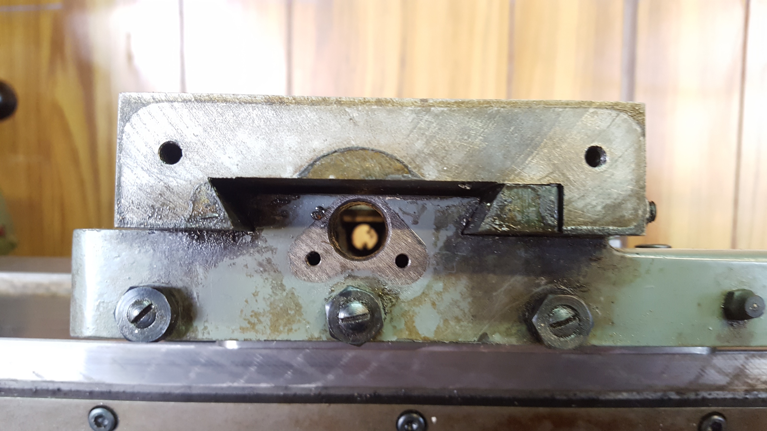

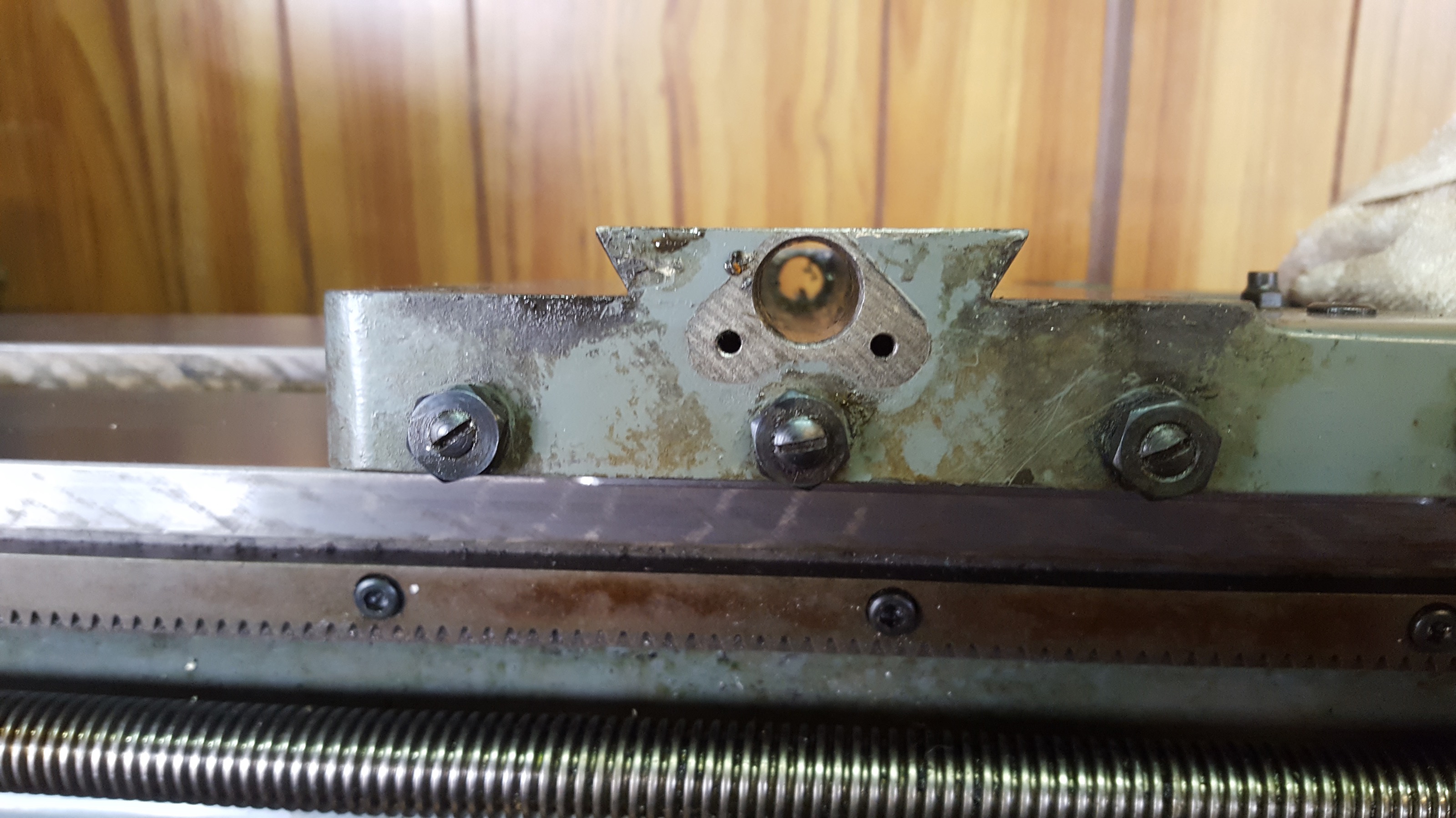

Pics to explain....
Saddle with 1/2" holes and nut attachment point:
Saddle with Cross Slide attached.... not a lot of room there....
I checked out DumpsterCNC and they do have anti-backlash nuts available to 10-2 and 12-3 trapezoidal acme rod, might just go that way for now until I can work out the ballscrew option....

If you poke around on alibaba, you might find a 10mm ballscrew. Here are some to get you going.
www.alibaba.com/product-detail/TBI-SFK-B...24838.0.0.SdqTMd&s=p
Could you make a standoff so you could move the nut away from the dovetail?

Thanks Rod, been banging my head against the wall trying to get damn alibaba to play ball with 10mm ballscrews, nice find there. Funny how the small stuff is way more expensive than the bugger stuff!
And yes, will have to make a standoff to attach the ballscrew nut to, the inside thread bit will be the tricky bit for a novice lathe user

Oops, the inside thread of the nut standoff. The nut would be a R1003T3-RSK which is a round nut with a threaded section (M18-1), the standoff would need a hole in it with a thread to accept the nut. I could simply bore the hole to 17mm and then buy an M18-1 tap and do it by hand I suppose.

I don't think you will need to tap a hole. If you look at that link again, get the SKF01004 Nut with the flange on it. Its only 14mm x 20mm. (the second of the 2 nuts they show).
You might need to be creative with a 2 part standoff if the mounting holes on the lathe clash with those on the nut. Maybe there is a part that attaches to the lathe using cap screws in counterbored holes. Then a plate for the ball nut to mount to that has a turned boss to locate it in the bore.

This is a common problem.
I used to have photos on cnczone of how I got round that with my mini-lathe, but they disappeared when they pulled the plug on Picasa.
However, thinking about it, it might not be that relevant anyway, as the mini-lathe has the nut on the cross-slide, and the Myford has it on the saddle.
I used a very small pulley (barely bigger then the screw) and T2.5 belt to turn the screw, with a needle-roller to take the belt tension. I then moved the thrust bearings towards the user, mounting them in a housing that replaced the handwheel bracket (I kept the handwheel). Moving the thrust bearings out of the way was a big help in making stuff fit.
It is possible that a rotating-nut arrangement might help. As the Myford moves the screw and not the nut, this might make getting the drive in easier. But I suspect that there basically isn't room.
Depending on how much space there is between the lathe and the wall, I think I would be looking to mount the motor round the back, driving the end of an extended screw with a belt drive. T2.5 and T5 belts have effectively zero backlash, and let you wrap the drive round itself for compactness. Even if you don't do this, a belt drive will take up less axial space than couplings.
whether you but the thrust bearings in the front side or back side would be a matter of taste. I think I would use the front side, where the handle is, but I don't have a Myford to look at to decide.
The best nut-diameter to screw-diameter ratio seems to be the RSH1605 nut, which is 1" diamter and takes a 16mm screw. However it has a surprise, there is an external ball return tube not shown in the catalogue.
Here is how I got round that with my mill
I used the same nut on my lathe, but have more space than you.
The only nut that will fit down the existing hole in the saddle is for a 6mm screw, and that probably isn't worth considering.
However, my Mini lathe ran for years with an 8mm ballscrew and it never gave any trouble. So you could consider that.
(When I say "Mini Lathe" it was a 9 x 30 lathe, about the same size machine as a long-bed Myford, but made with half the metal)
How much space do you have between the centre of the saddle hole and the underside of the cross-slide?
The right answer might be a complete new saddle casting, with space for a ballscrew and built-in mounts for the Z-nut. With the Myford bed design this isn't beyond the realms of possibility (It would be rather more of a challenge with an inverted-V bed)

Thanks for such a comprehensive post Andy, interesting thoughts.
My original thought patterns were based on what cncmyford had done, his outcome, I think, was to make it all look like original. For the X he moves the cross slide and the motor (and everything else) mainly due to locking the nut onto the saddle.
I can safely get a 10 or 12mm ballscrew into the saddle with a little massaging of the holes through it. From what I have seen the 10mm offers a purely round ball nut in either 2mm or 4mm lead as linked by Rod. Since Rod posted re the nut I have found tons of 10mm ballscrews available from China. The 12mm screw would be better but the nuts are the problem, that is a problem of attaching it to the saddle. If I could somehow attach it to the cross slide instead I could have a "fixed" screw much like a router and that would keep the moving weight down (not having to move the motor etc as well).
I just measured the distance you asked for, it is 10mm from the hole centre to bottom of the cross slide. In my second photo there are 2 bolt holes, these are used to mount the original screw extension and the hand wheel. Thoughts running through my head as to make a mount for a ball nut that hangs from these 2 holes with the larger end of the nut facing away from the slide. In the pic the slide is pretty much at full travel towards the back of the lathe. My only problem after mounting the nut in this way would be mounting the screw, I could possible mount it off the saddle in some way based around the same bolts that will hold the Z nut mount.
If I can get a 12mm nut small enough this might be the way to do it.
What I might do is buy some cheap trapezoidal screws and nuts and have a play to see what I can fit and how I can fit it. I don't care if it fits within the "look" of the Super 7, it just needs to work.
