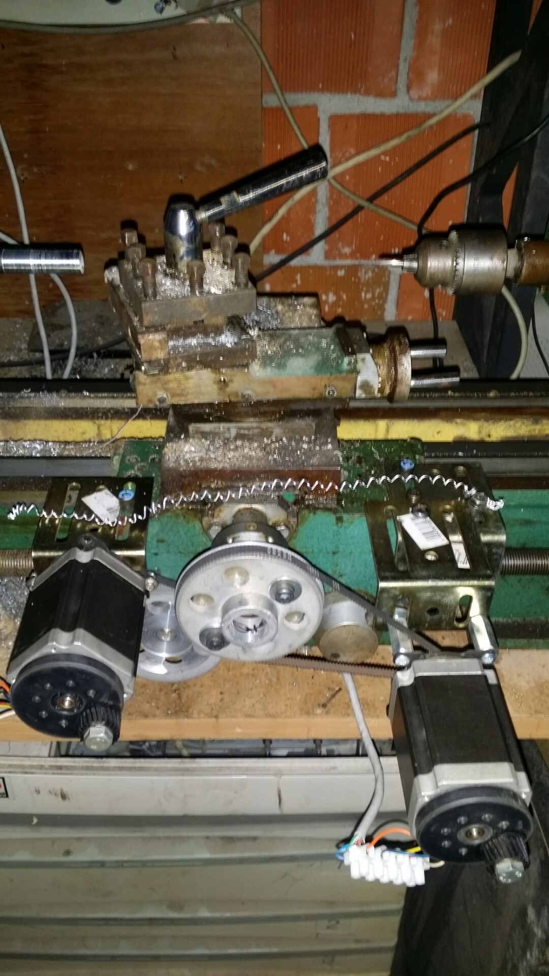

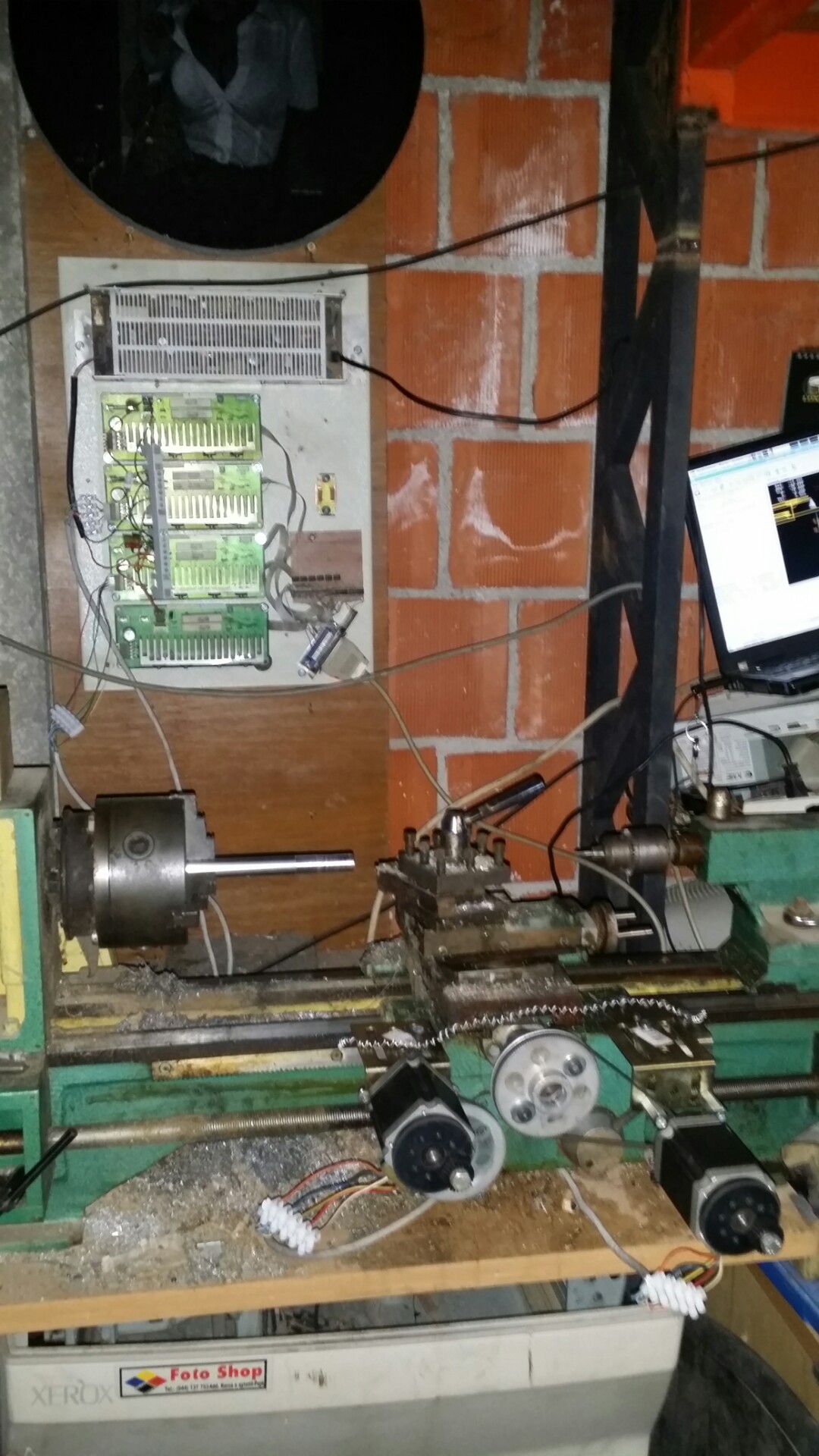

13 Apr 2017 22:46 - 13 Apr 2017 23:10 #91332
Replied by tommylight on topic Small lathe conversion
Last edit: 13 Apr 2017 23:10 by tommylight.
