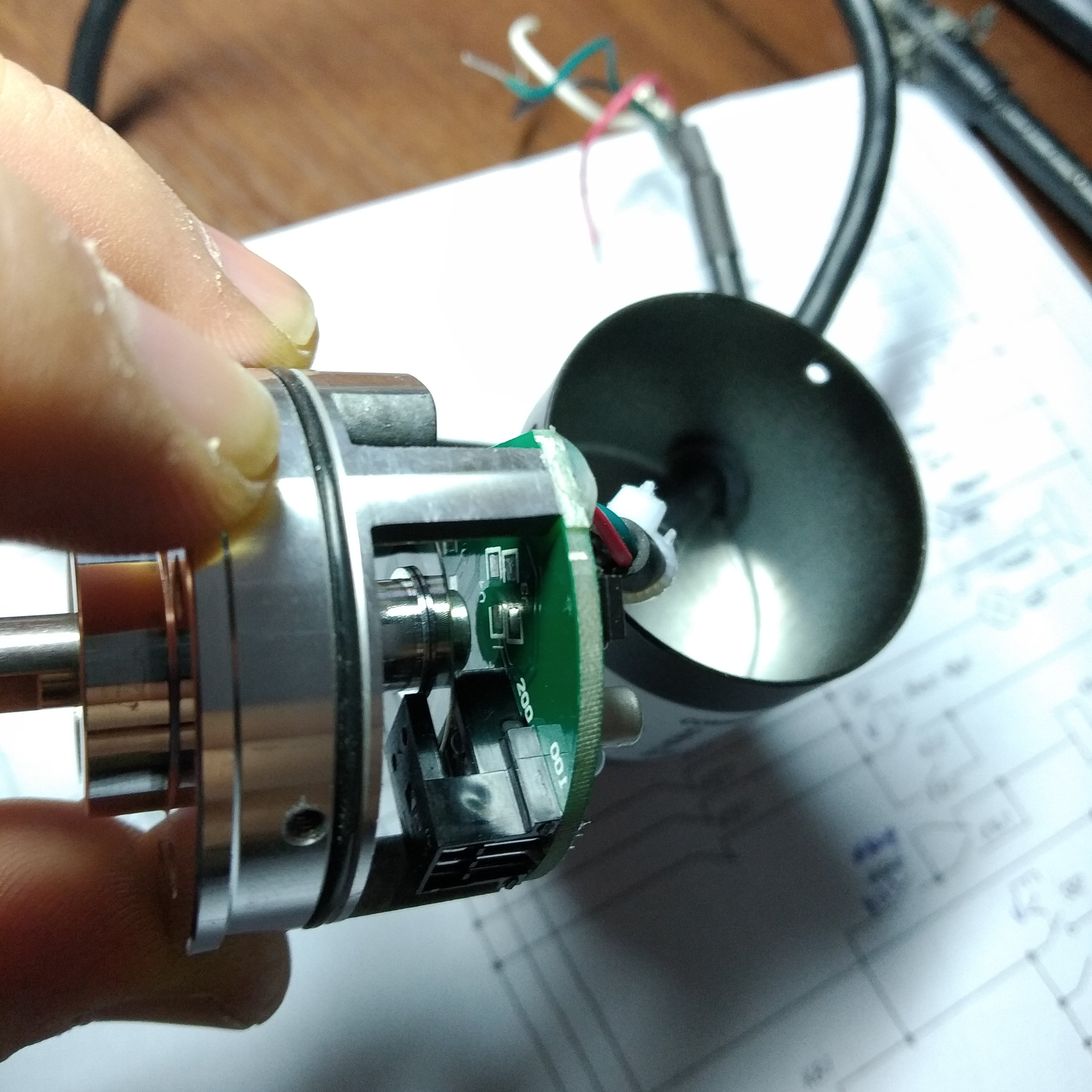

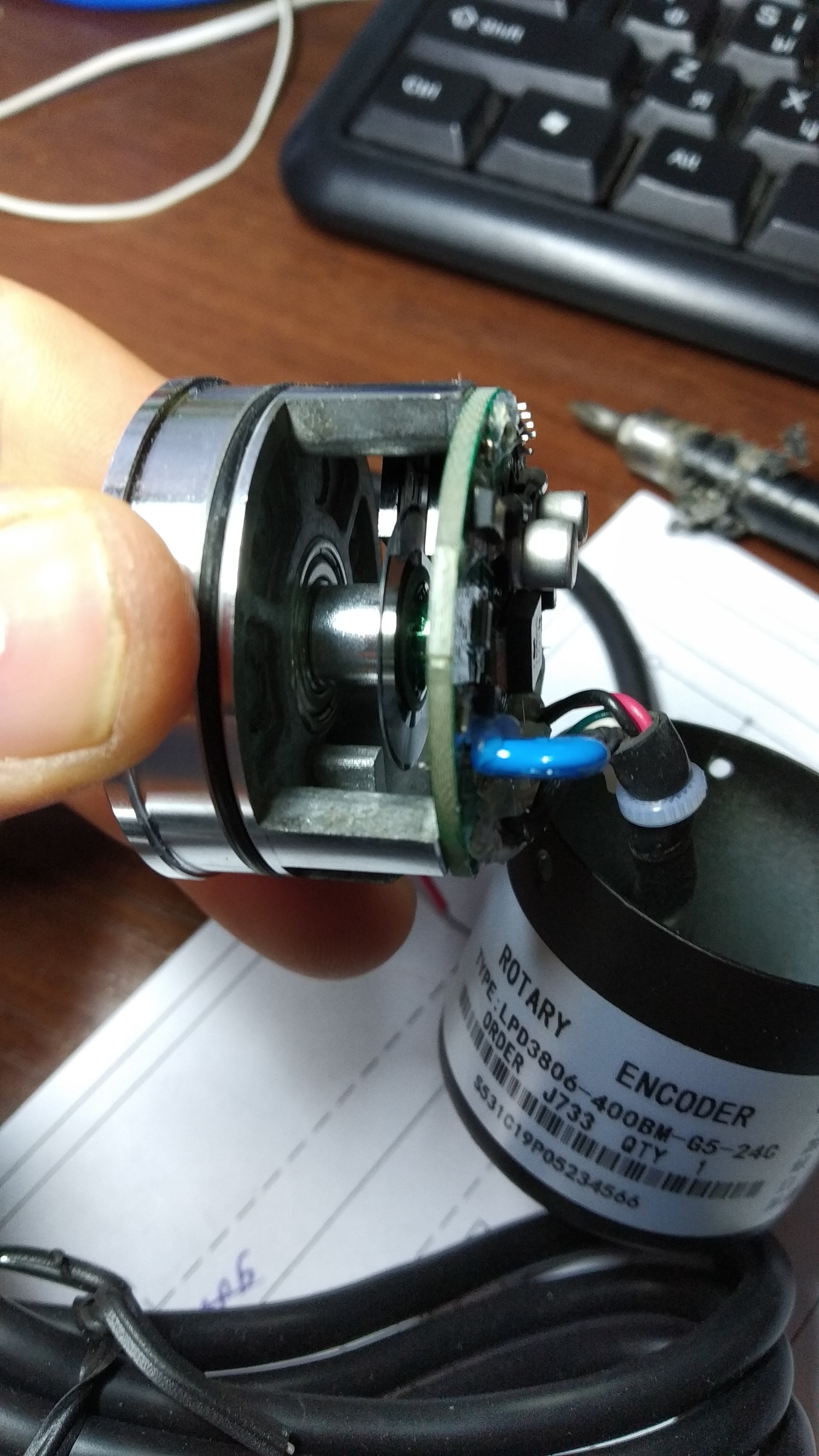

this encoders are made to go on double Axis Motors
for a lathe you may want it direct on Spindle

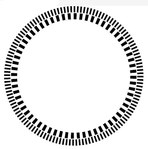

No, I was referering to the fact that most higher resolution quadrature encoders use a simple slotted (or photo lithographed) disk with only one ring of slots and the quadrature detection is done with Moire or Ronchi masks with an 1/4 slot pitch offset between the A and B masks.

Okay. I think I understand now. The second ring of slits is 1/4 the distance past the leading edge of the first slits and 1/4 behind the trailing edge of the next slit. Am I correct?

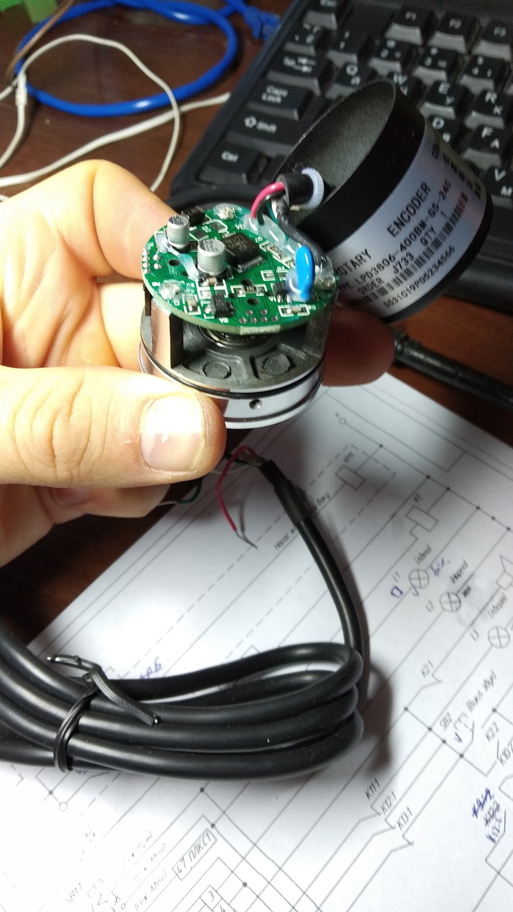

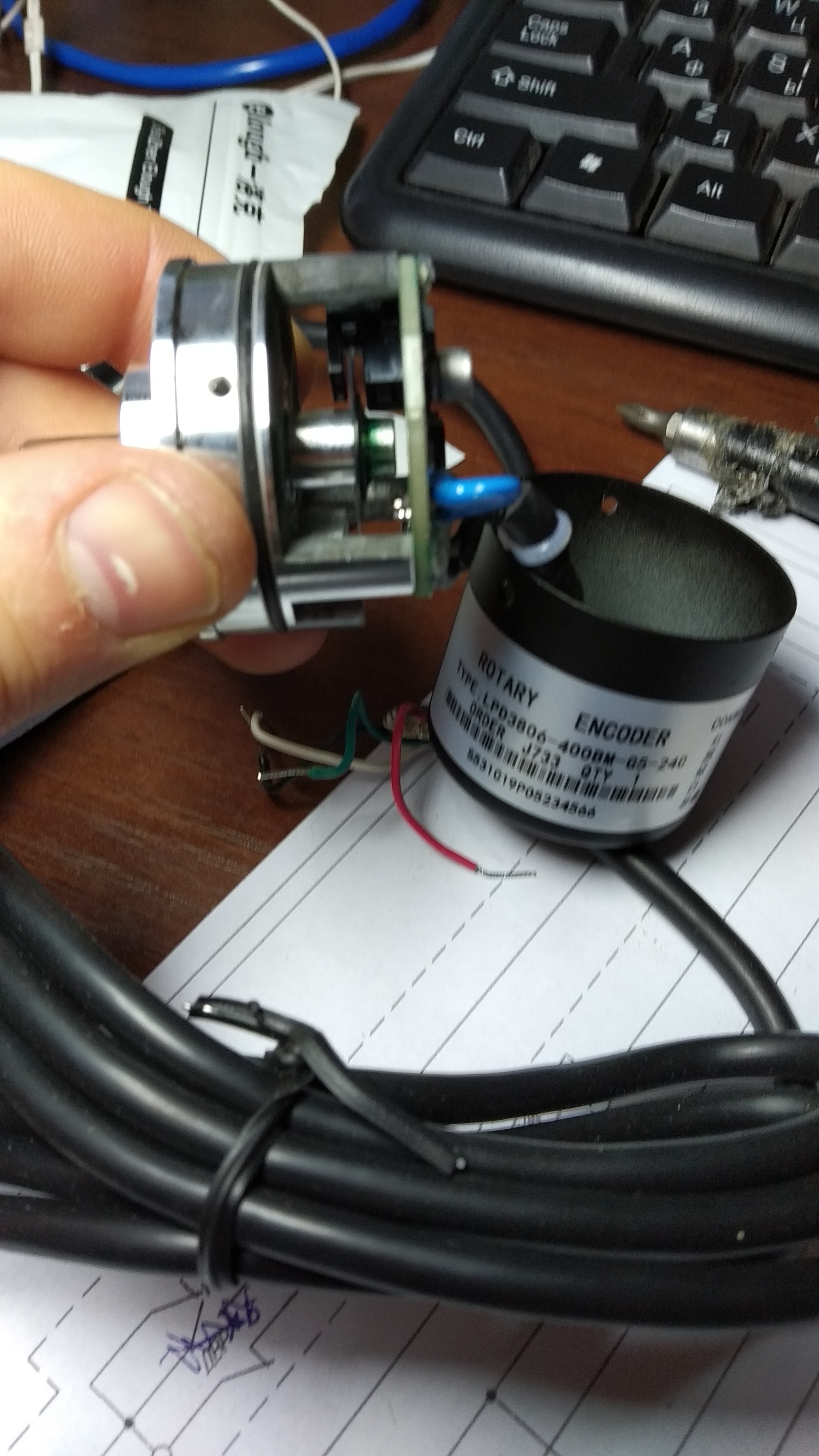

Thanks for the attempt! I appreciate you took out the time, for sure. It helps a bit to get an idea what's in the enclosure, too.

I think I'm grasping it now. The only thing I have to make sure of is to pick the right reader for it. I know they sell kits with just a wheel and a reader which can be mounted as needed. If I can etch the wheel, pick the right reader and then mount it precisely enough, it should work. Well, I hope so at least.
