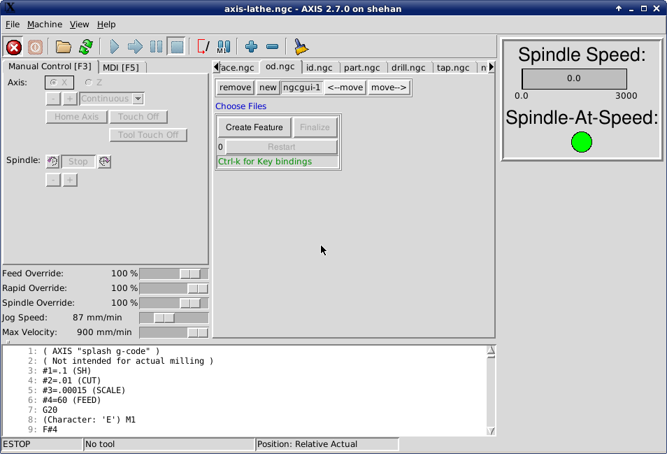

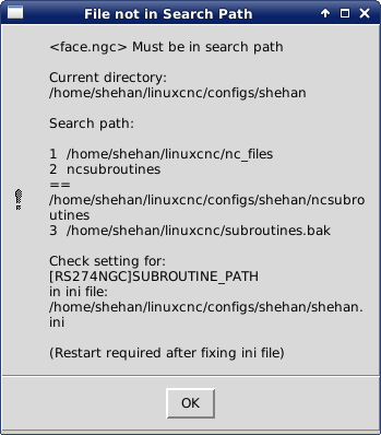

ngc gui not displayed just coming a error message.
what is the problem with coding.
can you debug the case.
this is bigjohnT's ini.file coding on ngcgui[DISPLAY]
EMBED_TAB_NAME = term
EMBED_TAB_COMMAND = xterm -fa console-terminus -fs 8 -geo 120x24 -sb -into {XID} -hold -e date;echo;pwd;echo;ls;echo;bash
TKPKG = Ngcgui 1.0
NGCGUI_FONT = Helvetica -12 normal
NGCGUI_PREAMBLE = std.ngc
NGCGUI_SUBFILE = face.ngc
NGCGUI_SUBFILE = od.ngc
NGCGUI_SUBFILE = id.ngc
NGCGUI_SUBFILE = part.ngc
NGCGUI_SUBFILE = drill.ngc
NGCGUI_SUBFILE = tap.ngc
NGCGUI_SUBFILE = ntp.ngc
NGCGUI_SUBFILE = g76.ngc
NGCGUI_SUBFILE = taper-od.ngc
NGCGUI_SUBFILE = profilerad.ngc
NGCGUI_SUBFILE = radius.ngc
NGCGUI_SUBFILE = ""
what is the highlighted text meaning?
should change in my configuration?

what is the reason?
