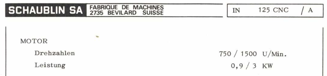

only an info:
this seems to be an 2/4 pol motor instead as thought an 4/6 pol motor:
2 pol 3000 rpm
4 pol 1500 rpm
6 pol 1000 rpm
2 pol 3000 rpm
4 pol 1500 rpm
6 pol 1000 rpm
- RotarySMP
- Posts: 1635
- Thank you received: 595
10 Mar 2021 14:18 #201697
by RotarySMP
Replied by RotarySMP on topic Schaublin 125-CNC retrofit.

hmm,
where is 1:2 transmission to get the 3000 upm at the spindle ?

11 Mar 2021 02:07 #201780
by RotarySMP
Electrically switching from 8 pole to 4 poles on the motor.
Mark
hmm,
Mark
