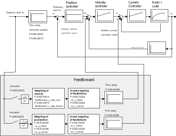

db1981, do you include velocity offset (0x60B1) and torque offset (0x60B2) in the RxPDO when you run an EtherCAT servo in cyclic synchronous positioning mode? These should correspond to velocity and (kindof, with scaling and assuming constant load) acceleration feed forward? If you do, where do you get the values for these (which HAL pins)?

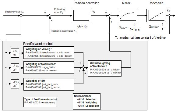

advanced feed-forward control is mostly used in Robotics and HSM Applications. Accleration feed forward is used to minimize the following error which arises through the time constants in our system. the difference between setpoint generation and mechanical reaction. Torque feed forward is an advanced usage to get dynamic and jerk controlled.
But these values are no fix factors, they are dynamically calculated in the task, on systems with high bandwith the biggest problem is to get an accurate velocity feedback.
In upper class industrial controls with 7 phase S-curve jerk controll etc. the trajectory planer, kinematic moduls and axis setpoint generators are merged as one part and acc-ff comes out of the tp because he knows at which time the next big step in velocity change follows. the torque ff mostly is calculated from the kinematics module in conjunction with the tp to do jerk limiting. but all this is done with some kind of look ahead....
to explain this more exactly, i would have to reset my brain to the state of 20 years ago. Today i look on an axis plot and my belly tells me which srew i have to turn....
I have not done this with linuxcnc yet. On the systems i have the need for this, we actually use another system because an s-curve profile and advanced tcp control is needed. (large gantrys 4 meters x 5-xxx meters)
I don't think that torque ff with linuxcnc and its actually tp makes sence. Output the velocity feedforward to the drive could be an big advantage to get rid of ferror in accel and deccel phase on axis with an big stick slip effect. Need to take a look in the pid, perhaps the pins for that exists already, then only the right scalling is neccesary.

The reason I asked is I saw velocity and torque offsets in the EtherCAT drive profile, and I know that, at least with a 7 phase jerk-limited planner, you get instantaneous velocity and acceleration in addition to position, and it seems obvious to feed-forward at least the velocity to the drive then.
I also saw in the documentation that there are pins joint.N.joint−acc−cmd and joint.N.joint−vel−cmd in addition to the joint.N.motor−pos−cmd, and was wondering if they see any use. They are marked "DEBUG", i.e. "subject to removal at any time".

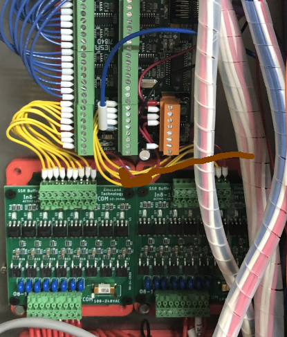

Relays - pneumatic valves - contactors for motors
Wonder if ZincBoy ( Retrofit of a Hitachi-Seike VK45 mill ) would provide details of his solid-state relay Bd.?
