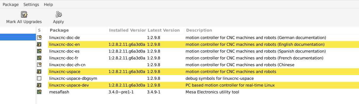

I have now gotten the tool changer working mechanically and electrically tied in with LinuxCNC.
Next step is to set up the carousel comp. Since my lathe is still running 2.8.2, and I never updated it, the version of Carausel.comp will still be the one with the bugs identified here...
www.forum.linuxcnc.org/10-advanced-confi...carousel-toolchanger
I see three options.
1/ patch the carousel I have and recompile it
2/ download the current carousel.comp from github and compile it.
3/ upgrade my full installation from 2.8.2 to 2.9.8, and then the current carousel will already be covered.
linuxcnc.org/docs/html/getting-started/updating-linuxcnc.html
I read the wiki that it is recommended to do a clean install, but I am hestitant to do that with a working system. Wish me luck.

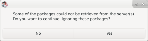

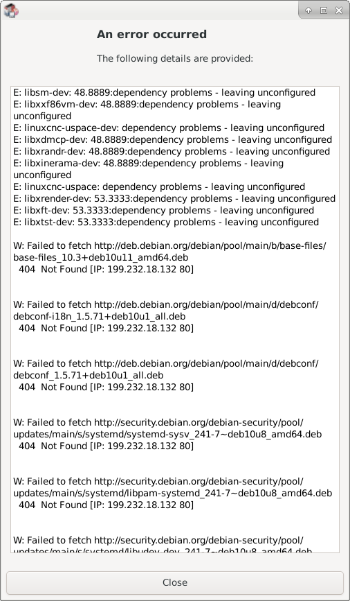

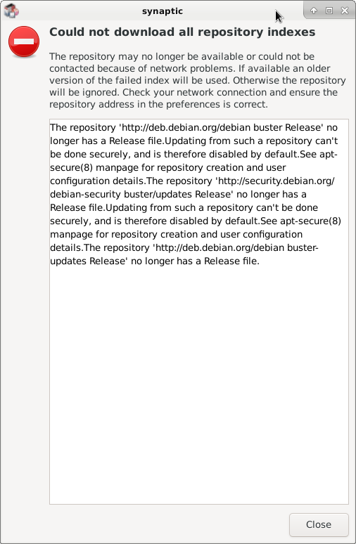

So I checked and my lathe is running Lcnc 2.8.2 on Debian Buster, with RT 4.19.
Since Buster is still okay per the updating instructions, I thought Id try an update.
I added the repository.
but get errors
I attached the full error log.
Does this mean Buster can no longer be updated?
Cheers,
Mark
but get errors
Cheers,
Mark

22 Mar 2026 23:47 #344620
Replied by tommylight on topic Schaublin 125-CNC retrofit.
From google:
Debian 10 "Buster" reached its official End of Life (EOL) and concluded Long Term Support (LTS) on
June 30, 2024. After this date, Debian no longer provides official security updates or bug fixes, making systems vulnerable.
Try this at your own risk.
gist.github.com/ishad0w/6ce1eb569c734880...#gistcomment-5812428
Personally, i will never understand why risk a perfectly working system for absolutely no reason, IF there is nothing you absolutely need/require. I have machines with Ubuntu 8.04 still in daily use. No internet, usually, so...
