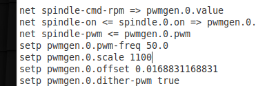

Spindle revs is increasing by one at each rev, and increases continually when running.
Spindle at speed stays false and and spindle index stays at false .
I cant get the true speed to match the speed called for because they stay in ratio so I would seem to need to alter the ratio to bring the two into line .
And Yes G21 is active
19 May 2021 18:52 #209536
Replied by andypugh on topic Threading on a Boxford TCL lathe
spindle.0.index-enable will only be true very briefly. The problem would be if it was staying high.
What drives spindle-at-speed? Note that it only has to indicate "true" to the system, it doesn't actually need to be true.
But, really, you should get the spindle speed to match the requested speed. It's probably just one number to change in the INI (or possibly directly in the HAL)

19 May 2021 22:06 - 19 May 2021 22:17 #209555
by john11668
Replied by john11668 on topic Threading on a Boxford TCL lathe
Last edit: 19 May 2021 22:17 by john11668.
19 May 2021 22:27 #209559
Yes, but it can be made automatic.
Can you think of a way for the system to know which ratio is active? Maybe laser / sensor pairs to tell where the belt is?
(not expensive - www.amazon.co.uk/WayinTop-Photoresistor-...sistor/dp/B07PHFSR2B)
Once the information is in to HAL then you can use a mux component to set the correct pwmgen scale.
i suspect that I will have to change this figure for every belt ratio though.

20 May 2021 10:07 #209632
by john11668
The lathe does not have a back gear , only belts,, but I do find that for most turning operations one belt ratio, along with the Sprint electronic drive unit (which varies the spindle speed quite effectively under pwm control) covers the speeds needed for most turning operations.
A change of belt ratio only therefore becomes necessary for high torque demands like threading.
The TCL is not a sophisticated machine . It is by definition a Training school lathe , and I see it my introduction to lathe CNC. As such it is unlikely to be producing complicated components.
It is probable therefore that I will only need two ratios .
I am guessing therefore that a much simpler piece of code to that outlined in the thread above would suffice for me. My problem is that with my current experience , that piece of code is beyond my capability..
Is it possible that such automatic speed detection will be added to linuxCNC?
Meanwhile I may try to find a single belt ratio which covers my current needs yet still provides enough torque at low speeds to permit threading with lighter cuts . (along with of course a suitable pwmgen scale number)
Thanks for your assistance on this problem so far.

21 May 2021 18:32 #209775
by john11668
Hi Andy and thanks
I have chosen a ratio which gives me speeds of 50 to 2000 rpm and I have found a pwmgen . scale figure which suits this, and gives me pretty close control in the low end of this range . It is nearly spot on at around 300 - 400 revs and does not impede the threading cycle ,
This gets me going for now (until the next snag comes along)
I will bookmark this thread so I can come back the the above links .
Thanks again
