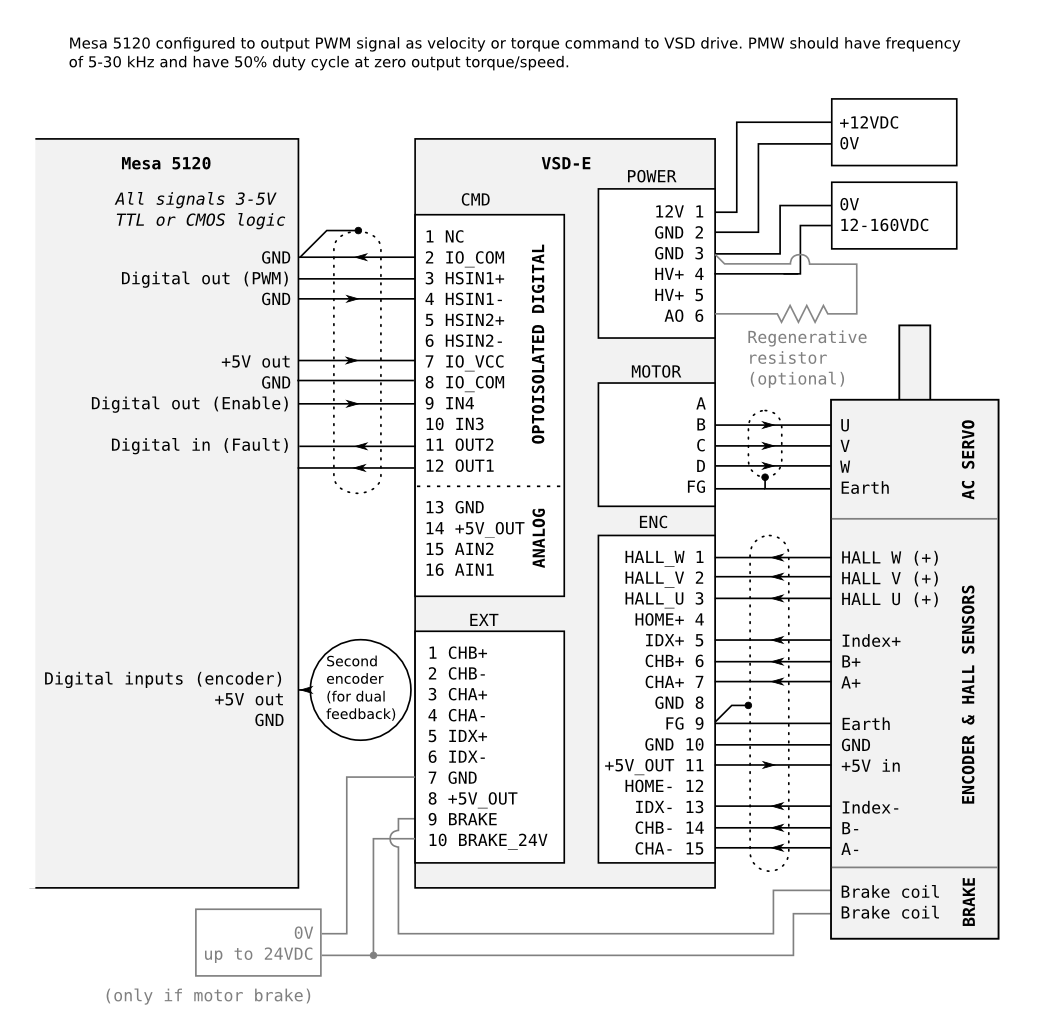

17 Dec 2011 20:48 #15778 by boyzo
Replied by boyzo on topic Re:Mesa 5i20 - All pins at +5V
I need one more clarification. In the attached drawing I have VSD/E connection to 5I20. But I try to connect to 7I52S.
I find that X-axis is controlled by 7I52S P2 COM3. I connected GND to GND, +5V to +5V, 7i52 Pin 3 to VSD/E Pin 3 (PWM), and 7i52 Pin 4 to VSD/E Pin 9 (enable).
Then I use pncconf open loop test trying to run the motor, but the motor did not turn. I noticed that Enable pin from 7I52 is inverted, in the drawing this pin is not inverted.
Is my connection correct? And inverted Enable? If yes, then I need to check VSD/E Granite devices.
17 Dec 2011 21:08 - 17 Dec 2011 21:26 #15779 by PCW
Replied by PCW on topic Re:Mesa 5i20 - All pins at +5V
First I would make use of the fact that the 7I52S has differential PWM
outputs to improve noise immunity (by tying HSIN+ to PWMOUT+ and HSIN- to PWMOUT- or perhaps the reverse to reverse directions)
The Enable signal on the drive is active high so chose the 7I52s enable output thats low at startup (Before even running EMC)
Forgot to say, you also need to enable the outputs (for channel 0 and 3) by setting GPIO 0 and GPIO 23 low
(page 10 in the manual)
