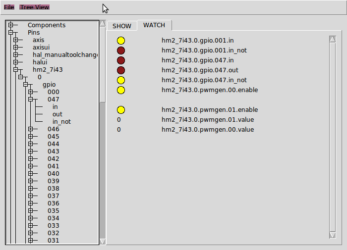

Hi guys, thank you all for your help today. Peter, thank you for the new .BIT file. It did the trick.
Now in trying to get my servo motors to turn I have discovered that my pwmgens are enabled as per the watch list, but my values are locked at zero. I have confirmed this also by my volt meter never moving from 0v as I try to move the X&Y axis of my machine.
So a bit of exploration and some help from you and I see that I need gpio.01 (/ENA0) and gpio.47 (/ENA1) to be be ON (yellow?) in my watch list, but 47 is not yellow. Only 01 is. So I think this is my problem.
It appears these settings or toggles come from the 7i43 card but I'm not sure.
My question to anyone who can answer is this: How do I turn my .047 on? -How is this one enabled?

your mixing up your connections PCW is talking about the 7I49 connections which is pwmgen 00 & 01 enable signals , which are ok i.e yellow as shown . and not the GPIO pins as you were thinking , you also have to remember which port your looking for to
i.e P3 or P4 , confusing is it not ......
thnk we need a new thread rather than Hijack the origional post
