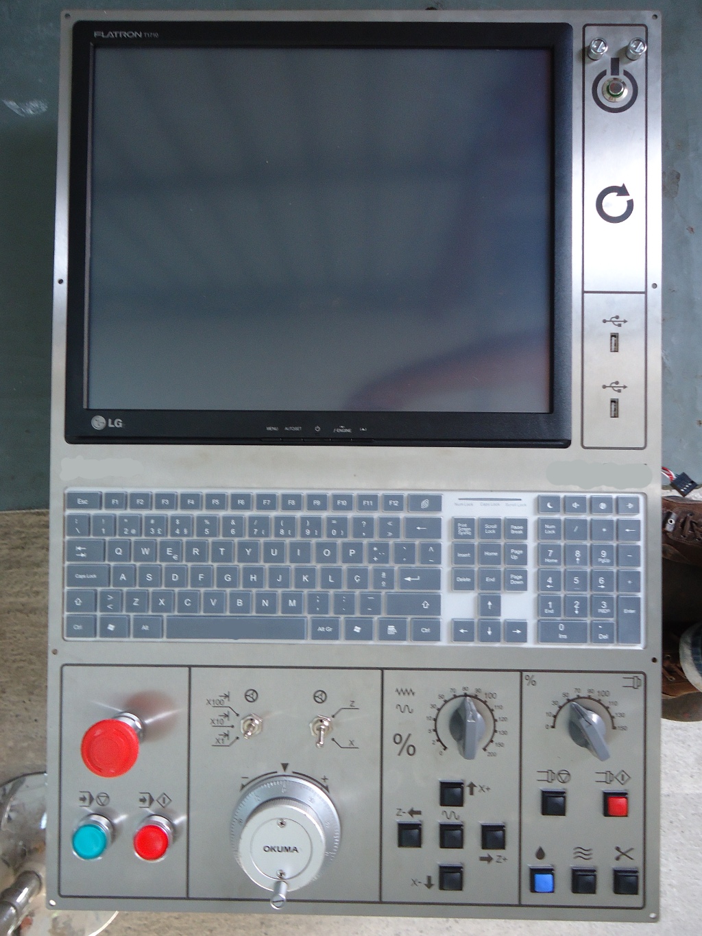

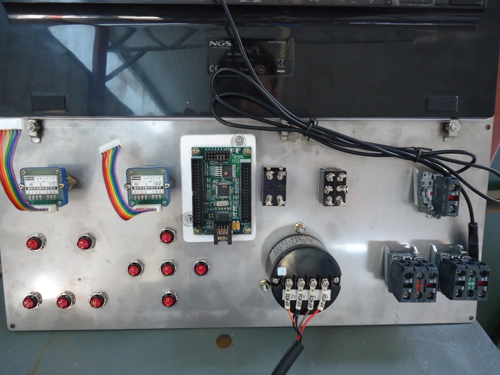

Hi.
I'm currently working on this panel.
The goal is use a mesa 7i73 to control the panel. My question is how can I have access to the mesa 7i73 pins, and how can I address/configure it. I tried use pncconf wizard but has no option to use this daughter board.
at this moment my firs objective is try to enable one output, like turning on a led.
tanks,
João

What sort of switches are the two on the right top of the panel?
- jtc
- Posts: 229
- Thank you received: 13
19 Apr 2013 03:24 #32886
by jtc
Replied by jtc on topic mesa 5i20 + 7i44 +7i73
they are position switches from the old machine. I already reverse engineered one (truth table).

You can probably use "weighted_sum" to decode them:
www.linuxcnc.org/docs/html/man/man9/weighted_sum.9.html
The 7i73 is a complicated little beast, depending on the jumper positions and the selected software mode it can operate in 18 different modes.
I think you want software mode 0, though.
You have a lot of switches there, you might not have enough individual input pins on the 7i73 to have one-pin-per switch. That might mean that it makes sense to wire the switches in a matrix. Don't wire any non-momentary switches that way, though, as matrix wiring only supports 2 buttons being "on" at a time. If you do wire that way, you will need:
www.linuxcnc.org/docs/devel/html/man/man9/matrix_kb.9.html
Which only exists in the development version. (But can, I think, be added to an installed system)
I think what I am saying is, count your switches carefully.

We have 27 inputs on that panel + encoder. I think that we can use at most 24 inputs on the 7i73, but as we also have a 7i37 we will manage it.
Replied by emcPT on topic mesa 5i20 + 7i44 +7i73
I think what I am saying is, count your switches carefully.they are position switches from the old machine. I already reverse engineered one (truth table).

I think it might make sense to set up the 7i73 in 4x4 matrix mode for the momentary buttons. That gives you 16 buttons on 4 input pins (and uses 4 output pins too, but you probably have enough of those)

Note that even though there are 24 inputs available on the 7I73,
inputs 0 through 7 have no pullups or pulldowns so these
would be need to be added if inputs 0 through 7 are used
with switch inputs.
