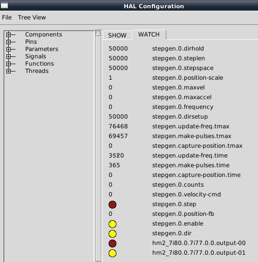

25 Aug 2015 09:21 #61766 by franco_uy
Replied by franco_uy on topic 7i80 and 7i77
Hi guys many thanks for your help
, now I have both cards running OK ...
so I begun to handwrite some hal files to learn... step by step.
some days ago I managed to got succesful encoder readings and position control ok
Then I found the way to add jogging controlled by a wireless joypad.. that was cool !
and tweaked a component to make the response logarithmic..
that was super cool !
now I'm trying to make a stepper work (using a gecko G251) (yes using the 7i77) (because it's the only breakout i have so far..) via the IOs
I already have some io signals scaled down to 3.8V for dir and step so as to drive the G251 inputs
but i'm still not pleased with the results
Motor is moving but I'm having trouble with something because i get some inconsistent behaviour (pulse frequency) on output at different speeds...
i'm not asking for help here (yet :)) because i still have some tests to do to find out where the problem(s) can be... and there's a chance that can be in the electronics (ie my "0" signal level is 0.8V so that might be a reason...)

25 Aug 2015 16:22 - 26 Aug 2015 22:33 #61775 by andypugh
Replied by andypugh on topic 7i80 and 7i77
I guess you used current-limiting resistors for that? The inputs to the G251 are probably opts-isolators, but it sounds like there are internal pull-ups. The manual says
"TERMINAL 10 Step
Connect the STEP line to this terminal.
These terminals can be driven with 3.3V or 5V logic. If 3.3V logic is used then the input current is -1mA for logic “0” and zero for logic “1”. If 5V logic is used then the input current is -1mA for “0” logic and 0.67mA for logic “1”."
So, you might want to test that this is what you see with your wiring scheme.
The problem you will have with using the 7i77 IO for this is that it only updates at 1mS intervals. So, you can send steps at 500Hz. Or 333Hz, or 250Hz... You don't just have limited step rates, you also have rather "granular" step timing.
It is unlikely that a motor will be able to make the jump from 250Hz to 333Hz.
a) I'm too insane to try that schema ? (yes, again with the 7i77 ! haha )
Yes, that is a silly idea. You will have the same problems with limited step rate that you have now, probably more so as the servo drive is likely to be more steps-per-rev
It may be that the internal loop in the servo drive will manage to make a better job of following the speed steps.

26 Aug 2015 19:28 #61810 by franco_uy
Solved the issues related to sofwtare stepgens, I guess I have to return to the point I was originally...
trying to configure the 7i80 to generate steps/dir signals via the FPGA using the 7i77/7i76 firmware. remember ? :)
so. since I already have the 7i80-7i77 boards working ok I wonder (#1) how i can make it work just in the same arrangement but with the dual firmware (2 7i76 - 2 7i77), nevertheless only with the 7i77 breakout attached
(Assuming that's the way i can configure the 7i80 to load the stepgen component)
then I hope i can configure the signaling to link the stepgen outputs to the 7i77 io pins...
I should be able to do that right ? :)
if this is possible, can you help me with this (#1)
