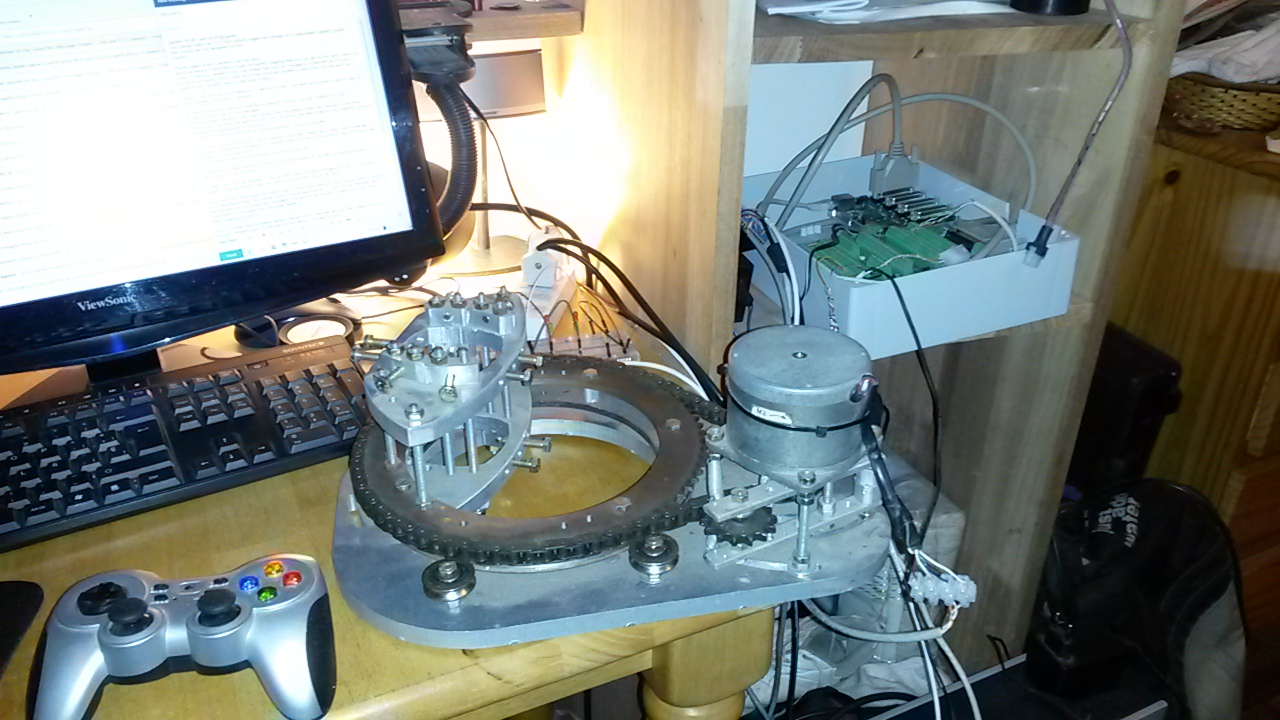

29 Aug 2015 04:22 #61872 by franco_uy
Replied by franco_uy on topic 7i80 and 7i77
Many thanks to all.
I'm learning by testing and doing my first steps.
This sw stepgen signal generation exersises using 7i77 IOs allowed me to test/learn enough for sw stepping for now.
Regtarding the devices I'm testing with
Todd got very very near !
I was tempted to place here the story of this device but would be too long and kinda out of topic, so I let the text in a draft , to publish someday somewhere.. ;)
but here's the pic of the "don't-know-yet-how-to-call-stone-age-rotary-thing" :)
I will test - just because I have the stuff around - the geckos g320 with this same swstepgen...
but inmediately go back to the trail where I left, around proper/wide config of 7i80DB
To continue I have so many questions i don't know where to start. But I'll try to summarize..
1) will order a 7i78 (cause 7i76 seem out of stock) to get the "real" :) stepgens
2) and a 7i87 to get some analog inputs (i guess i will need o to handle the heigth control of a hyperterm powermax 45)
so the question is, if this boards can be presently be handled toghether by my 7i80db (also if I might need any additional cable, etc) - (it's not very simple nor fast process order from here :) - errors/omissions are expensive :) )
so thanks in advance for your comments on the topic
29 Aug 2015 23:53 #61895 by franco_uy
by the way, I designed this device while learning my first steps into Autodesk Inventor.
And the parts (aluminum 1/2 in) were machined with a 3 axis servo, linuxcnc 6i25-7i77 based table.
The device is intended to allow to mount different angle grinders (maybe other similar devices) so you can use it to cut, grind, polish, rectify, level, profile, whatever ...
As many of the tools you can mount on angle grinders need to operate aligned to the path... that's why I asked for ideas on how to synchronize the rotary movement to the tangent of the path (ie X Y axis)
And for the kind of "tool" (if this one, someday qualifies as such ;) ), speed is not a relevant issue as for example is the holding torque, etc.
The idea of this device was based on a video I saw, where there was this device I later foun out that were called aggregate heads
Of course I also dreamed of a worm based slewing drive, but -same as aggregate heads - what i saw
so this is how things are for now
I'm also looking for rotary tables and this could be a first approach too
