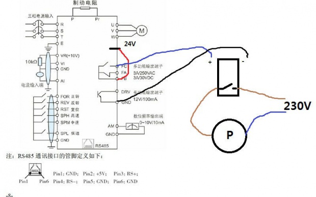

I have my pump wired like the attached drawing. When I power on the machine and the inverter is powered up the pump comes on. Then when the spindle is engaged it turns off. I have the relay wired as no. I feel like the problem is at the inverter wiring but haven't figured it out yet.
- Posts: 19899
27 Sep 2016 12:02 #80986
How much current at 230V does the pump take? It looks like you should be able to run the pump directly through the VFD relay output.
I am pretty sure that you don't want to be using that DRV/GND pair as any part of your circuit.
I would supply 230VAC to the FC terminal, connect he FA terminal to one pump terminal and then connect the other pump terminal to supply neutral. That VFD output is a simple relay.
You may need to configure in the VFD what the relay actually does. I guess you want it on when the spindle is on, rather than an alarm output (for example).
Replied by andypugh on topic 7i77 -> Huanyang

I'm actually running a 24v dc pump using a power supply and relay. I guess my real question is how to set the relay output on the vfd to turn the pump on when linuxcnc engages the spindle......I assume this is the best way...comments welcome on a better way. I read some of the hy manual last night and it looks like you can set it to turn on when the desired freq. is achieved...guess I'll try that next.
