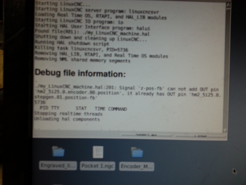

I'm having a problem with the Zaxis drifting in the + direction.. I've tried to figure it out but have come up empty handed so far. I added an encoder to it this evening but when i ran pncconf and configured the encoder input for the Z axis linxucnc will not start giving me this error (see attached pic). Also attached is my config folder for the working configuration (without encoder), i forgot to grab the new config with encoder
. What can i add to my working config so it uses the encoder on the Zaxis? Also does it matter where you ground the encoder? I see TB3 has +5v and GND for encoder but evidently from what i'm told you need at least 7v for this encoder to work so i tied it into my 12v source grounding it there. Will it still function this way?

It is telling you that you are trying to connect two ouput pins to one signal and you cannot do this.
Comment out the line in your hal file that connects the feedback signal to the stepgen output and try again.

I tried that. Linuxcnc starts now but when I try to jog the z axis I get no movement and following error.

Figured out the encoder problem. I neglected to change the jumpers to TTL mode.. still not sure about the stepper not working. I noticed my slave Y axis is not working either.
The z jogs fine in pncconf and the encoder is working.
