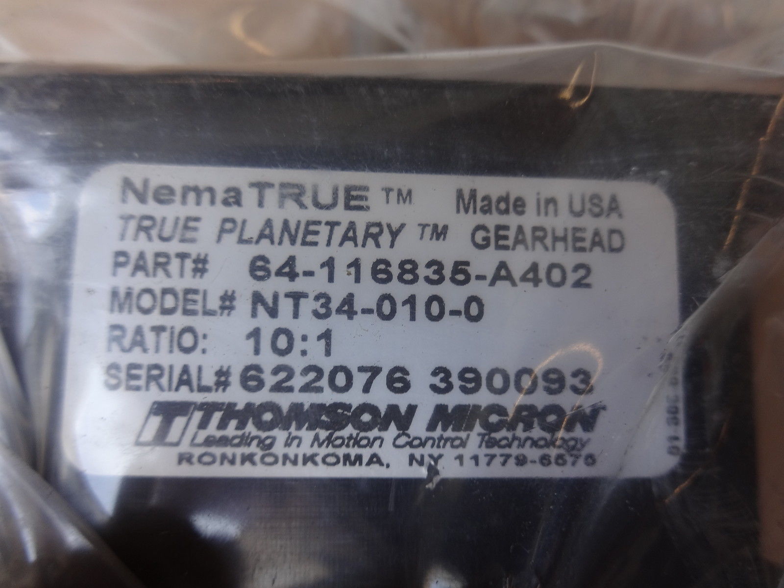

SUCCESS!!!, or at least found a work around.
So guess who ordered a 10:1 gearhead.. I know i'm going to sacrifice a little bit of acceleration and a lot of feedrate but at least it will not drift. From what i can tell i will be able to get about 100in/min with the steppers i have.
The other thing that a gearhead can introduce is backlash in the drive train. What type of gear head did you purchase?

Never fails.. the gearhead i ordered doesn't have the correct bolt spacing for a nema 34 motor.. i thought it was safe to assume that a "NemaTrue" 34 gearhead would fit a nema 34 motor lol.. The other end that bolts to the machine is correct though.. guess i'm gonna have to do some modifications. I only paid $100 for this gear head and from what i can tell i'm not going to find a deal like that ever again if i return it to find something that works out of the box.
