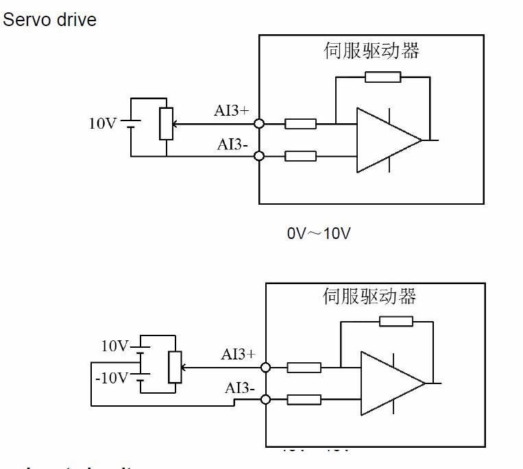

14 Mar 2016 04:35 #71614 by tecno
Yes,
It clearly shows bipolar function for AI3 input, but only 0-10V is possible.
Cheers,
Bengt
14 Mar 2016 05:52 #71620 by andypugh
Replied by andypugh on topic Use 0-10V + dir on 7i77 instead of +-10V out
Yes, it does, doesn't it ?
I assume that you had set Pr1.28 to 3 and that the 0V reference was wired correctly?
14 Mar 2016 05:56 #71621 by tecno
Please clarify what you mean, plus/minus 10VDC does not have any 0V reference.
Trying to test AI3 input with 1.5V battery that I normally do to test ±10VDC drivers with to verify CW/CCW rotation.
14 Mar 2016 06:01 #71622 by andypugh
You can't have any potential _difference_ without a reference.
The wiring diagram near the top of page 16 shows the +/- 10V 0V reference wire connected to AI3-. This is what I am referring to. I am not expecting to find that this isn't how it was wired.
14 Mar 2016 06:11 #71624 by tecno
The top shows how it works today = 0-10VDC
The drawing below shows how to connect plus/minus 10VDC and this does NOT work, rotation only ONE way!
15 Mar 2016 04:56 #71671 by tecno
Got email this morning from the factory, been unable to find their e-mail earlier as the web page is in Chinese and got help to find this.
Hello Sweden
Nice to receive your message.
About the problem you mentioned,I'v talked to our engineer,he said our B2 series drivers can only support 0-10VDC
But,our B series drivers can support -10VDC to +10VDC.
And the price is the same.
Anyhow, the seller is full of shit saying that Lichuan the factory can not deliver/do not have drivers with ±10VDC.
My inquiry from Day1 early september last year even before I placed the order the spec's has been ±10VDC and not 0-10.
So, be aware of this fraudulent behavior from vipwindows168 / Fast To Buy all the same company found on Ebay/Alibaba
I am really pissed and hope that I will finally get my claim via PayPal to be in my favor asking for new drivers to specs.
