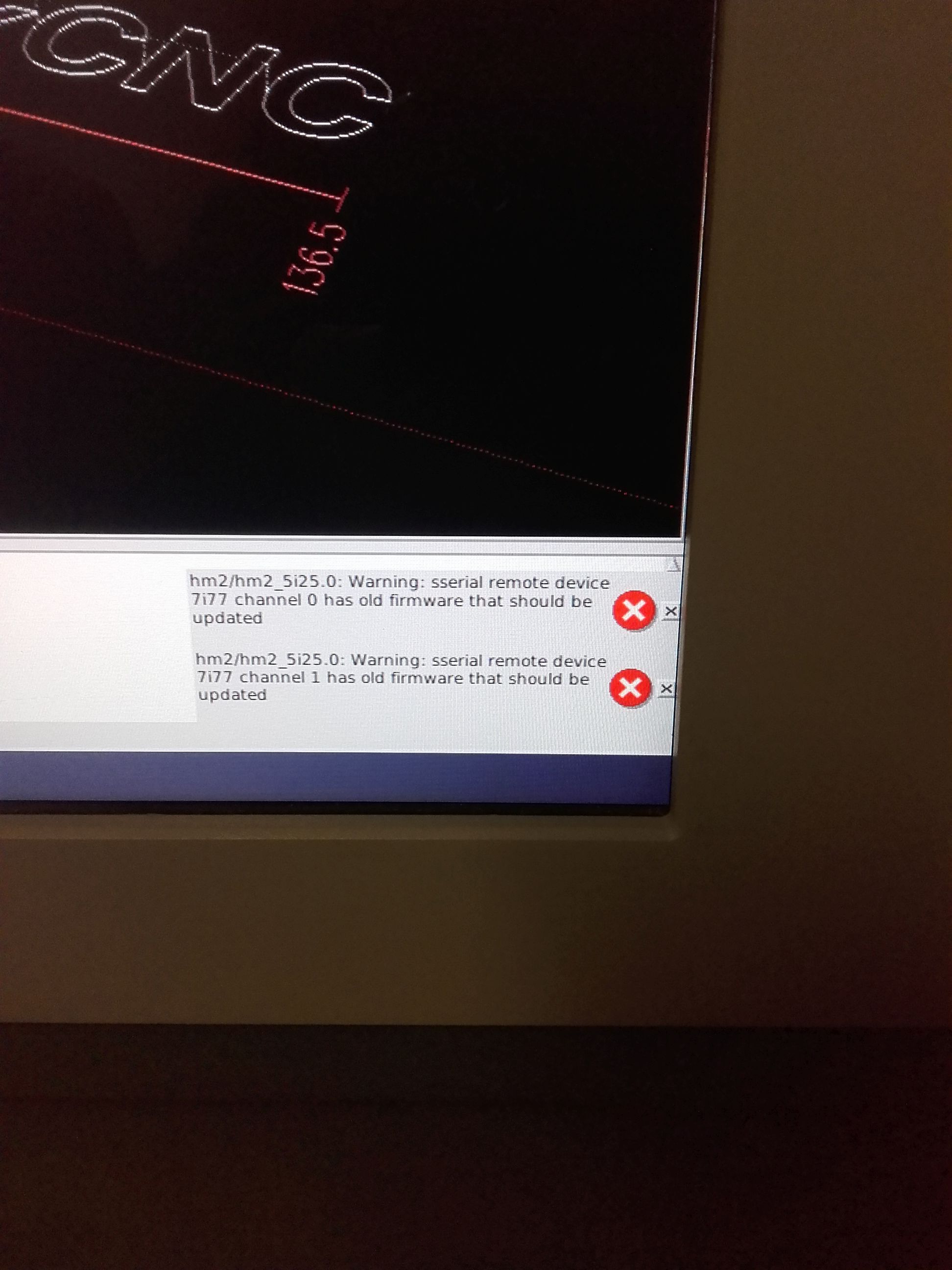

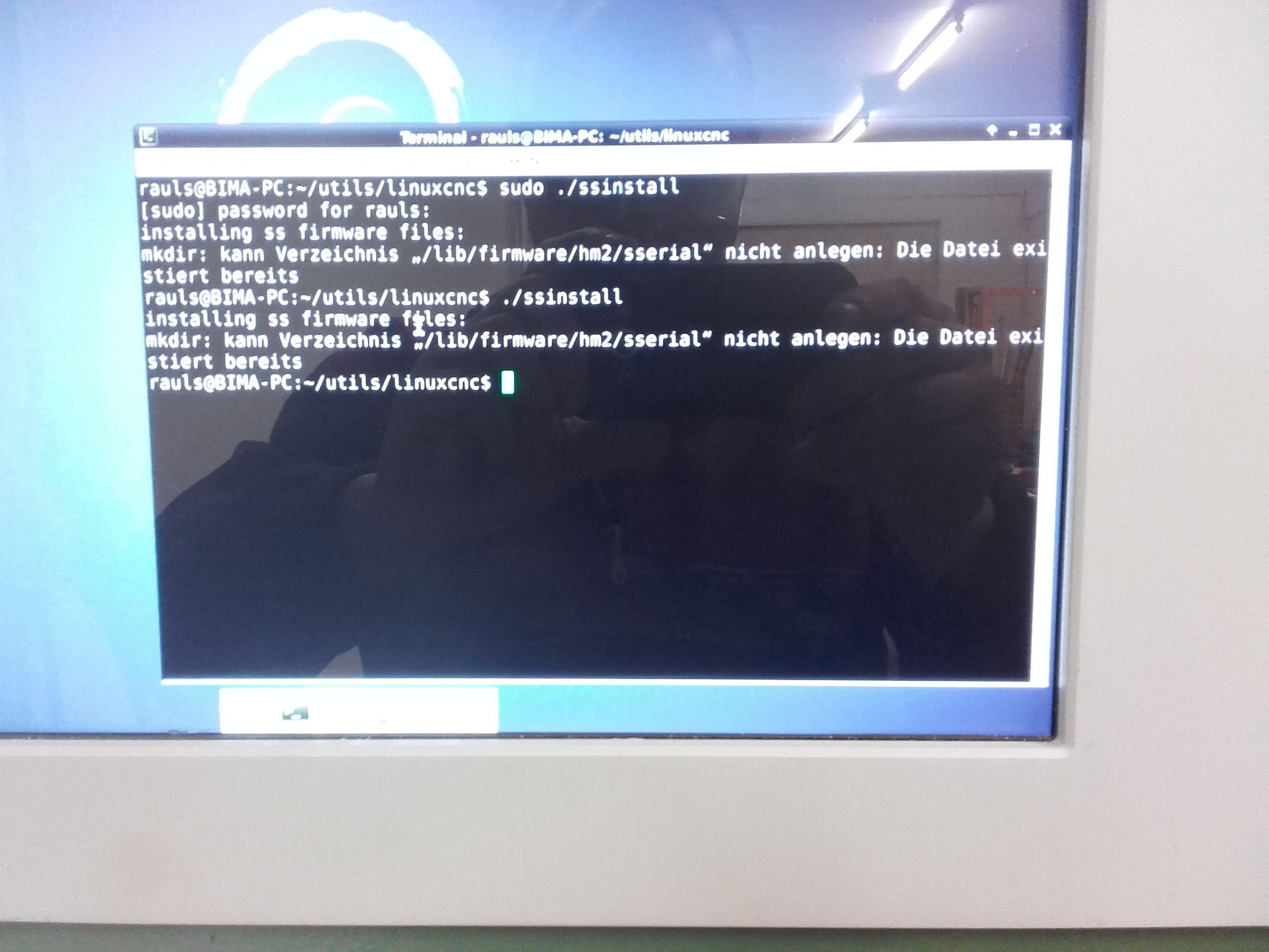

Hello,
my problem will be allways greater. I won't to install the new firmware, after many tests and with help from a friend who knows linux better than i, a update procedure runs, but with an error message. When starts the update oncemore the message is :"newest flash installed". Then I connect the pc to the www it was not better.
But when I start Linuxcnc the message is:"firmware must be updated"
Here is the dmesg and the error-message as and the two files as ipg.
DMESG
I will be very happy when someone can help me
Hans
DMESG
Hans

Replied by Holzwurm56 on topic Where can I get the newest firmware for 5i25 and 7i77?
Hello pcw,
i am very thankful for your interest. You send me this message in a earlier answer, but it was not possible. When type the order:
sudo ./ssinstall i get the message "command not found".
My friend says ssinstall is a normal text-file.
Please see the second code block in my last message.
Hans

Replied by PCW on topic Where can I get the newest firmware for 5i25 and 7i77?
That's expected and harmless
(it just means that you have already run ssinstall )
Because you did not complete the firmware upgrade
( you did not successfully run update7i77 )

Hello pcw,
in what kind of way can i complete the update. The procedure is abort. You see this in the picture.
Hans

- Posts: 18116
- Thank you received: 5335
17 Jan 2017 17:02 - 17 Jan 2017 17:05 #85957
by typing
./update7i77
in the utils/linuxcnc directory
(without linuxcnc running)
You must also follow the instructions about moving the jumpers and power cycling
both the 5V and field power on the 7I77 or the update will fail
./update7i77
