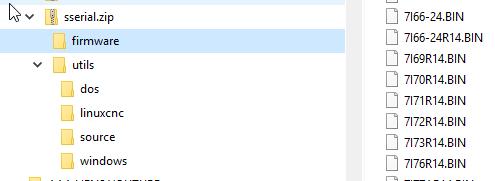

Hello,
I just made an update of an old 7i69 successfully
but in the procedure ./ssinstall :
/ lib / firmware / hm2 / sserial folder is well created but no files (files.bin) is copy in folder sserial?
it is necessary to copy (by hand under sudo) all files in the folder. It is normal?

did you
sudo ./ssinstall
Edit:
the (very minimal) script does the sudo:
echo installing ss firmware files:
sudo mkdir /lib/firmware/hm2/sserial
sudo cp *.BIN /lib/firmware/hm2/sserial/
but must be run from the directory with the .BIN files
sudo ./ssinstall
Edit:
Last edit: 12 Dec 2019 14:58 by PCW.

yes it creates the sserial folder but it is empty !
the files.bin are not transferred

Yes, but in this script,
from sserial.zip,
I can not be at the same time in the directory: / sserial / utils / linuxcnc / to run ssinstall
and in the directory: / sserial / firmware/ files.bit
from sserial.zip,

In the sserial.zip that I just downloaded, the ssinstal utility is in the same
directory as all the .BIN files
