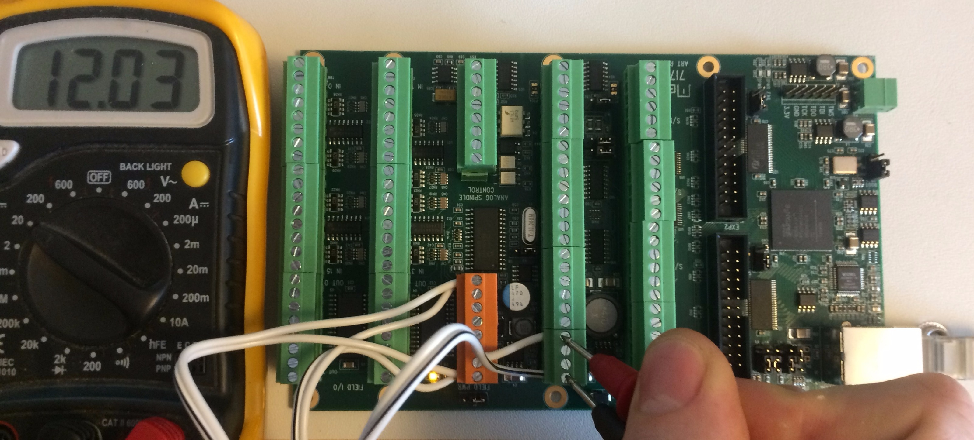

01 Apr 2017 11:22 #90689 by PCW
Replied by PCW on topic Problems with 7i76e setup
If you cannot run the 7I76E from correct TB3 power, you have a bad or damaged 7I76E
01 Apr 2017 12:38 #90695 by deawe
Replied by deawe on topic Problems with 7i76e setup
Okay.
To conclude this I have attached a photo of the board powered through the TB3 terminal. The field power LED is lit and visible through the leads, but the logic power LED does not turn on. I guess we can agree then that the board is faulty? And for reference, the board is resting on an ESD mat, and have been so ever since I took it out of the bag it was delivered in.

01 Apr 2017 13:34 #90700 by tommylight
Replied by tommylight on topic Problems with 7i76e setup
Just to be sure, is the jumper for Vin and Vfield set to correct position?
01 Apr 2017 14:08 #90703 by deawe
Yes.
According to the 7i76e manual: "If you wish to use a single power supply for the 7I76Es field outputs and field logic power, W1 should be placed in the left hand position. This connects field power to VIN." It's possible to make out the position of the jumper below the yellow TB1 connector in the photo I attached. The jumper positions in the manual refer to the board oriented with the RJ-45 connector on the left-hand side, so the photo has to be rotated 180 degrees to correspond to that.
In any case, I would not think that the field power jumper would affect the supply to the logic section of the card.
01 Apr 2017 14:11 - 01 Apr 2017 14:12 #90704 by PCW
So it looks like a bad or damaged card, You should request a RMA number from Mesa
with the order number and description of problem and the card can be returned for repair/replacement
Last edit: 01 Apr 2017 14:12 by PCW.

01 Apr 2017 15:18 #90708 by deawe
I purchased the card from EUSurplus, so I'll take it up with them.
rodw, thanks for the wiring diagram, that is very helpful! I have been looking for something similar, but my searches turned up empty. Do you happen to remember in which thread this was posted? It would be interesting to see a little bit more about it.
Thanks to you all for the prompt and valuable support!

01 Apr 2017 16:27 #90714 by deawe
If you follow the discussion, you see why I did not have 5V connected to the P3 connector near the RJ-45 jack.
The card should certainly work without 5V on that connector. The following from the manual:
The 7I76E can get its 5V Ethernet, encoder, step/dir and serial interface power from
connector P3 or the on card logic power regulator can be used with unregulated DC power
supplied to TB3
In the photo, I supplied power to TB3 instead.
And also a few posts back:
