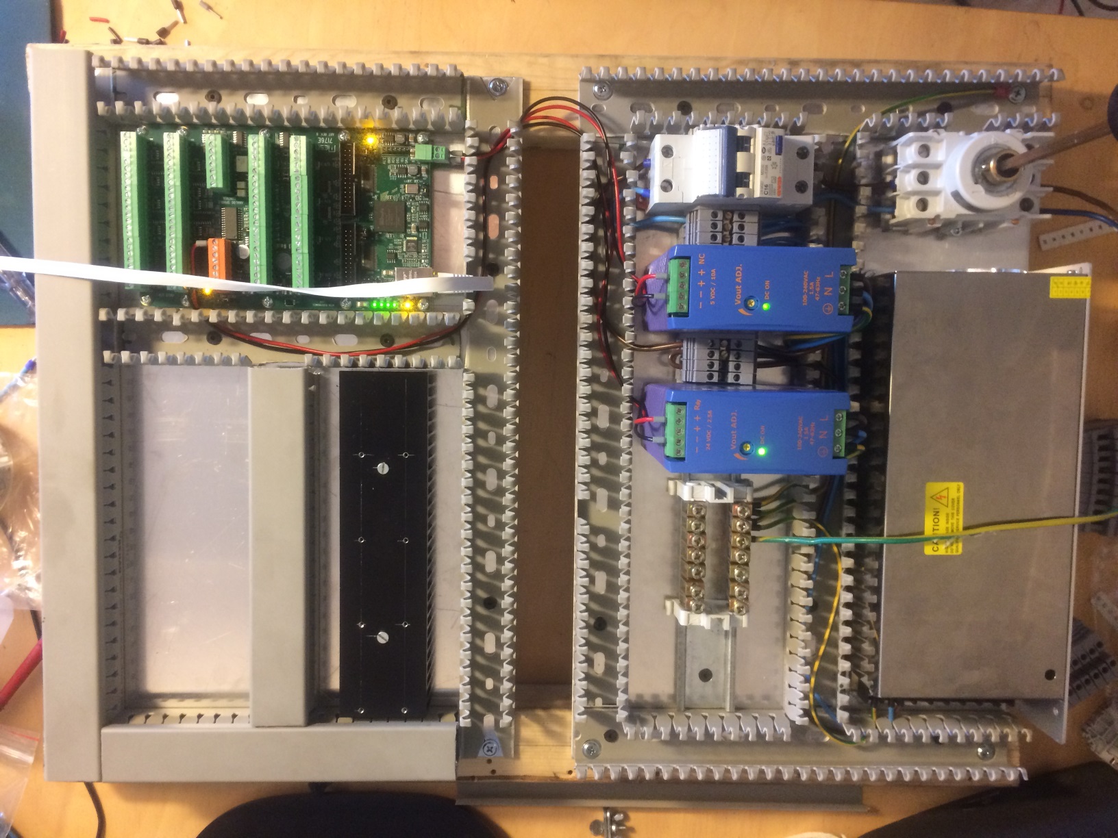

I bring up this old thread only to inform you about the conclusions, or rather the current situation.
When making a claim to EUsurplus, they told me it's better to deal directly with Mesa, which I did. I sent in the card for investigation/repair, and Mesa informed that there were signs of over or reverse voltage, but accepted to replace the card anyway. I am quite confident that I have not supplied over or reverse power to the card and that the card was in that condition when I got it. But of course it's difficult to be 100% sure.
In any case, I got the new 7i76e card from Mesa, and hooked it up tonight. This time I took precautions and hooked up a digital storage oscilloscope to measure and see the transient power-on voltage. Nothing strange there, and the card appears to be working without problems. I have yet to hook it up to the stepper drivers, but now the DIR output is changing polarity as expected, and the field outputs work.
Below a photo of the current setup, in case somebody is interested. Still quite a lot to do before the electrical side is completed.
And a last thanks to all the support you and Mesa gave! It's not a long way to go anymore to a working CNC mill

Replied by tommylight on topic Problems with 7i76e setup
Side note, do not use that flat cable for communication, i have one, it does a lot of droped packets. Use UTP or even beter STP CAT 6 cable.
UTP = unshielded twisted pair
STP = shielded twisted pair
Key word there : twisted pair
Flat cable = no twisted anything and most probably no shielding.
Yours might just be good good, mine is not by any stretch although it looks niceeeee.

You, sir, have a keen eye! As you are suggesting, I do not intend to use that ethernet cable in the final setup. Right now, when doing most of the wiring and testing, this was what I found with a somewhat suitable length.
In any case, thanks for pointing that out!
