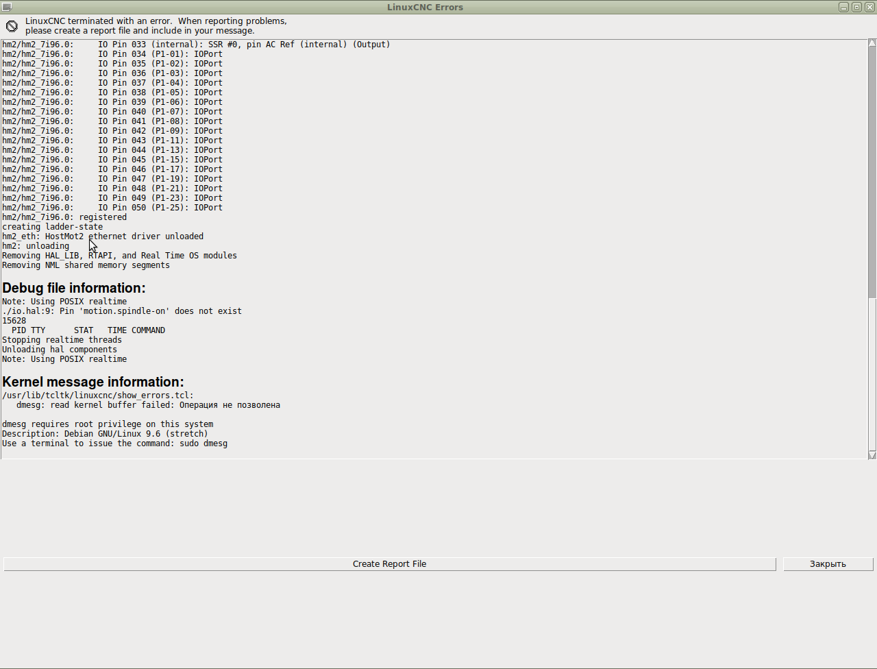

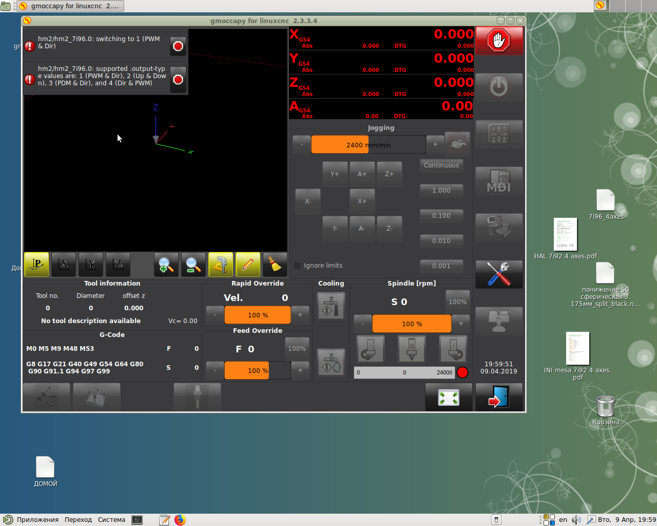

11 Apr 2019 14:27 - 11 Apr 2019 14:33 #130664
by hottabich
Replied by hottabich on topic Mesa 7i96 Ethernet board
Hello! Help configure the Spindle and Output section (spindle on) in the 7i96 Configuration Tool. Firmware 4 Step Gens and PWM. Spindle open loop 2.2kw. 400Hz.-24000Rpm. If you can correct my files. Thank!

11 Apr 2019 14:40 #130665
Replied by PCW on topic Mesa 7i96 Ethernet board
Recent versions of master support multiple spindles so the spindle related pin names have changed, I believe what you want is:
spindle.0.on
("man motion" for all the new names)
spindle.0.on

11 Apr 2019 15:08 #130669
by hottabich
I use the last master. I want the LED on the corresponding spindle to start up when the spindle starts up, as for a spindle cooling pump. What do I need to fix for this and where?
- hottabich
- Posts: 574
- Thank you received: 96
11 Apr 2019 18:39 #130682
by hottabich
Thanks for the hint! Understood, should be removed in io.hal before spindle.0.on motion. and one error disappeared as well in the linux_mesa7i96.hal section of the Spindle line setp hm2_7i96.0.pwmgen.00.output-type 0 instead of 0 is one of (1,2,3,4). Thank you so much! Everything worked as desired.
