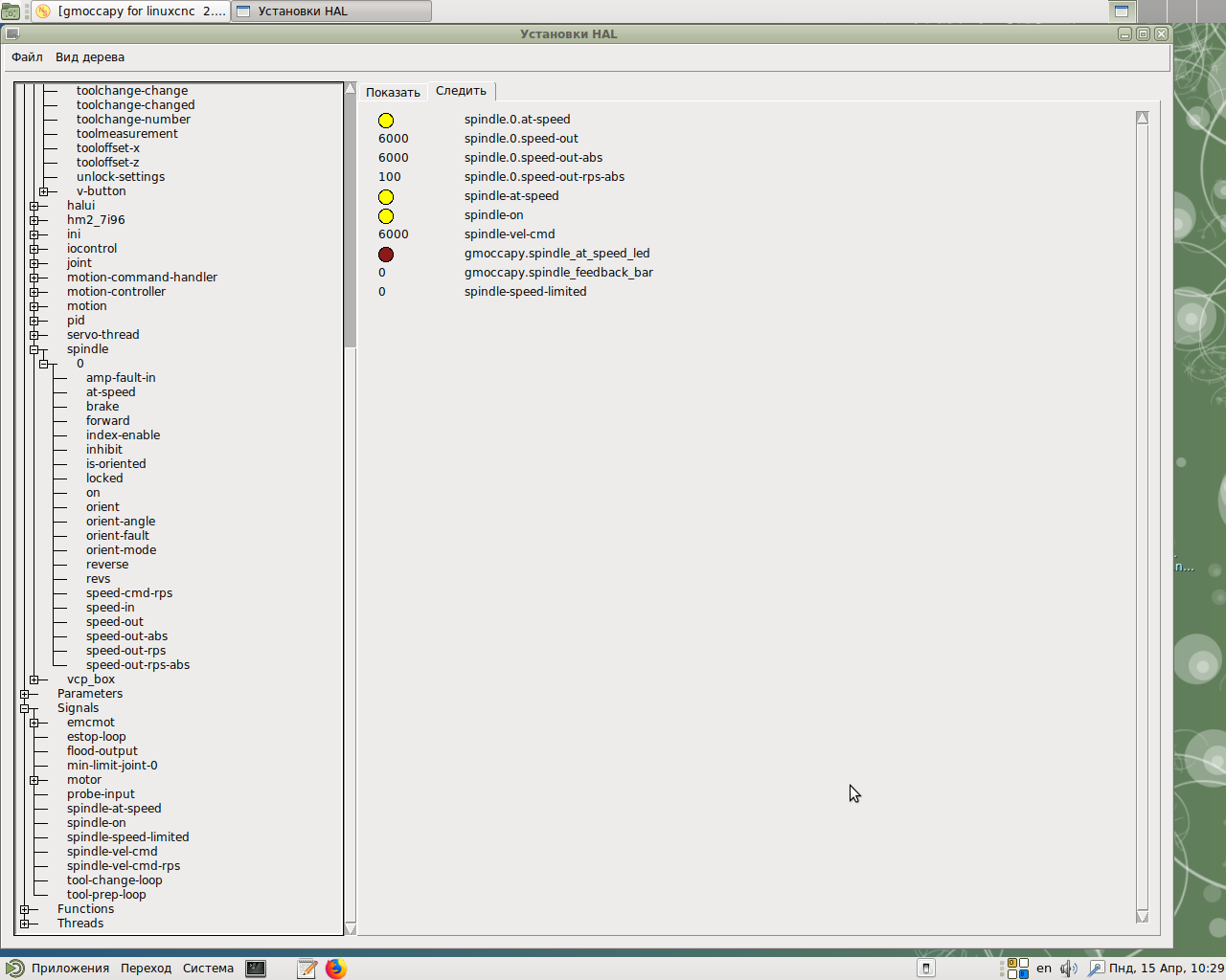

Hello! Please help me in the Gemoccapy Interface to connect gmoccapy. spindle_feedback_bar and gmoccapy.spindle_at_speed_led. How to register in postgui.hal.

Replied by pl7i92 on topic Mesa 7i96 Ethernet board
there shoudt already be a NET Spindle-at speed
look into the HAL of the mashine
then in postgui simple use this net
net spindle-at-speed gmoccapy.spindle_at_speed_led
if not you can use the pin of the spindle
net led spindle.0.at-speed gmoccapy.spindle_at_speed_led
you can use HAL SHOW to see if you got thise pins alredy connect so you dont run into error

I write "net spindle-vel-cmd => gmoccapy.spindle_feedback_bar" in postgui.hal - and get error "Pin gmoccapy.spindle_feedback_bar doesn't exists". When the Halshow command run, everything works. With gmoccapy.spindle_at_speed_led is similar. How I should register that command? I do not understand how it can work with halcmd, but doesn't work when I put same command in postgui.hal.

Is the postgui.hal file called as a POSTGUI file in the INI, or as an ordinary one?

You have
You need
linuxcnc.org/docs/2.7/html/config/ini-config.html#_hal_section
[HAL]
HALFILE = linux_mesa7i96.hal
HALFILE = io.hal
HALFILE = custom.hal
HALFILE = postgui.hal
HALUI = haluiYou need
[HAL]
HALFILE = io.hal
POSTGUI_HALFILE = postgui.hal
HALUI = haluilinuxcnc.org/docs/2.7/html/config/ini-config.html#_hal_section

Thank you so much! I am 66 years old and without knowledge of English was lost in the beaten information. Linux newbie. Thanks again to you and the whole community for your not easy work!
