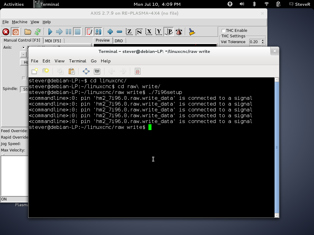

so I think I finally understand this. LOL after I wrote and ran each data number and grafted it. I have connected machine on to 0 and spindle on to 1. and commented out the rest. the sum number is correct. but I now cannot run the 7i96setup while axis is on. It says ( pin 'hm2_7i96.0.raw.write_data' is connected to a signal ) I understand that is, but how do I get around it? I also have it as a M100 and tried running it that way but no luck.

11 Jul 2017 13:31 #95658
Replied by PCW on topic Mesa 7i96 Ethernet board
You would need to add the net command that connects hm2_7i96.0.raw.write_data
to the end of the setup command and remove it from the hal file

19 Jul 2017 15:52 - 19 Jul 2017 15:53 #96082
Replied by andypugh on topic Mesa 7i96 Ethernet board
I think a complication here is that the data and strobes are only sent once every mS in the servo thread.
The answer might be a custom HAL component like this (untested)

- Posts: 18103
- Thank you received: 5326
19 Jul 2017 16:05 #96087
The script does work
I did find that i needed to continue to generate edges on the write strobe
I used a siggen at 500 Hz for this
