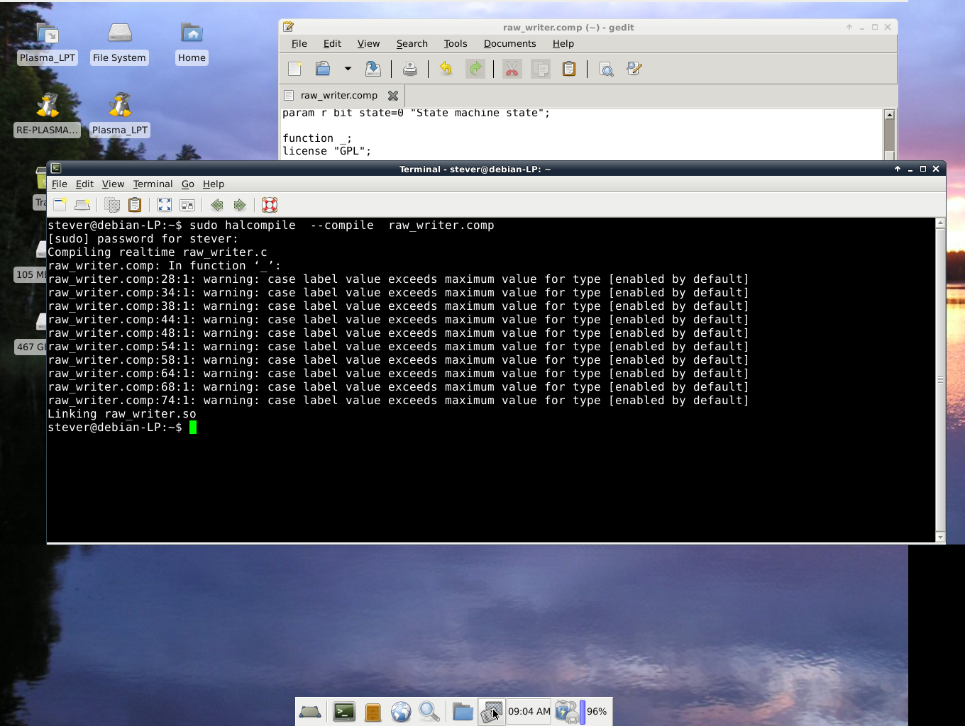

20 Jul 2017 03:34 #96120
by microsprintbuilder
Replied by microsprintbuilder on topic Mesa 7i96 Ethernet board
20 Jul 2017 08:47 #96127
Replied by andypugh on topic Mesa 7i96 Ethernet board
No, that's a failed compile. (I wrote that .comp in my break at work some miles from any LinuxCNC machine).
The error is mine, there needs to be a ";" at the end of the line that starts "pin in bin in[6]...."
(Compiler error messages often turn up a few lines later, and sometimes a few files later, at the point where the compiler really can't make sense of it any more)

20 Jul 2017 13:13 #96140
I have found that if i try to compile just in my file i get the errors. I have been able to correct a few but now I've hit one i cannot. I googled this error and have not found a solution.
this is what I have so far

20 Jul 2017 13:25 #96143
My fault again. Sorry
param r bit state=0 "State machine state";
Needs to be
param r unsigned state=0 "State machine state";

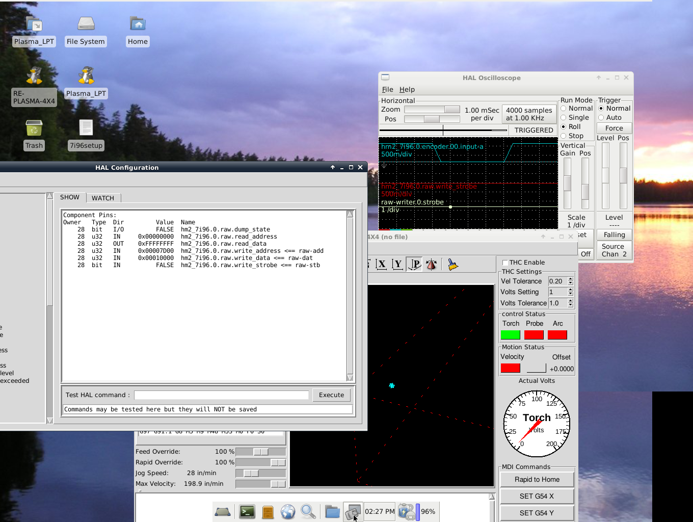

20 Jul 2017 17:15 #96153
If you check in Halscope do you see the strobe pin toggling?
Does the data pin show changing values?
Is the address pin correct?
Have you actually connected the pins in HAL?

20 Jul 2017 17:25 #96154
I have connected the pins to the board. as you can see in the show hal screenshot the address is the same in the comp and board..I can watch it changing from state 10 to 20. and I can also see the strobe go on and off. I'll check the halscope and get back to you.

20 Jul 2017 18:40 - 20 Jul 2017 19:08 #96161
strobe doesnt seem to be strobing. I got nothing on the scope. I added the encoder for the thc to see something moving. I've attaced my hal files for you to look at.
