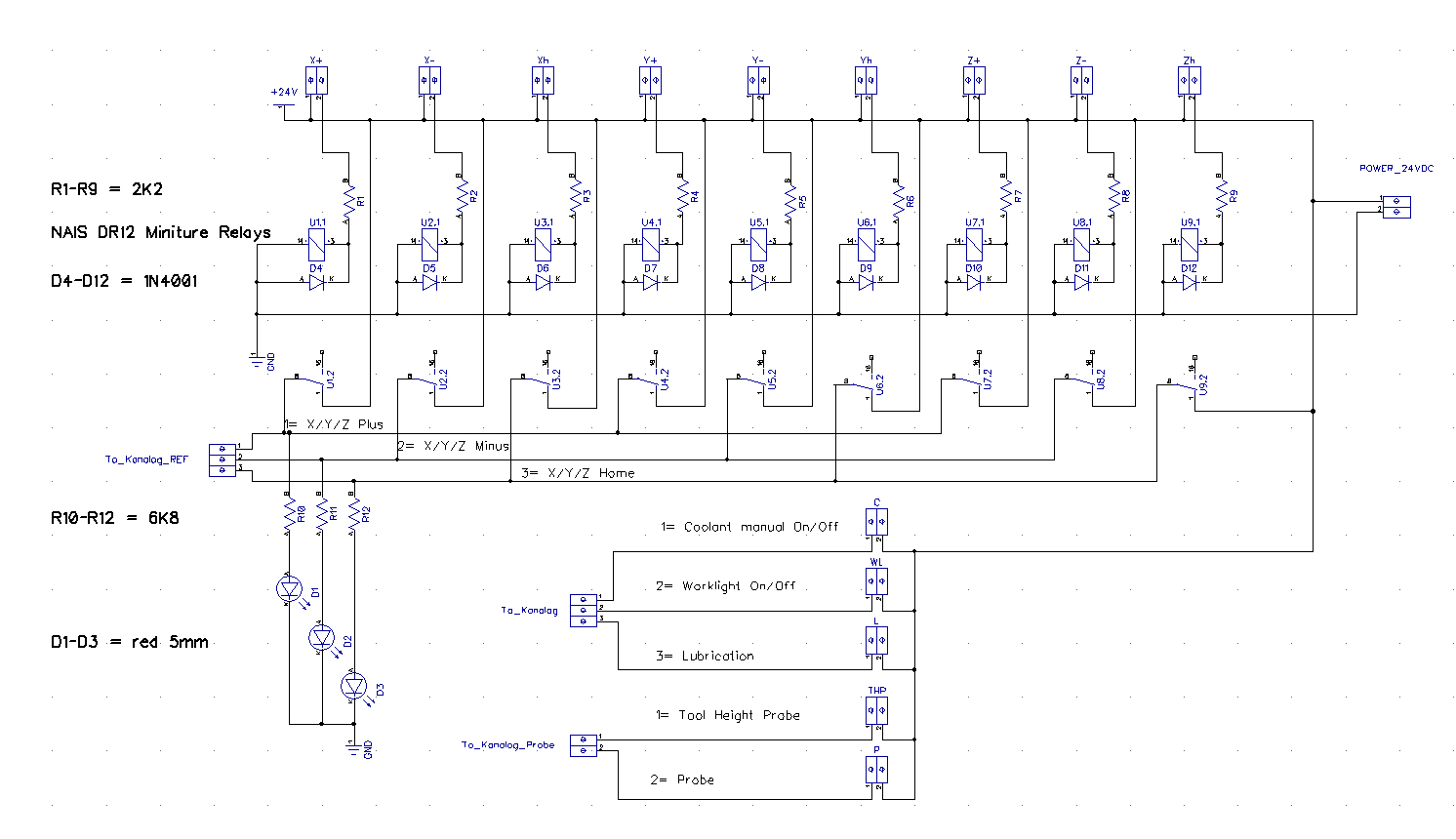

How hard would it be to change the switches?
Though the OEM thought that NO was OK, and presumably knew what they were doing.
Replied by andypugh on topic 7i73 questions
Any thoughts about having the limits/home switches NO as I would like to take out the relay-board
this just for clean install that is easy to get a overall view of.
- tecno
- Posts: 1850
- Thank you received: 127
31 May 2017 12:57 #93881
by tecno
Replied by tecno on topic 7i73 questions
- Posts: 19902
31 May 2017 13:02 #93882
I can't help feeling that the conversion relay board adds more possible failure modes than just keeping the NO switches.
- tecno
- Posts: 1850
31 May 2017 13:03 #93883
by tecno
I agree even if NO is a bit backwards.
- tecno
- Posts: 1850

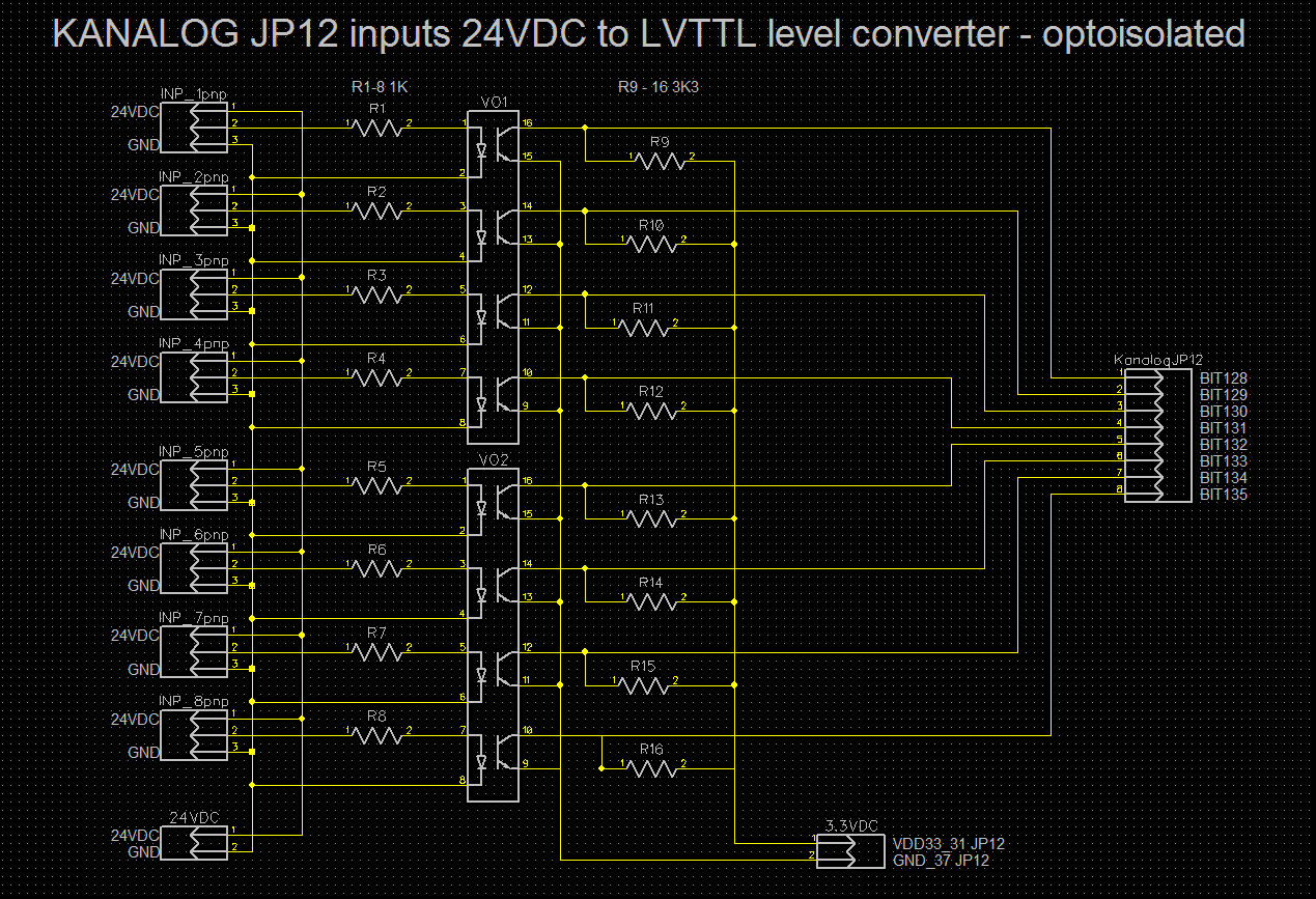

07 Jun 2017 18:02 - 07 Jun 2017 18:03 #94254
by tecno
Been away for a few days on short holiday.
Have made up following list for connecting I/O to 7i73 in the controlbox.
Is this somewhat correctly connected?
Want to use 24VDC on Limit/Home swithes and convert these signals to 3.3VDC
My order is now shipped from Mesa and hopefully here by the end of next week.
Last edit: 07 Jun 2017 18:03 by tecno.
- Posts: 19902
07 Jun 2017 18:51 #94259
It might be easier to use an opto-isolator.
Something like se.rs-online.com/web/p/optocouplers/4530909/
But I would suggest seeing if PCW can suggest an optimal output-type for it.
