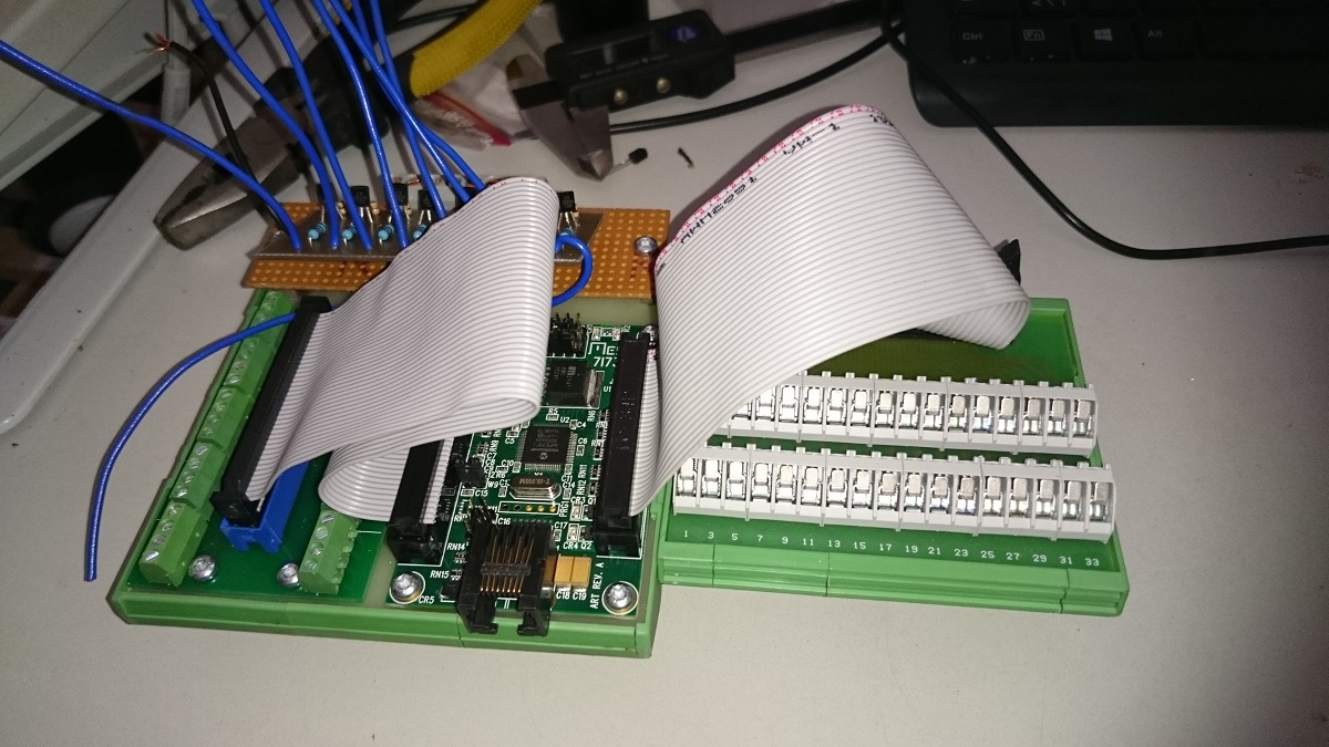

Yes that is a good candidate too if it works OK with 3.3V level. Will setup simulation and see what I can find out.
BC547A will certainly do the trick as well.
- Posts: 19902
12 Jun 2017 13:19 #94427
The 2803A should:
"The ULN2803A is comprised of eight high voltage, high current NPN Darlington transistor pairs. All units feature
a common emitter and open collector outputs. To maximize their effectiveness, these units contain suppression
diodes for inductive loads. The ULN2803A has a series base resistor to each Darlington pair, thus allowing
operation directly with TTL or CMOS operating at supply voltages of 5 V or 3.3 V. "
Replied by andypugh on topic 7i73 questions
The 2803A should:

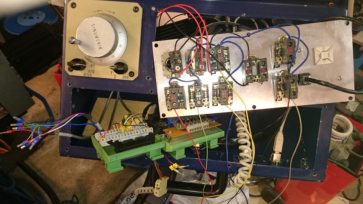

Having second thoughts about home/limit switch voltage. I have always had 24VDC on my switches but is there anything against using 3.3/5V on the limit/home switches? (would make life a bit easier
Cheers
Bengt
Cheers
Bengt
- Todd Zuercher
- Posts: 4793
- Thank you received: 1480
16 Jun 2017 14:50 #94582
Replied by Todd Zuercher on topic 7i73 questions
They can be more susceptible to noise, and long wire runs will have more voltage drop issues. That said, I use 5v on a lot of limit switches without problem (10 meter wire runs).
- tecno
- Posts: 1850
- Thank you received: 127
16 Jun 2017 16:22 #94596
by tecno
Replied by tecno on topic 7i73 questions
Hi Todd,
that is why I used to run 24VDC, but my cables are within 5-6m so 5VDC should be OK.
I will try to run with 5VDC and see if I get in trouble.
Cheers
