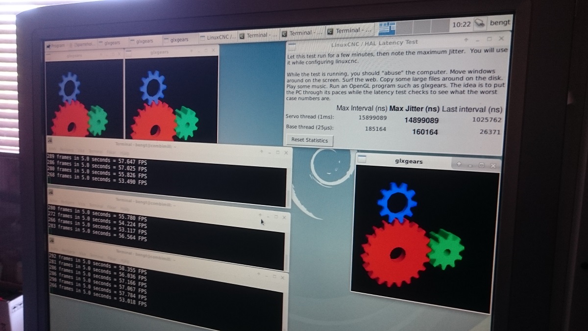

22 Jul 2017 09:40 - 22 Jul 2017 09:45 #96270
by tecno
Replied by tecno on topic Latency to run 7i76E
Last edit: 22 Jul 2017 09:45 by tecno.

22 Jul 2017 10:11 #96272
Replied by rodw on topic Latency to run 7i76E
Ouch!
This is what I'm using with Linux Mint 18.3.
www.gigabyte.com/Mini-PcBarebone/GB-BXBT-1900-rev-10#ov
Latency for a few minutes while writing this.....
I've also got the same PC in a N3160 which is the next iteration of the J1900 chipset and it works fine.
PCW linked to a Zotac Dual NIC PC which I could not source in Australia. if i bought another PC, I would probably get a dual NIC J1900 one like this on aliexpress This looks suspiciously like the one CandCNC's Command CNC uses (which is LinuxCNC based)
Remember it is mandatory to discard the internal Wifi cards and use a USB wifi dongle. If you don't your latency will worse than what you have now.

22 Jul 2017 12:24 #96278
Before you give up.
Have you tried any thing to improve the latency of the PC you have? Turning off power saving in the bios, hyperthreading, C states...
Have you tried different settings for ISOLCPUS? What MB do you have now?
Replied by Todd Zuercher on topic Latency to run 7i76E
OK, that means my PC:s are waaaaaaaaaaaaaaaaaaaaaaaaaaaaaaaaay to slow or ??
Have to find new MOBO's that fit mini-ITX or close to that size as I have lack of space.
Any suggestions to what to buy?
Before you give up.

- Posts: 18103
- Thank you received: 5326
22 Jul 2017 12:45 #96281
Replied by PCW on topic Latency to run 7i76E
Also you need to run the latency test with the base thread disabled
(your latency numbers are meaningless since you have a base thread running faster than the CPU can service it)
For the latency test run:
latency-test 1ms 1ms
For the latency histogram, run:
latency-histogram --nobase
