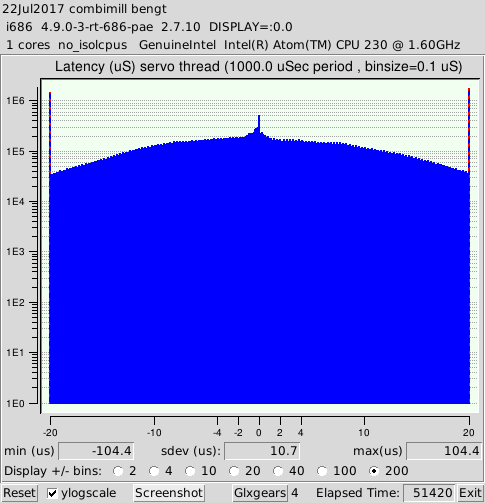

22 Jul 2017 13:00 - 22 Jul 2017 13:52 #96283
by tecno
Replied by tecno on topic Latency to run 7i76E
Last edit: 22 Jul 2017 13:52 by tecno. Reason: added data
- Posts: 18111
- Thank you received: 5330
22 Jul 2017 13:57 #96284
Replied by PCW on topic Latency to run 7i76E
Its not great but probably OK.
The real test is to see if you can run LinuxCNC/Ethernet reliably at 1 Khz while doing all other
normal things on the PC
Note that if you have a Intel 1 GigE MAC on your host PC
you may need to turn off IRQ coalescing

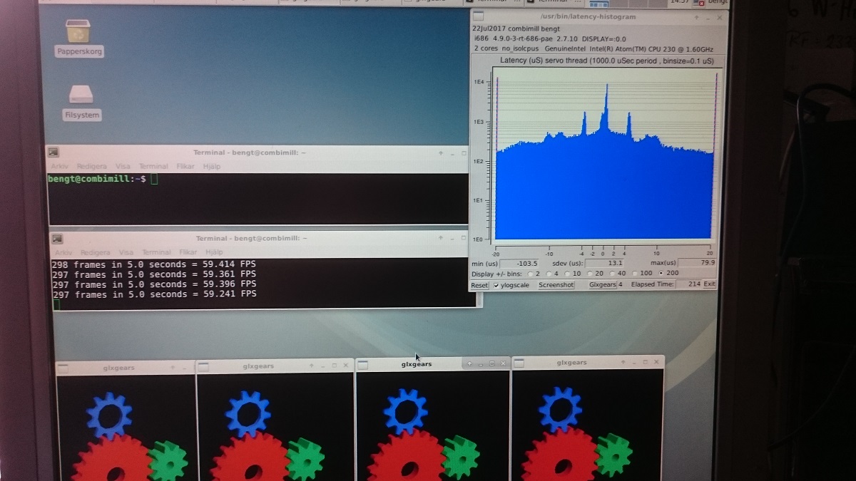

22 Jul 2017 14:01 #96285
by tecno
- Posts: 18111
22 Jul 2017 14:09 #96286
The only thing that really matters if is the system runs without getting real time errors
the latency number is really not important as long as the 1 KHz timing is always met

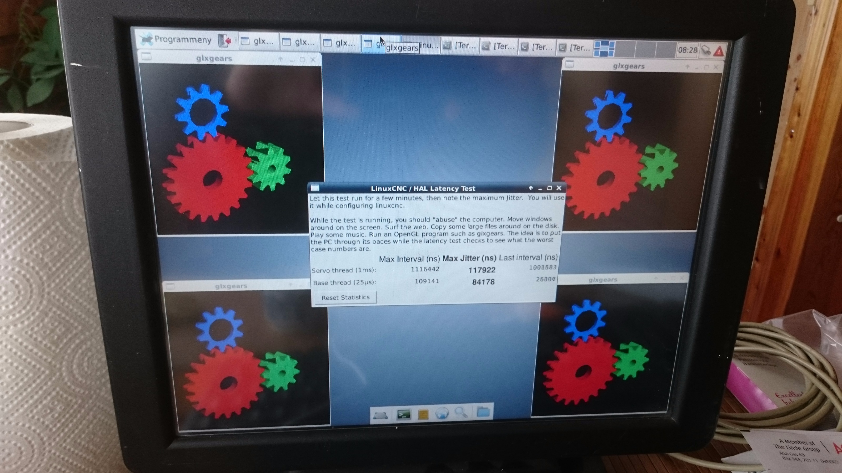

23 Jul 2017 07:32 #96305
by tecno
Made some more tweaking in BIOS and now it is more stable, same figures after 14½ hours.
Assuming this will ge me going maybe not optimal but workable.
