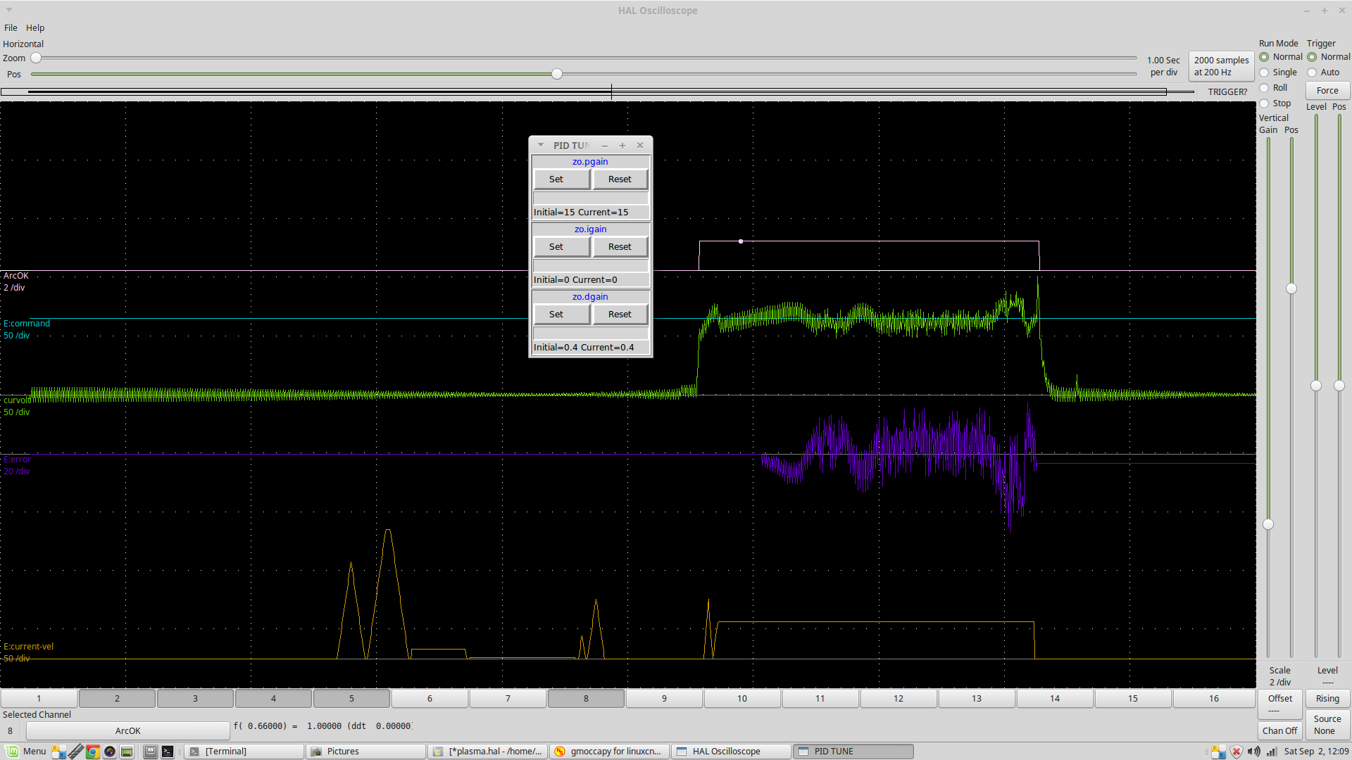

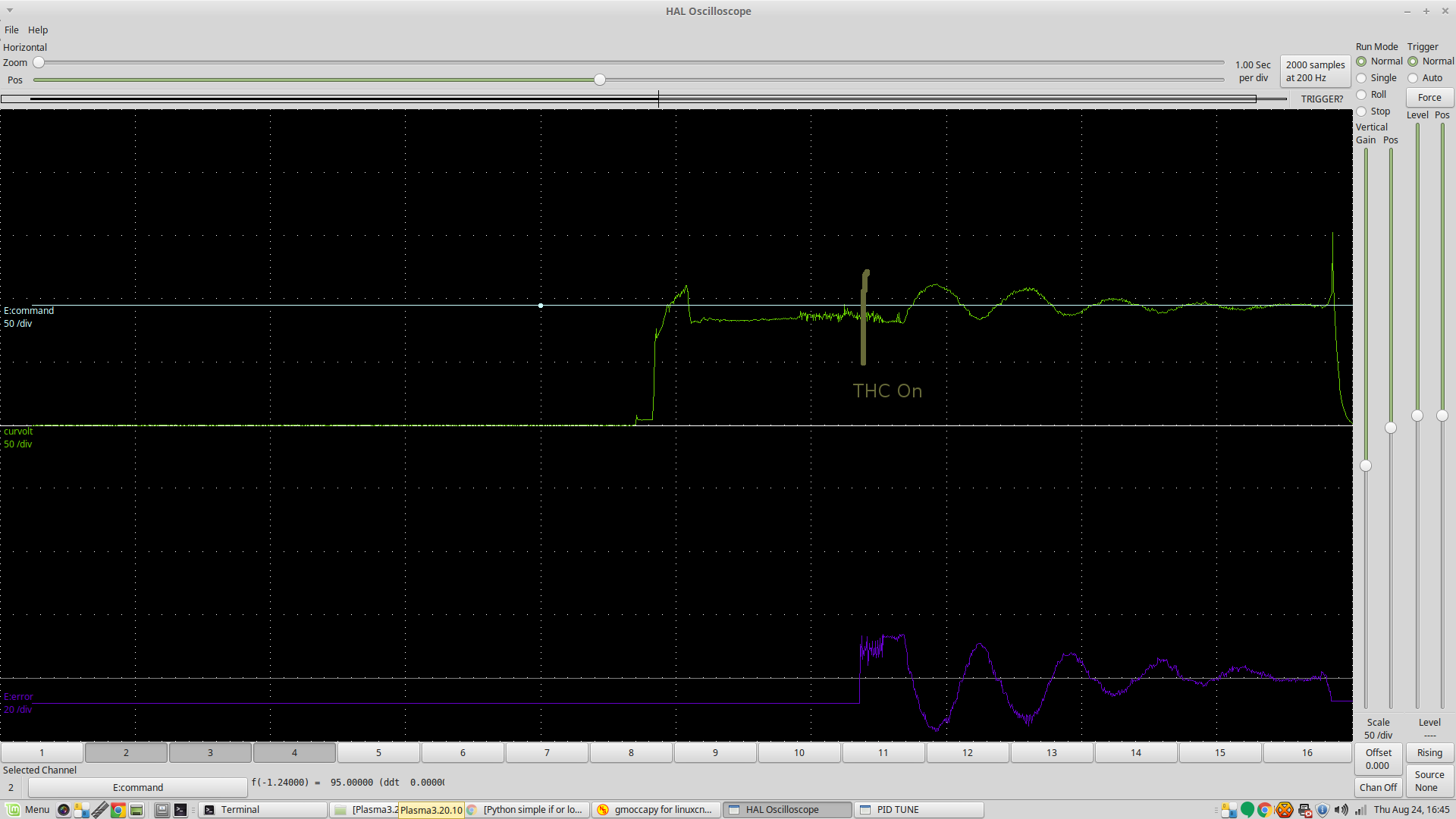

Meas THCAD-10 noisy signal was created by rodw
I've using the THCAD-10 (using 1/32 division) with an external resistor to double the full scale range to 20 volts. This proved too much so I removed it to revert to the native 10 volt scale and the signal became very noisy:
So with the plasma cutter turned off, I connected 2 x 48 volt power supplies together and connected them to the internal CNC board.
The board has a 100 k resistor on both the +ve and -ve raw arc signals so the raw output voltage measured 94.4 volts.
The divided voltage on the 16:1 divider is showing 5.91 volts which is 15:97:1
Previously, the voltage signal in LinuxCNC was very stable
As soon as I plug the divided signals into the THCAD-10, the voltage observed becomes 2.943 volts and this is what is sent to Linuxcnc. So the divider is 32:076:1
I am guessing the divider circuit on the Plasma CNC board are seen by the THCAD-10 as being external resistors. I can calibrate that out with my test signal.
With the plasma cutter turned off, there is no noise source.
So why is the noise there all of a sudden and how can I manage it? The signal is unusable as it stands.

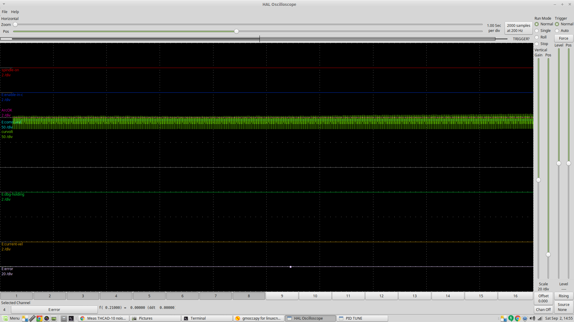

02 Sep 2017 04:58 #98359
Replied by rodw on topic Meas THCAD-10 noisy signal

Replied by PCW on topic Meas THCAD-10 noisy signal

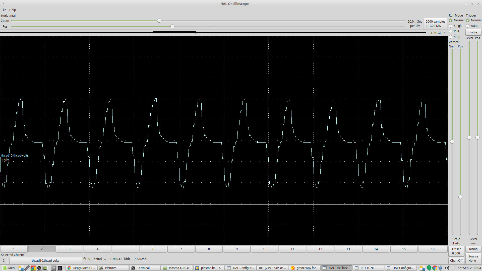

I would think this is an issue on the analog side (Input shield not connected to frame ground, input ground not connected to plasma ground etc)
why is the sample rate so slow (200 Hz)? can you speed up the sweep so the oscillation/noise can be resolved a little better?

02 Sep 2017 06:06 #98363
Peter thanks.
It clearly is on the plasma side. I did a plot of the 5 volt on the stepgen voltages and it was perfect. Clean and exactly where they should be.
The 200 hz signal is a default becasue there are 8 signals being monitored as part of Deweys eoffset_pid so I'll enlarge it on the next plot.
I will checkout the grounds. I'm using a 9 core shielded plasma interconnect cable. At the control box end, the cable shield is connected to one of the Shield inputs. The other shield input goes to frame ground (nice copper stud on the enclosure).
At the plasma end, the shield is not terminated anywhere which is how I thought it should be done.

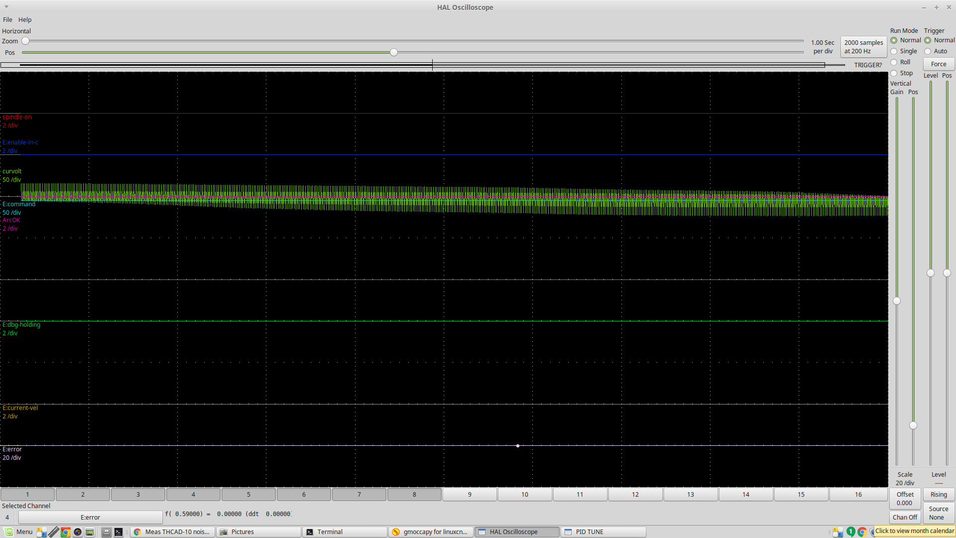

02 Sep 2017 07:13 #98366
I thought it was best to give a plot of the actual volts in the 0-10 volt range.
I think this has got worse. there is a bit over a 4 volt range peak to trough.
There's at best a 0.010 volt variation on the plasma side of the THCAD according to my multimeter (which might not be the greatest but it has a 0.001V scale and 4000 counts) There is nothing to generate noise as the plasma is not powered up. Very strange.

02 Sep 2017 13:31 #98371
50 Hz...
Is that your line frequency?
The mulltimeter will average the signal on DC what does the multimeter read on AC?
