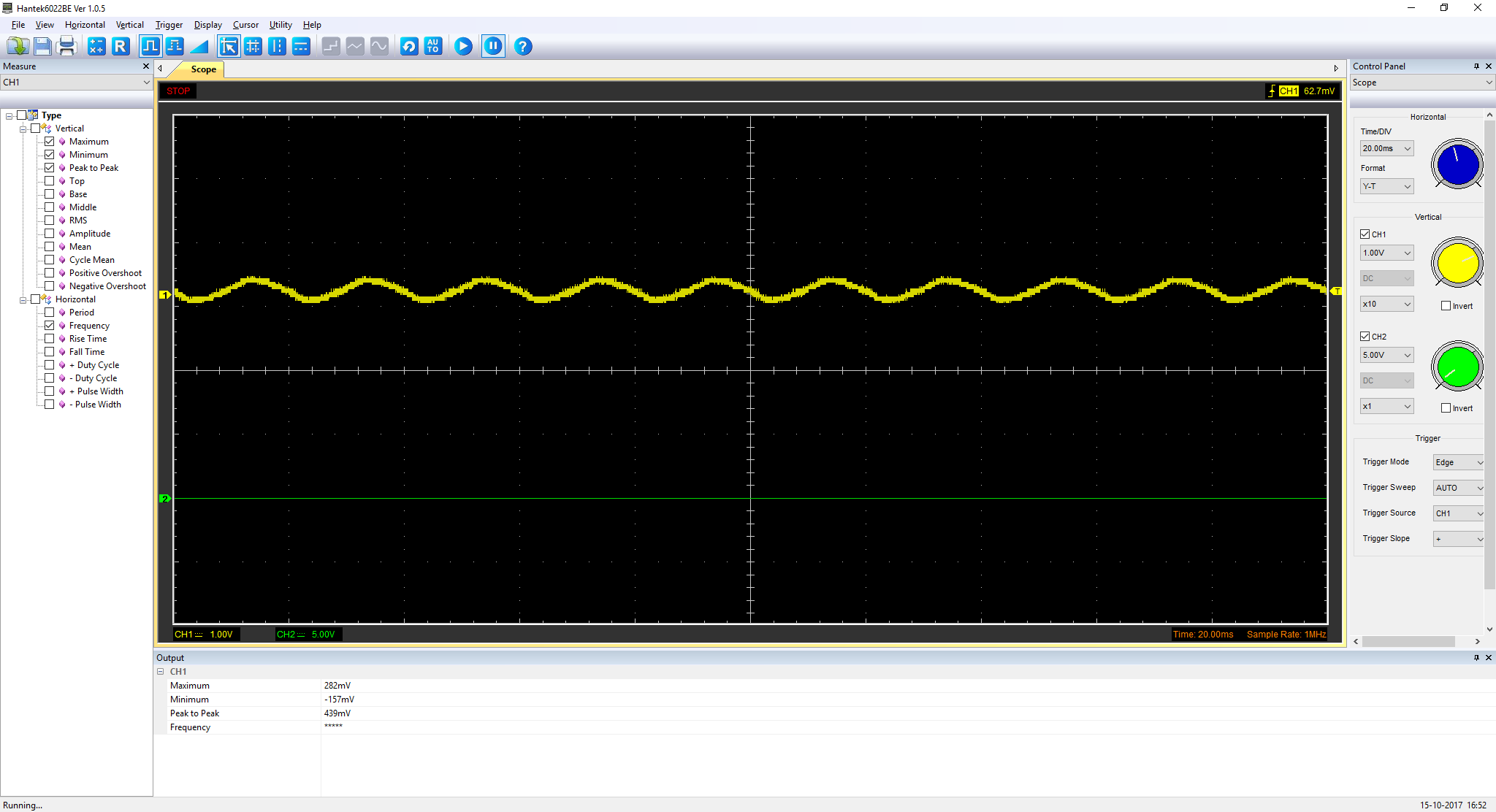

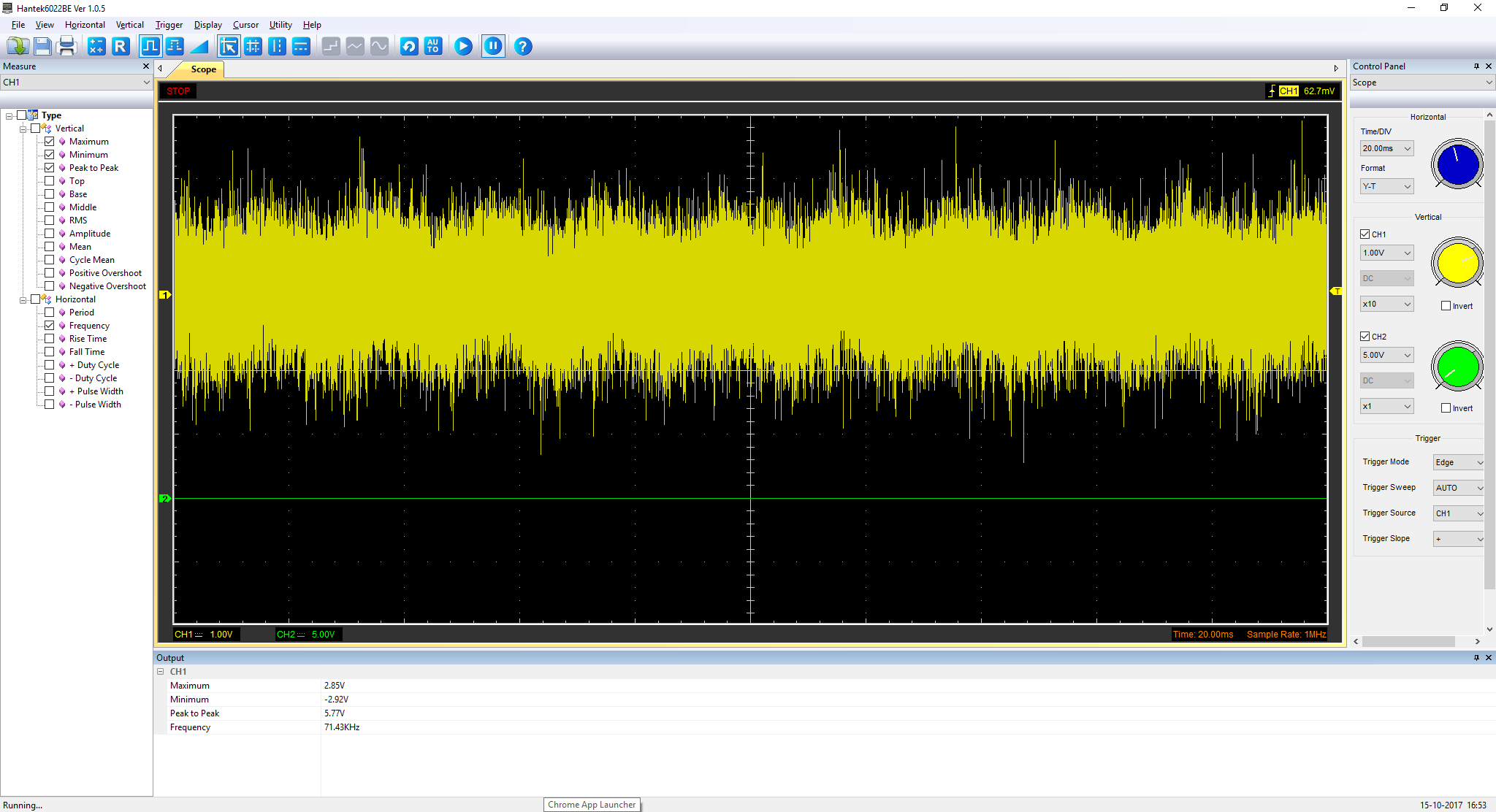

15 Oct 2017 07:38 #100366
Replied by rodw on topic Meas THCAD-10 noisy signal
Well, the capacitor made no difference so I bought a Hantek 6022BL USB oscilloscope. I measured the divided voltage with the plasma cutter on but not cutting at the entrance to the control box. I could see a 50 Hz ripple.
And then I turned the power on to the control box and it overlaid massive noise over this ripple.
I disconnected both the enclosure ground and the cable shield from the THCAD and it made no difference.
Any Ideas on where to go from here?

15 Oct 2017 09:29 #100378
by Mike_Eitel
Replied by Mike_Eitel on topic Meas THCAD-10 noisy signal
You should place an inductivity before your capacitor an make a low pas filter. Measure the frequency of the noice an than you can decide for the coil you need, or what I would do without calculating is taking a ring coil that is used in 50 herz ac devices. You can f.x. find them in electronic board of cheap fluorescent lamps.. Good luck.
