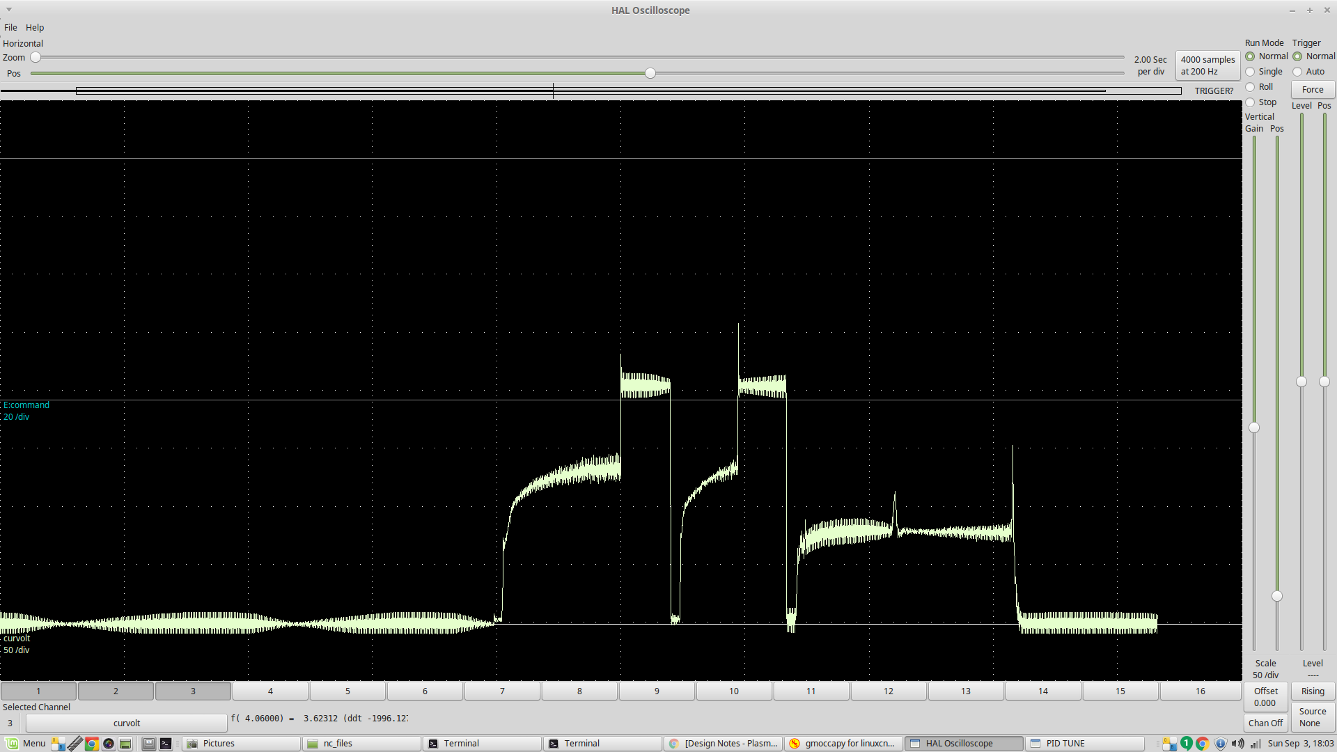

Replied by rodw on topic Meas THCAD-10 noisy signal

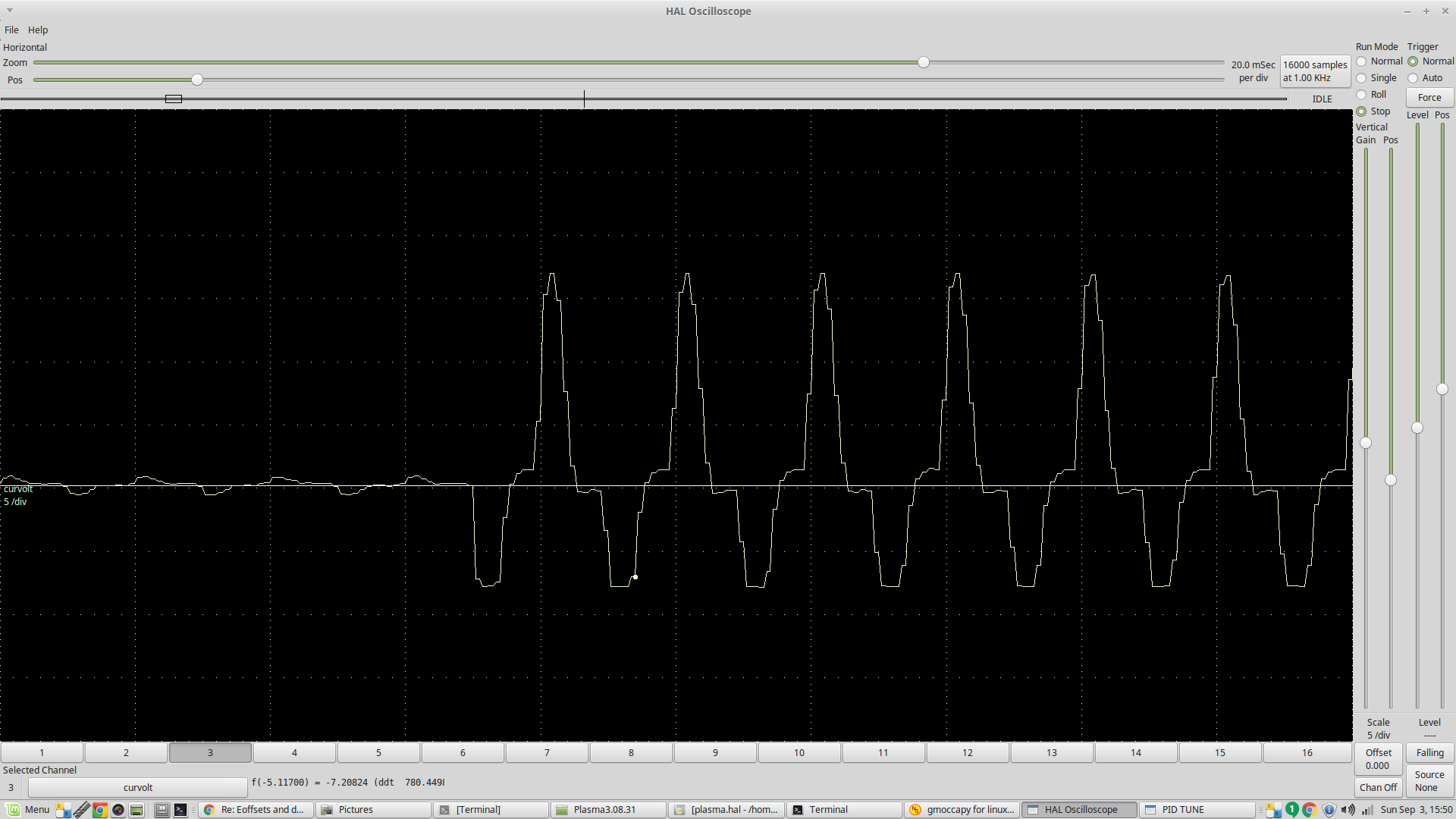

Well this is strange. The noise is due to the grounding of the THCAD to the control case.
The lower amlplitude signal is without grounding. The large amplitude is connected to the case
Here is a close up of the transition. Very strange.
I'm certain this was not happening previously so something has happened to cause this. Any ideas?
For now, I won't ground the THCAD to the case.

03 Sep 2017 13:37 #98408
Replied by PCW on topic Meas THCAD-10 noisy signal
I still think this looks like a missing ground
That is this is pretty much the signal you would expect if you measure the ground of an ungrounded
piece of equipment vs earth ground (basically the high frequency components of your line voltage)
The THCAD input should be wired
INPUT+ to plasma voltage divider low side
INPUT- to plasma voltage divider high side
INPUT shield to plasma source frame ground/ plasma voltage cable shield

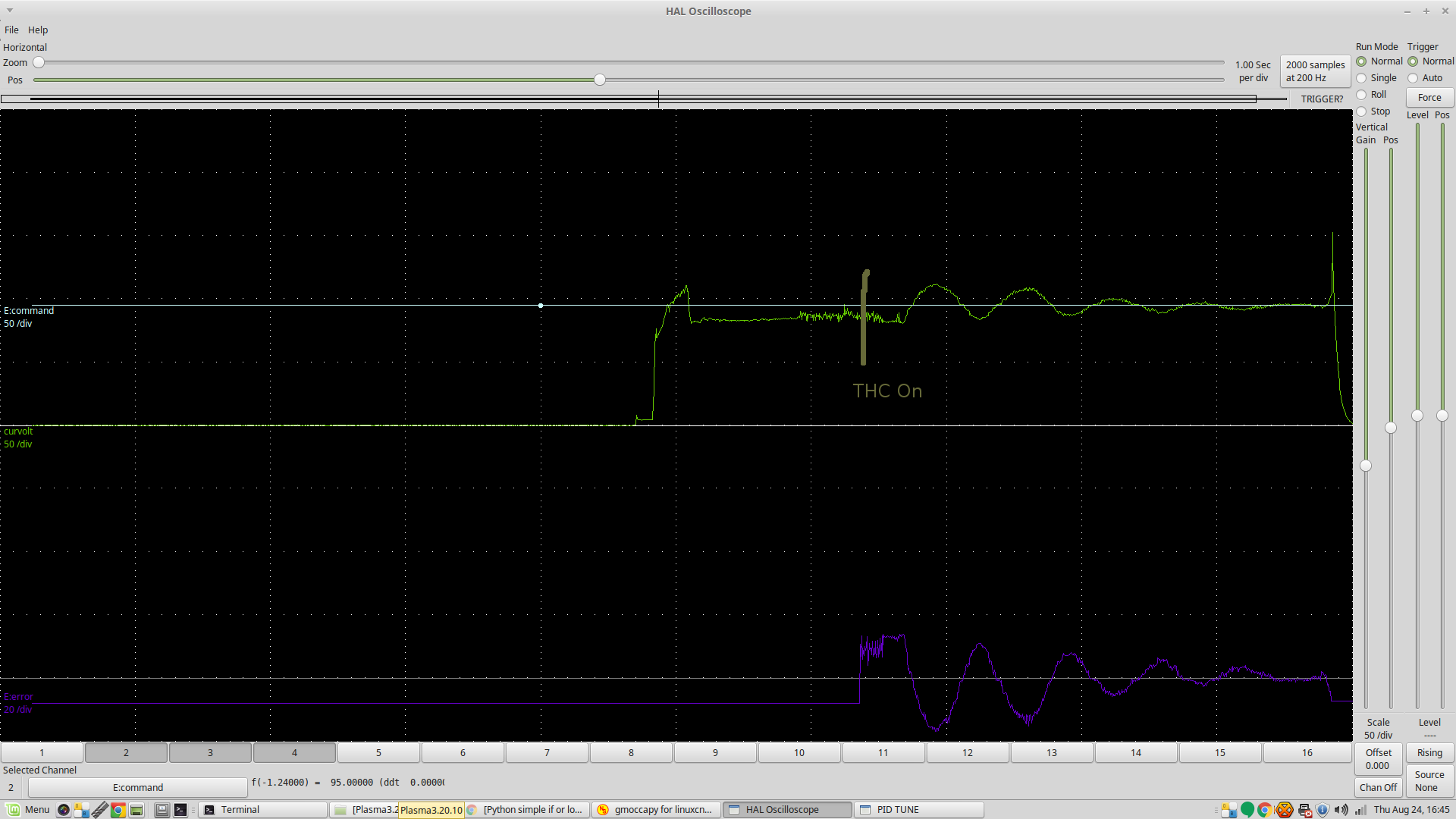

03 Sep 2017 13:57 #98409

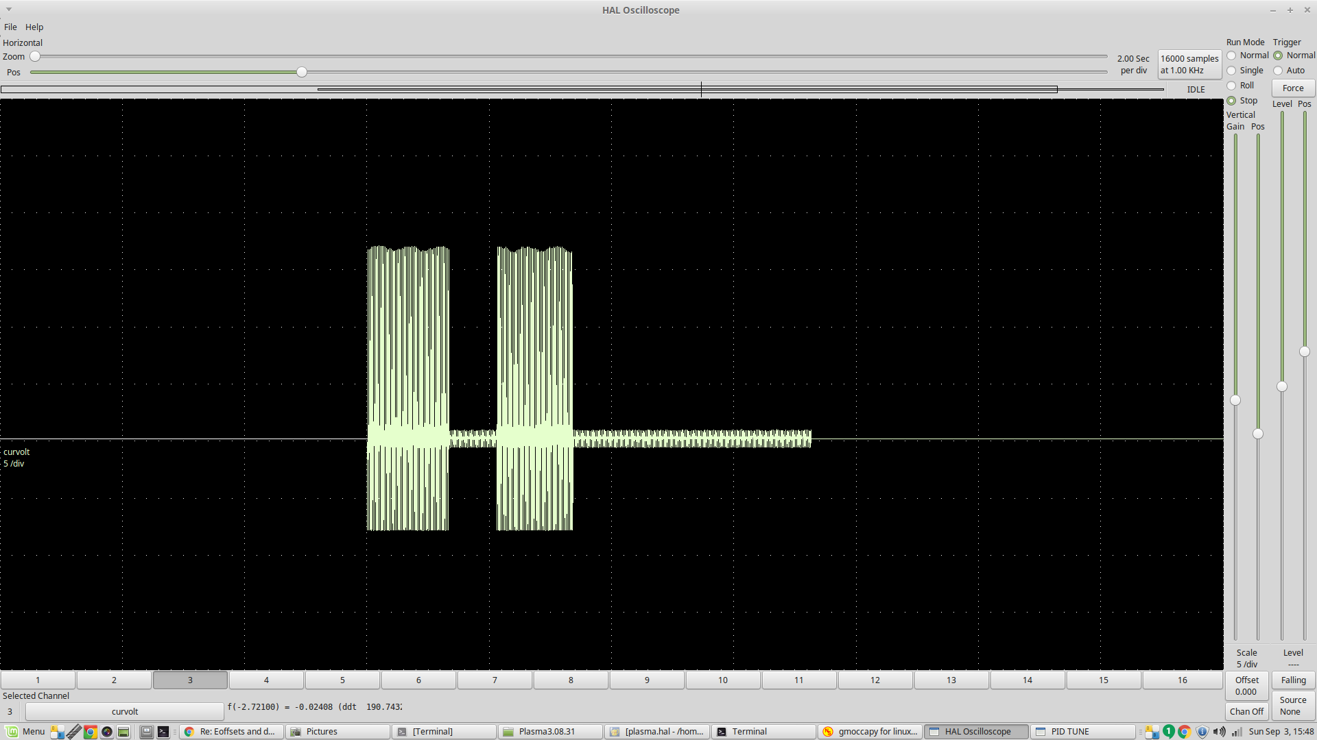

Peter, this might be the case if it were a new installation but this has been in service for a while. On Saturday, the signal went from this
To this
You can see the plasma cutter is not even establishing an arc and retries a couple of times becasue it is not giving itself an ArcOK. Its not Gcode pulling the trigger multiple times.
Its really very frustrating and clearly nothing to do with your hardware.
All of the grounds are wired as per your instructions (and the manual) and have been double checked many many times.
The noise is there even if the plasma cutter is turned off but if the internal Plasma wires leading to the THCAD are removed, the noise stops. I kinda think something has broken in the plasma power supply.
I might double check the plasma power supply is still earthed to mains power in case something has come adrift.
To this
