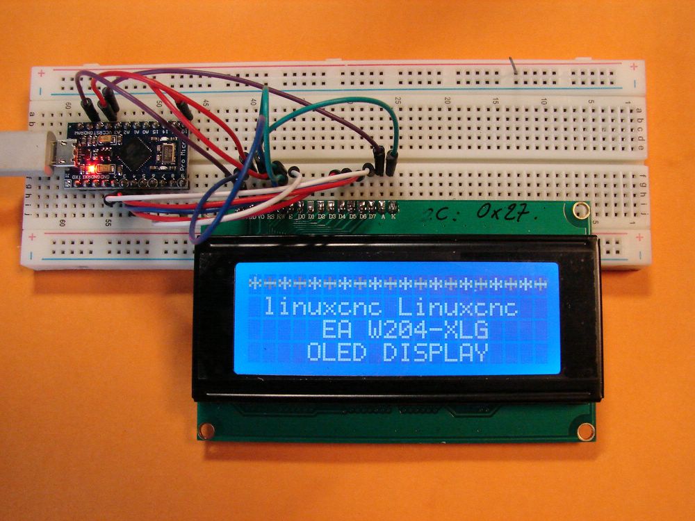

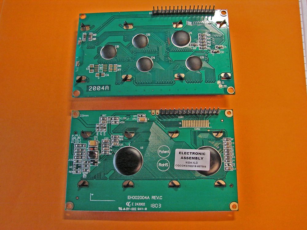

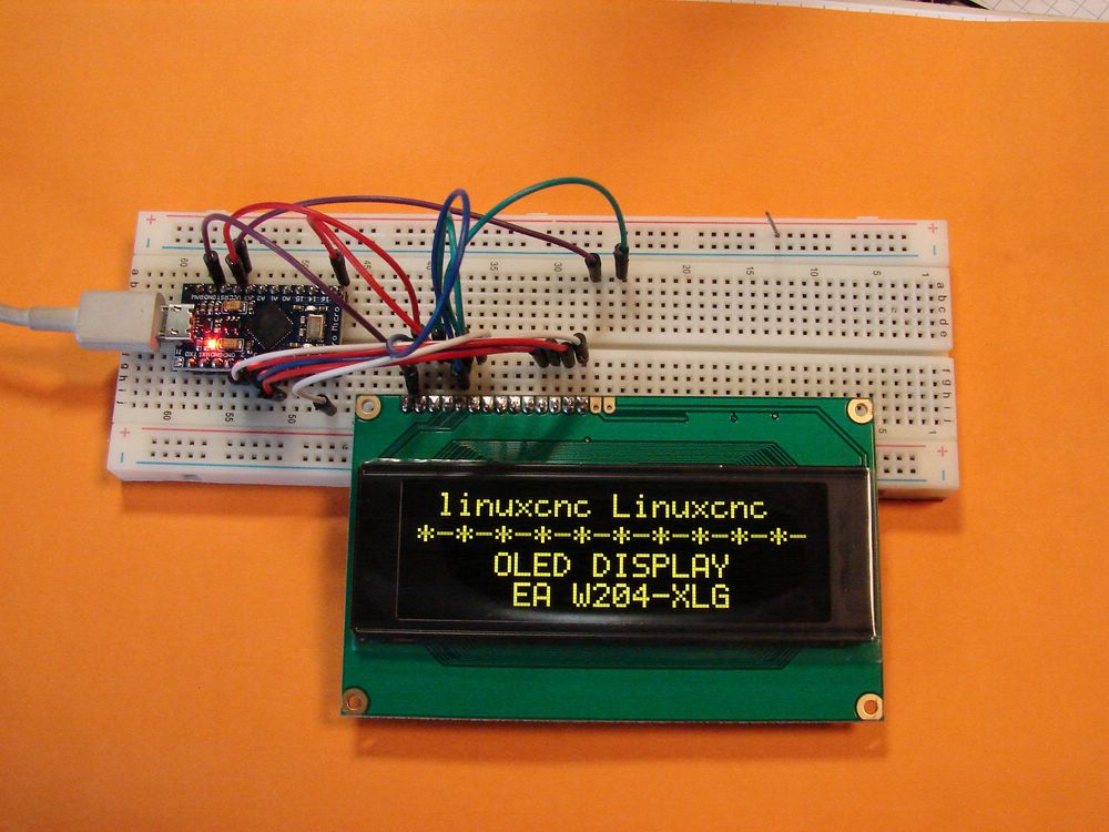

Hello,
Someone trying to connect an OLED display on a 7i73 ?
I rated 1 LCD display and 1 OLED with Arduino, both are working (but rows permutated on oled )
But on the 7i73 the LCD works but not the OLED
thank you
Linuxcnc 2.7.14 5i20 SVSS4_8
www.lcd-module.com/fileadmin/eng/pdf/doma/olede.pdf
(it's the same as the NHD-0420DZW-AG5)
thank you
Last edit: 03 May 2019 15:23 by gaston48.
- Posts: 18020
- Thank you received: 5294
03 May 2019 15:52 #132643
Replied by PCW on topic 7i73 LCD shows rubisch
I wonder if there is some initialization code needed on the OLED display
do any commands like clear screen work?

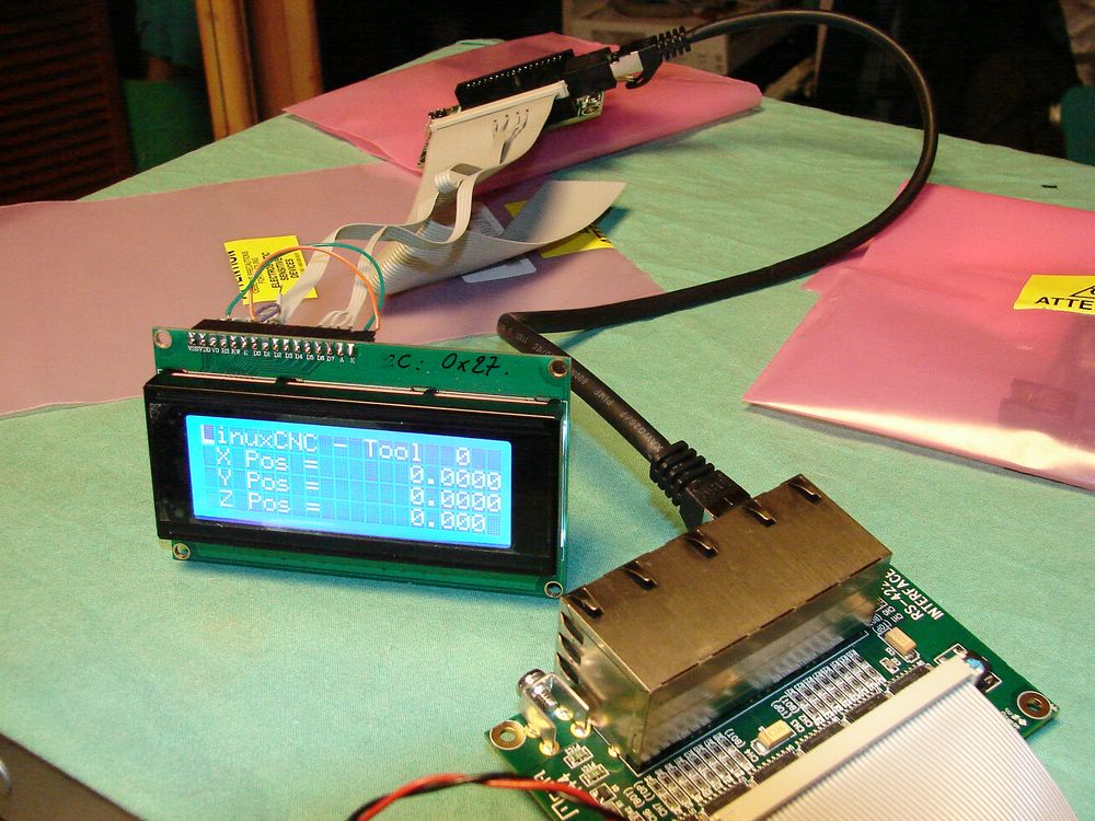

03 May 2019 16:48 #132648
by gaston48
Replied by gaston48 on topic 7i73 LCD shows rubisch
thank you PCW,
I do not know, I use Andy's "lcd" there
has no clear screnn instruction.
With arduino, oled and lcd start at power on
I have 2 new 7i73 unit the display is different under the same conditions ?
unit 1300010A
unit 13000168
unit 1300010A
unit 13000168

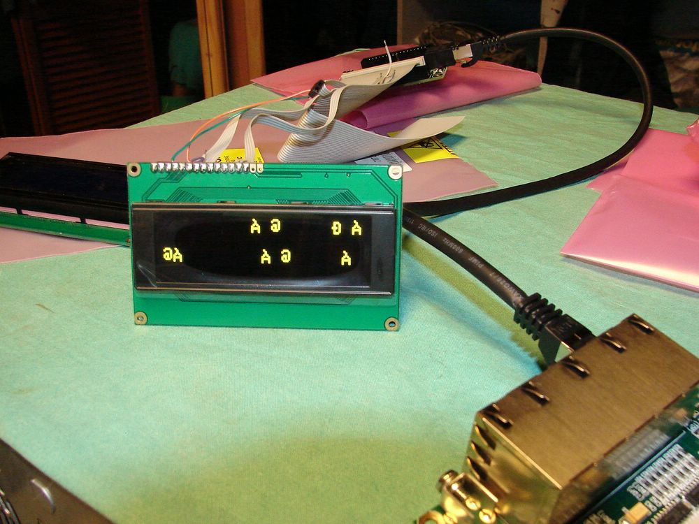

03 May 2019 20:37 #132665
by gaston48
Ok, I saw that we can send control characters with lcd component "\HH"
I sent 0x1A, 0x0D also, not really effect, it changes the random side.
I forgot to mention that the display is also very animated !

03 May 2019 21:21 #132668
Yeah maybe the OLED controller is not close enough to the LCD controllers to work properly with the 7I73 signals. We did verify operation with many LCDs
but (relativley) low cost OLEDS were not available at the time we did the testing.

04 May 2019 10:24 #132715
Just thought of something: how are you powering the OLED?
A LCD would be connected to the 7I73s VEE pin but this wont work with the OLED
Have you tried 5V and 3.3V power from the 7I73?

04 May 2019 13:53 #132737
by gaston48
By the 5 V of the pin 28 and the GND pin 27. VEE not connected
I suspected the power supply and I checked
with an oscillo the power supply is clean
the funny thing is that when I send a fixed text
the oled sometimes returns an animated light of nignt club
An oled display is truly incomparable for a
industrial application: readability in all angles, contrast, time response etc ...
