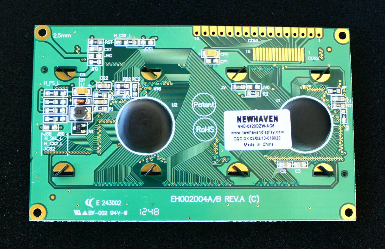

7i73 LCD shows rubisch

OK tried Andys test.hal script on LinuxCNC 2.8 and 2.7: (with adjustments for host FPGA type, I used a Ethernet card)
2.8 Works (blinking underline cursor disabled)
2.7 Does not work (cursor never disabled= hash on screen)
I think that there were some cleanups in the LCD component that were not merged to 2.7.
This is born out by using the 2.8 LCD component source on LinuxCNC 2.7 (this fixes the cursor issue)
I suspect this may be a long standing bug that was not noticed due the long response time of LCDs
which would make the scattered cursor hash nearly invisible.
- Thank you received: 4654
27 May 2019 20:13 #135085
Replied by andypugh on topic 7i73 LCD shows rubisch
In that case, the answer is to download this file:
raw.githubusercontent.com/LinuxCNC/linux...hal/components/lcd.c
and then compile and intall it with
sudo halcompile --install lcd.cPlease Log in or Create an account to join the conversation.
