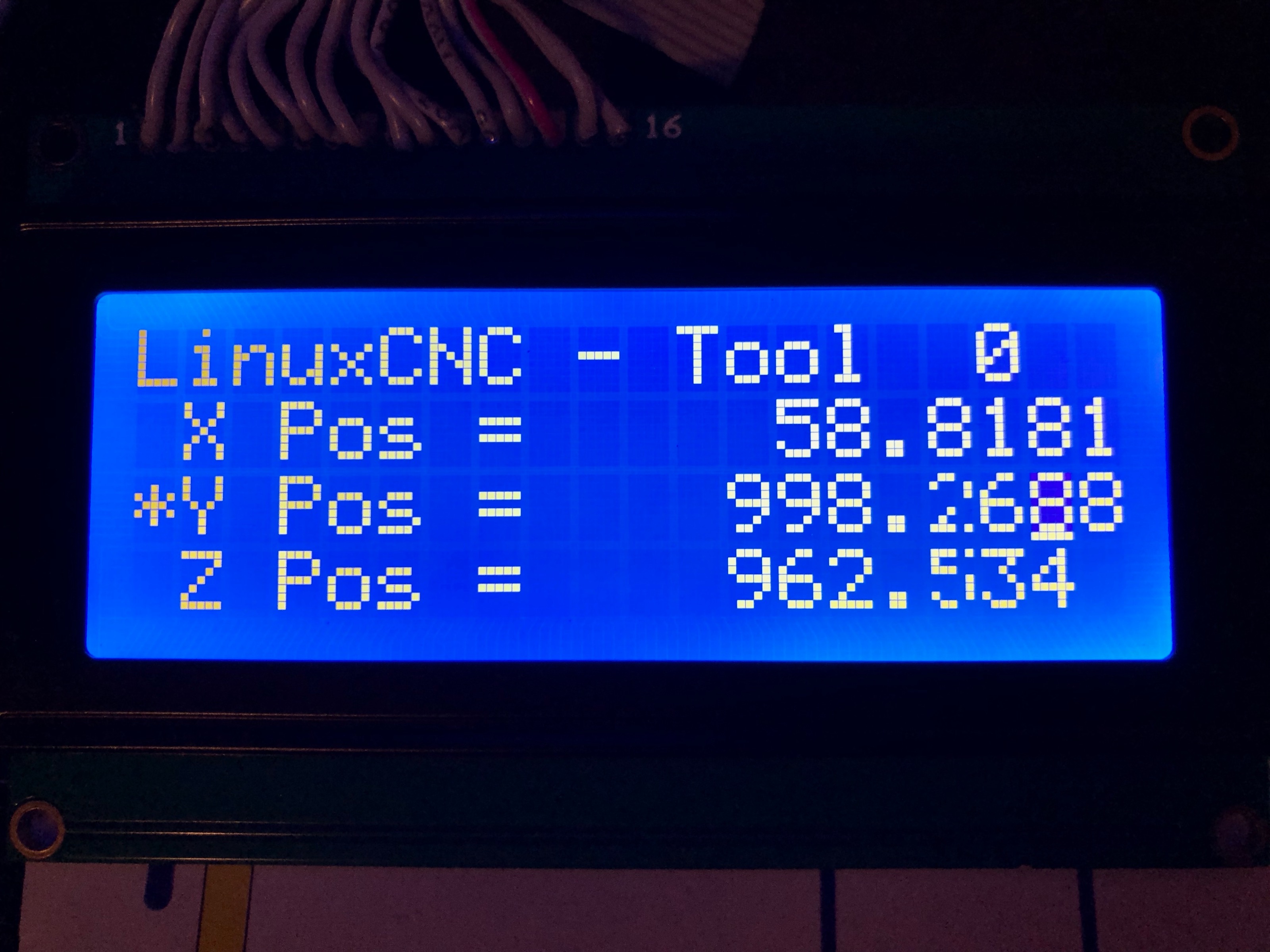

Can you show a picture of the problem?
I just pulled 2.7, got an LCD working, then pulled the latest 2.8 and tried again, and it worked just the same?
What 7i73 firmware version are you using? (Mine might be rather older than yours)

08 Feb 2018 21:49 - 08 Feb 2018 21:52 #105606 by andypugh
Replied by andypugh on topic 7i73 LCD shows rubisch
Can you try this code
loadrt hostmot2
loadrt hm2_pci config="sserial_port_0=0x20000000"
loadrt lcd fmt_strings="LinuxCNC - Tool %2i\n%b* X Pos = %11.4f%b* Y Pos = %11.4f%b* Z Pos = %10.3f|Long Number\n%015.2f\n"
loadrt threads
loadrt siggen
addf hm2_5i25.0.read thread1
addf hm2_5i25.0.write thread1
addf lcd thread1
addf siggen.0.update thread1
net chars lcd.00.out hm2_5i25.0.7i73.0.0.display
start
setp lcd.00.contrast 0.7
net stuff lcd.00.page.00.arg.02 siggen.0.sine
net stuff1 lcd.00.page.00.arg.04 siggen.0.cosine
net stuff2 lcd.00.page.00.arg.06 siggen.0.triangle
setp lcd.00.page.00.arg.03 1
setp siggen.0.amplitude 1000
setp siggen.0.frequency 0.000005
(save to a text file, test.hal, for example, then use the command
halrun -I test.hal
What I get, with the latest 2.8, is this: (Slightly dodgy LCD, but seems to work)

08 Feb 2018 21:50 #105607 by Mike_Eitel
Replied by Mike_Eitel on topic 7i73 LCD shows rubisch
Picture makes no sense. Better i describe.
For test i just use ABC, in the first position of first line. It i writen there.
But these three letters are immediately positioned additionally everywhere on the screen. I guess it is at least 10 times per second.
I know lcd from my earlier AVR programming times. Could have a similar problem when errors in position commands.

08 Feb 2018 22:16 #105609 by Mike_Eitel
HI My wife will kill me ;-)
could not resist and honor your effort... THX
I have 7i76e so had to modify your code to:
loadrt hostmot2
loadrt hm2_eth board_ip="192.168.1.121" config="sserial_port_0=21xxxx"
loadrt threads
loadrt siggen
addf hm2_7i76e.0.read thread1
addf hm2_7i76e.0.write thread1
addf lcd thread1
net chars lcd.00.out hm2_7i76e.0.7i73.0.1.display
start
Result is the same
Can see your text on the screen, but it is overwritten very fast, much more then the guessed 10 times per second
on various positions. The basic image is more or less "reconstructed" on the same place.
Mike

08 Feb 2018 22:24 #105610 by andypugh
Using your example "ABC" string I get random letters all over the screen. But I get exactly the same thing if I pull 2.7 and recompile.
"ABC\n" works better, on both versions.
I think that there is definitely some room for improvement in the lcd component. But I am not seeing any difference at all between 2.7 and 2.8 versions of LinuxCNC on identical hardware.
