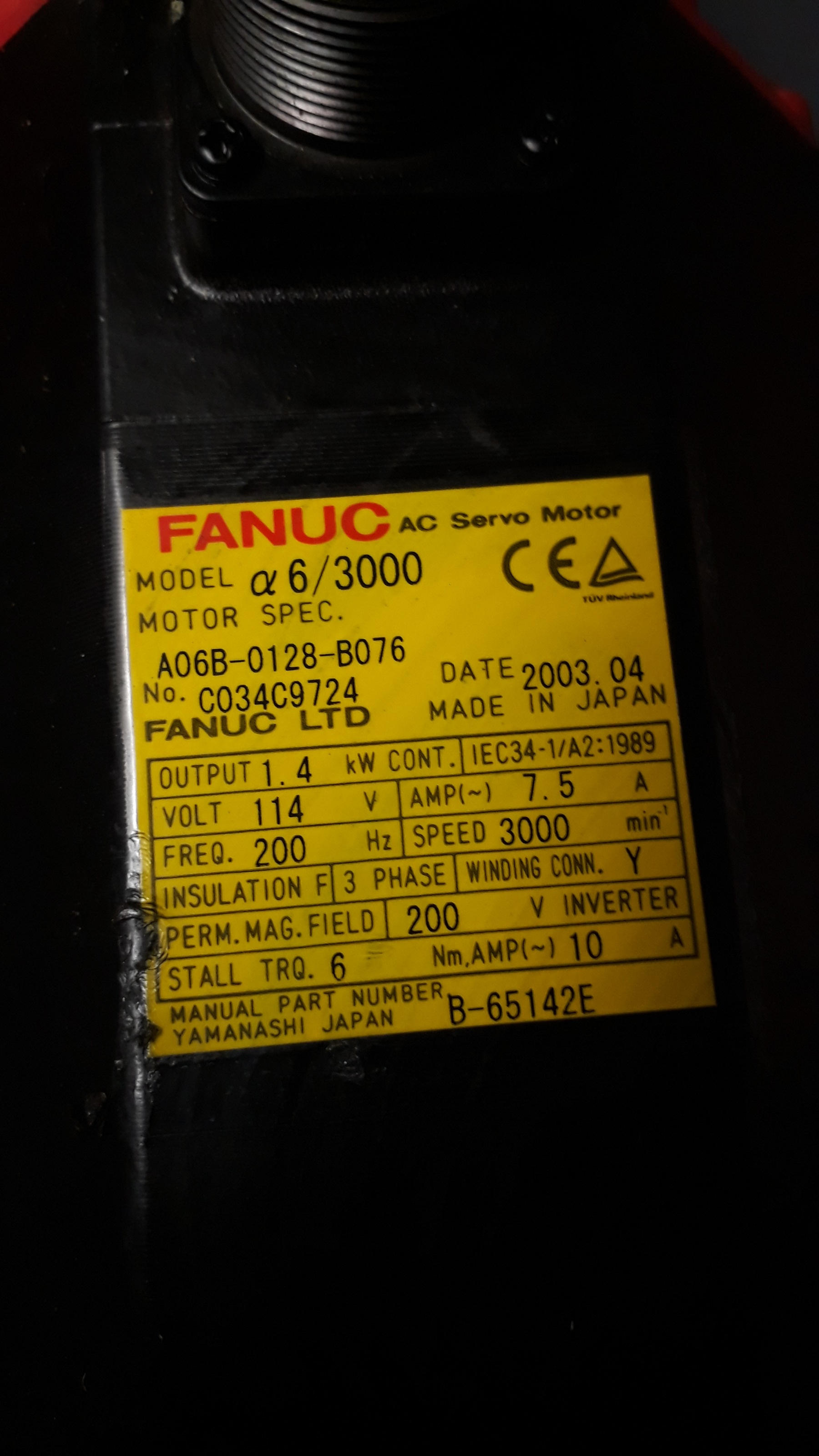

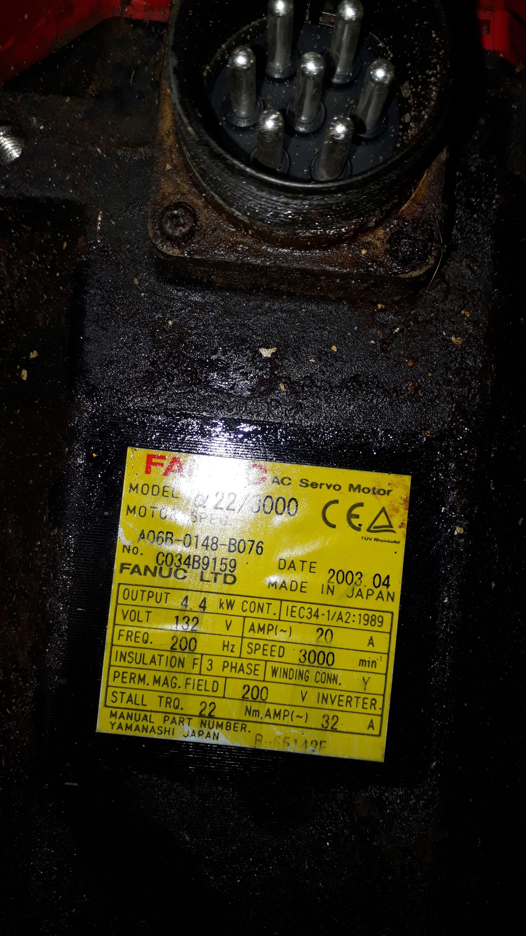

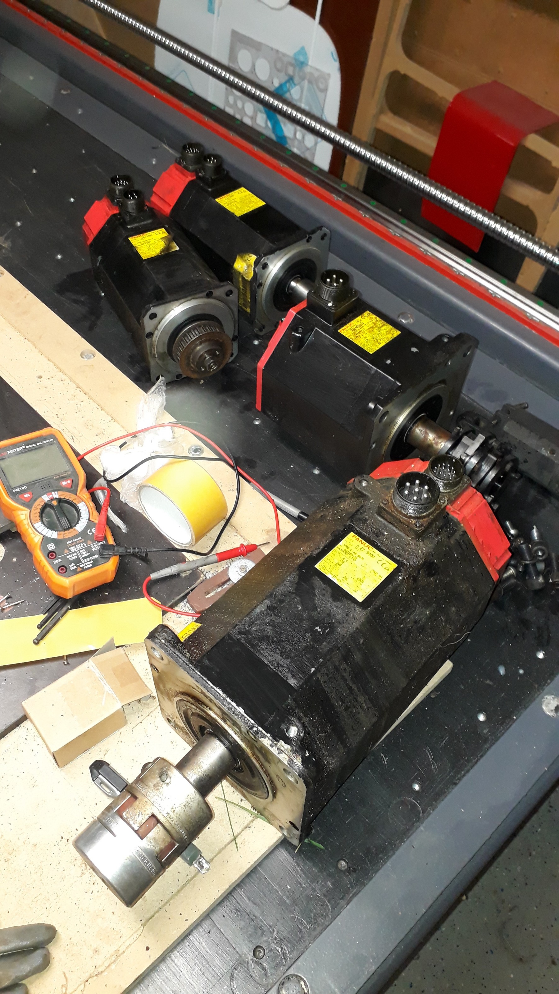

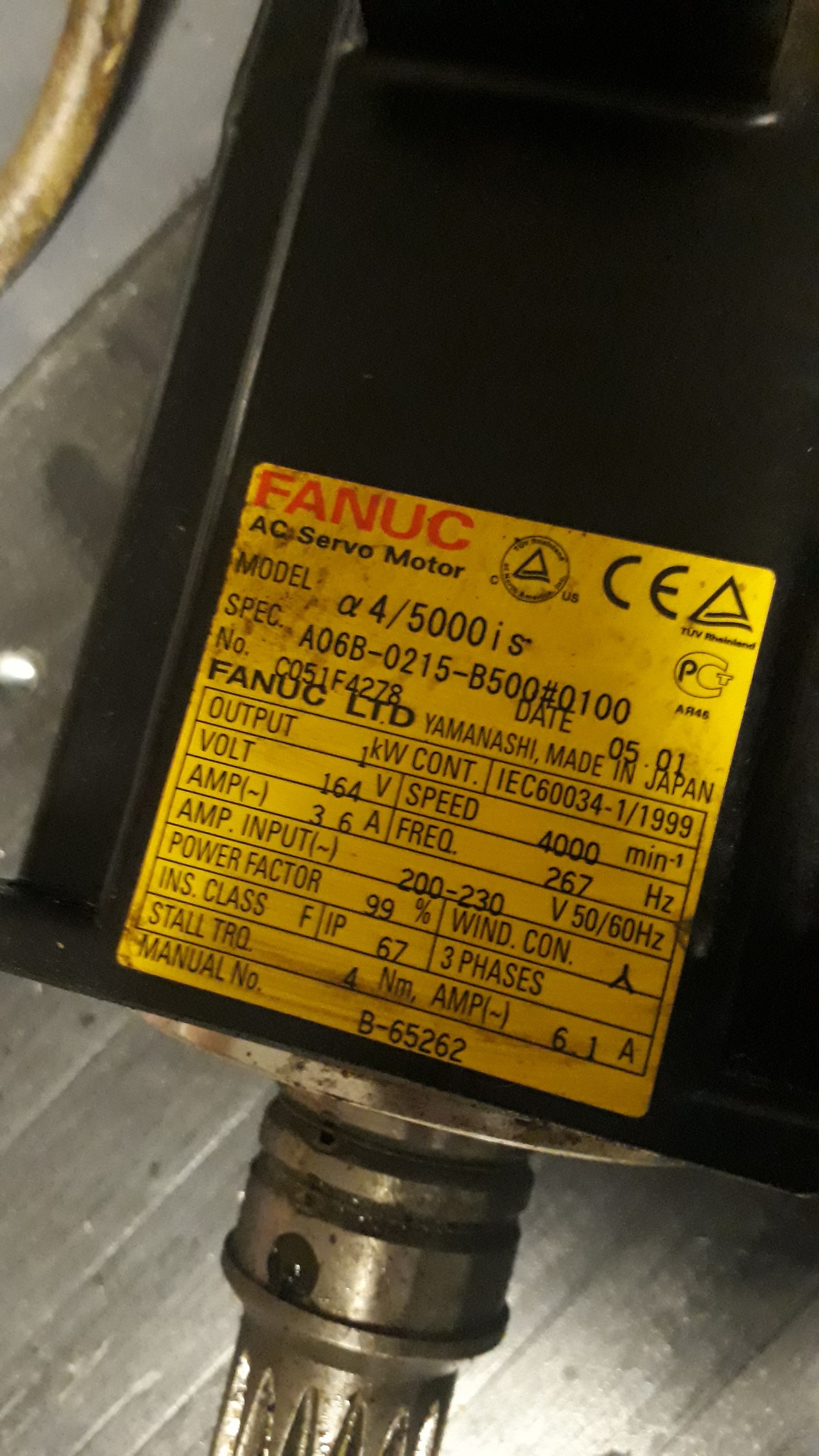

Hello,
currently i do renovating an old polish Lathe and of course it will be later an CNC Lathe, but my plan was to use standard stepper motors or hybrid steppers, but i got 4 Fanuc Servo motors which all should work for very cheap, so now i am thinking to use them instead of stepper or hybdrid motors, but unfortunately i have no drives/amplifiers.
I was looking already for informations and found out that Jon from Pico Systems offers an PWM controller, Servo amplifiers up to 120V and 20A and Fanuc encoder converters, but what else i need or is it all hardware i need to run the Fanuc Servo Motors?
I have 2 alpha 6 (1.4kw) servo motors, which should be very good both axis, but one of the bigger motors i would like to use as spindle motor. Unfortunately they would need bigger amplifiers, so what alternative i have ?
I am not sure if Mesa has also something to offer to get those Servo Motors to run. If so, it would be nice if you could help me out.

It is possible to run the Fanuc motors with Mesa kit. It is even possible to do it with a parallel port, though that's a kludge.
(the bldc HAL component can convert the commutation signals in software).
So, Mesa 8i20 drives and software commutation are an option (I have software commutation running both of my machines in the workshop, it works fine) .
One very good solution would be the STMBL servo drives, except that nobody has any available at the moment.

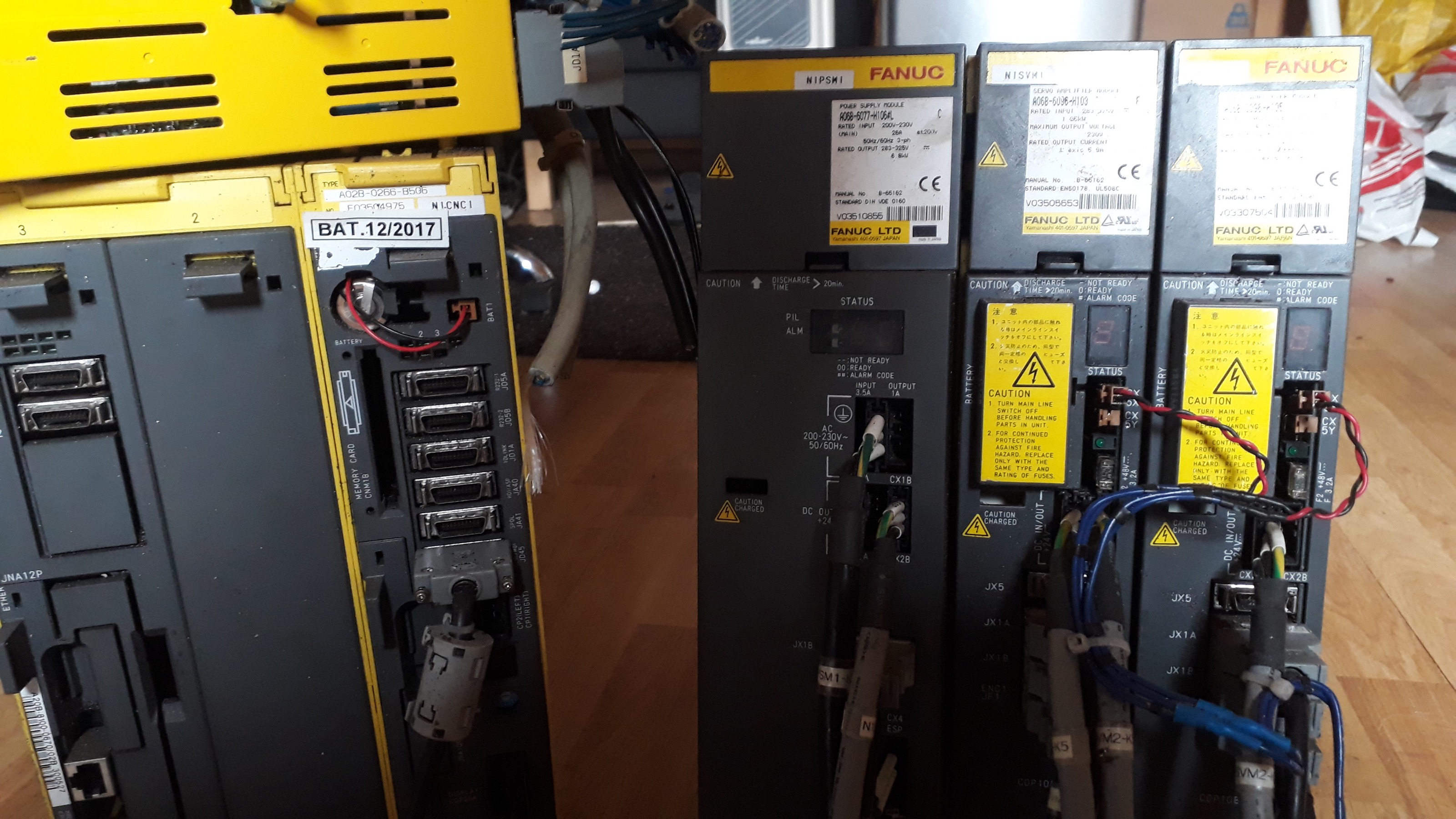

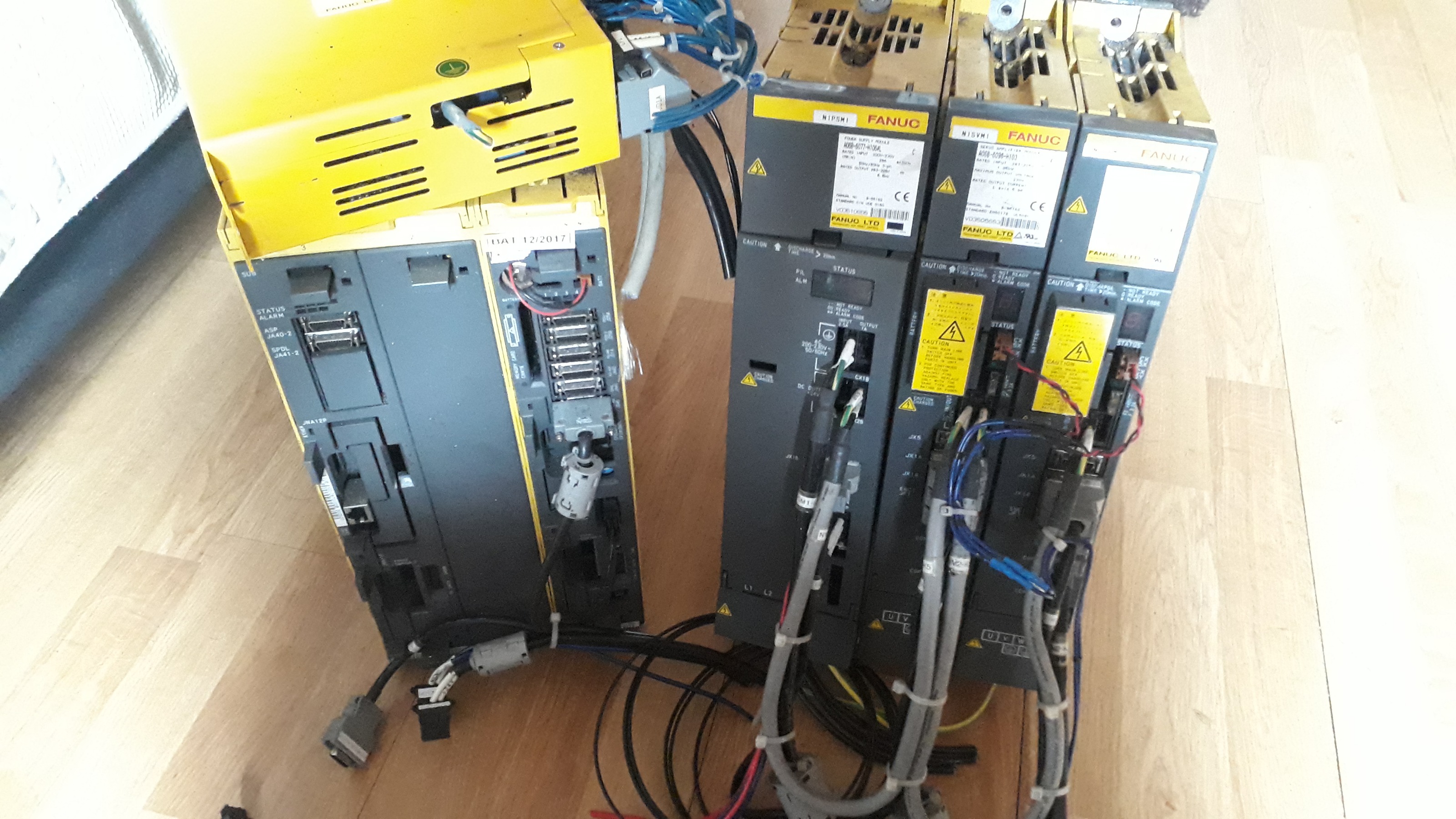

Hello,
i am sorry that i did not reply here.
First of all thanks for your help Andy and of course also thanks to Jon (awesome e-mail support)
I try to make it short: Today i went to that place where i got the servo motors from, and actually i was just there to look for transformers for the Pico brushless servo amps and the Fanuc Motors and also for an automatic lubrication pump (Vogel Japan). When i was looking for the transformer, i saw something yellow

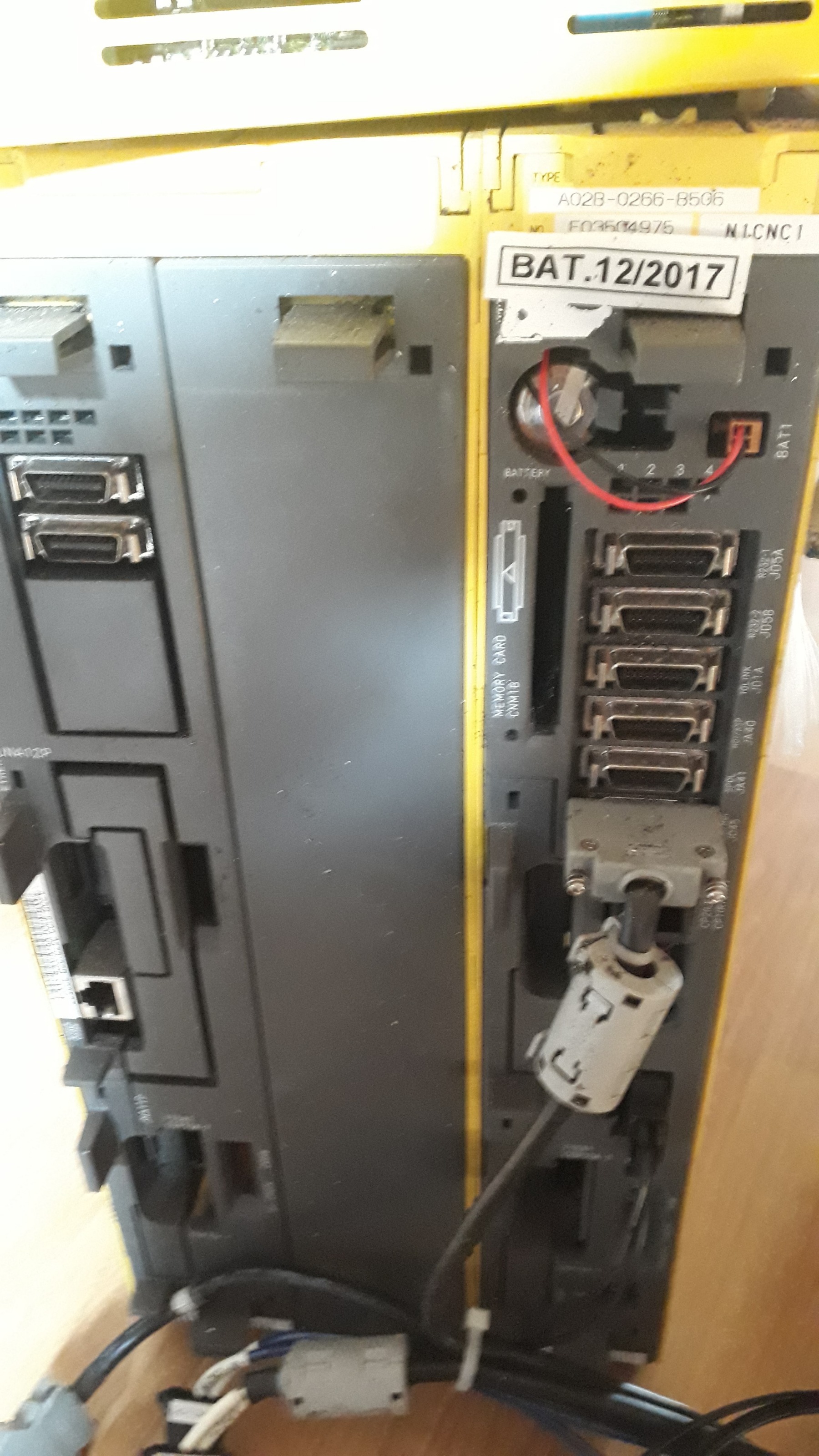

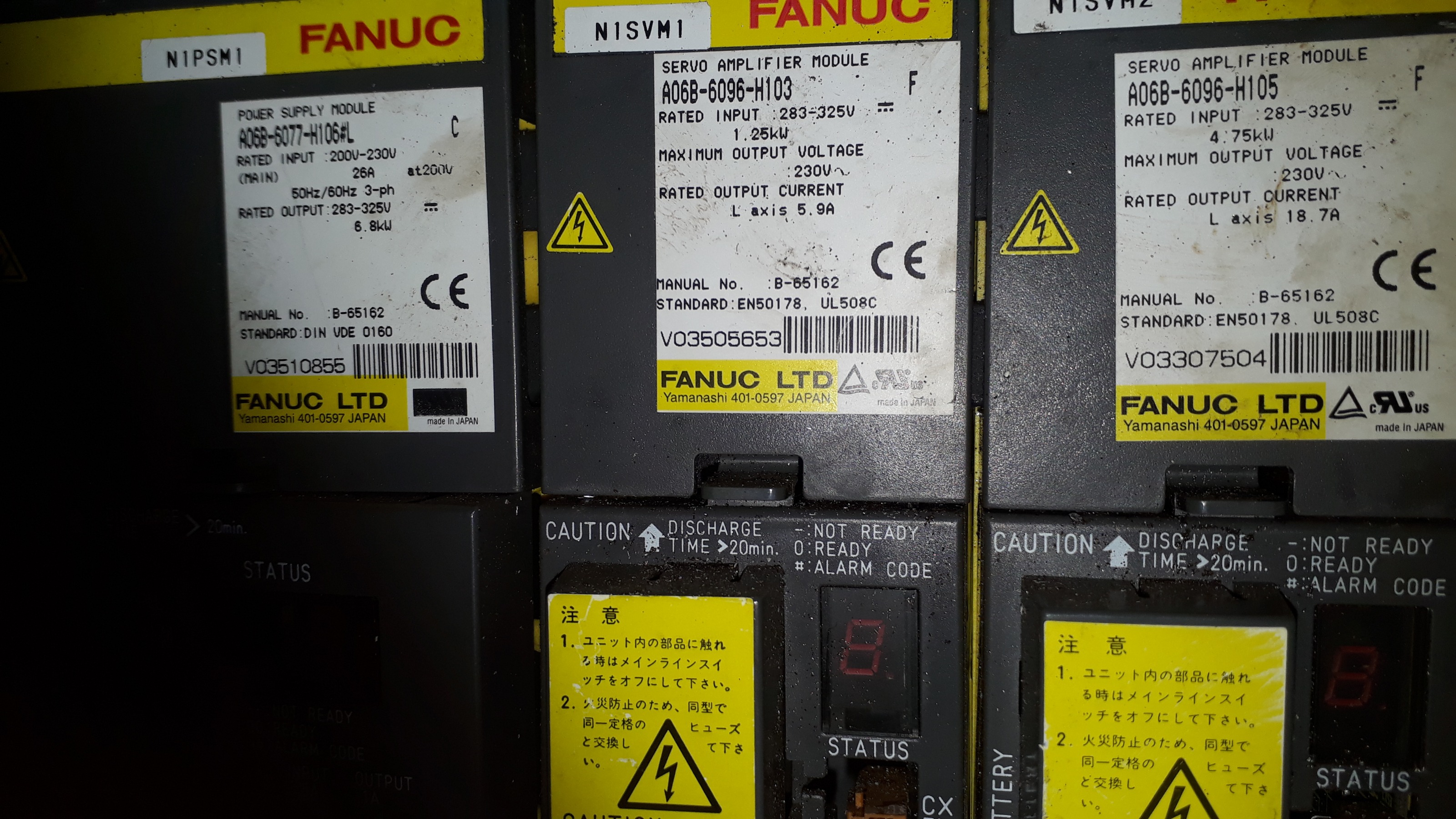

Just take a look at the pictures.
Here all part numbers listed:
1 x Fanuc CNC Control Series 18i-MA : A02B-0266-B506
2 x Servo Amps: A06B-6096-H103 and A06B-6096-H105
1 x Power Supply for both Servo Amps: A06B-6077-H106#L
1 x Safety I/O Unit (from different machine): A03B-0821-C001 B
I cut of the cables, but i think everything is as it was (i had to take off couple wires and it might be i plugged them wrongly back)
My question now is if i can use those amplifiers for the Servo Motors i have. (take a look at the first post). The first amplifier just gives 5.9 Amps,so to less for the alpha 6 but i also have found an smaller 1KW alpha 4 motor with an brake (alpha 4, take a look at the picture below).
I have no experience at all with servos, so it would be great if someone could help me out. I tryed to find some informations about which motors and encoders does work with those Amplifiers, but havent found anything for now. The whole Fanuc hardware was in an different machine then the motors, so its a mess..
I wanted to order all necessary pico systems hardware to get the alpha 6 motors to work for my Lathe project, but i got those Fanuc Hardware very cheap, so i just took it. If it does not work, i will sell it.
Thanks in advanced.

Those servo amps take 6 PWM signals from the CNC control for EACH servo amp, so you would need 12 channels of PWM output to drive two axes. I think Mesa does have a scheme to do this, but one would have to check with them to make sure that it has already been done with those servo amps.
Jon
Jon
- Posts: 19904
29 Oct 2018 07:54 #119589
Replied by andypugh on topic Hardware to run Fanuc Red Cad alpha 6 and alpha 22 servo motors
The bldc component is capable of generating the PWM values, and the Mesa 3pwmgen module is capable of making the necessary pulses (with dead-bands and shoot-through protection etc).
6-signal PWM is supported by both the Mesa firmware and the LinuxCNC driver, but I do not know off-hand which (if any) current bitfiles bring out all 6 signals to physical pins.
Have you worked out what commutation signals your particular motors output?

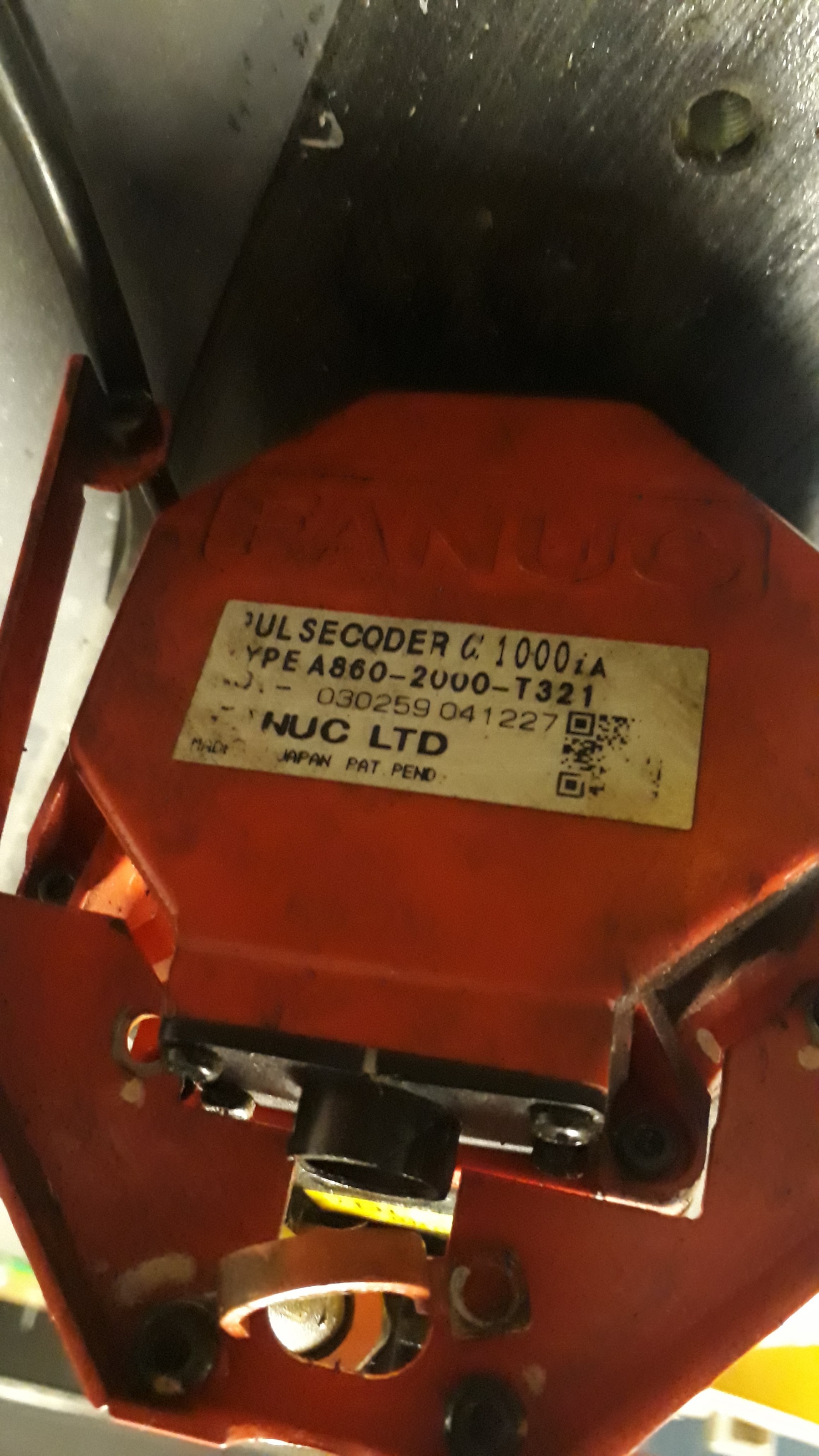

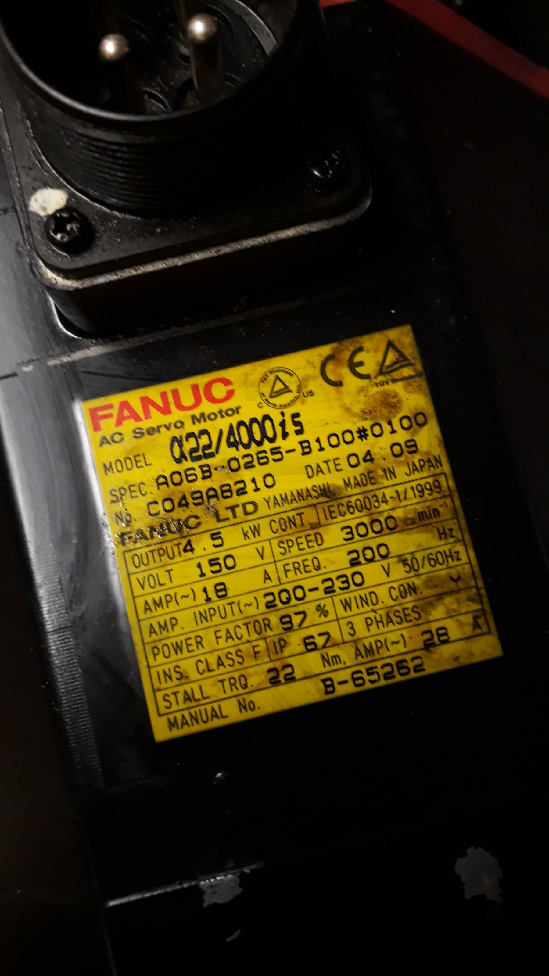

I am not sure if that is the answer you are looking for, but through googling i found out that the A64 encoder and the iA1000 encoder are "pulse encoders". Not sure if that helps.
EDIT: Jon wrote in an other thread couple years ago, that the encoders (a64) are serial encoders
The parts all exist, but putting them together would be an experiment:
linuxcnc.org/docs/2.7/html/man/man9/hostmot2.9.html#BiSS
So, with a Hostmot2 firmware that contained both the Fanuc serial interface and 6-pin 3-phase PWM it should be possible to put something together.
I am assuming that the encoers connect to the controller, and not directly to the drives (which would be easier)
