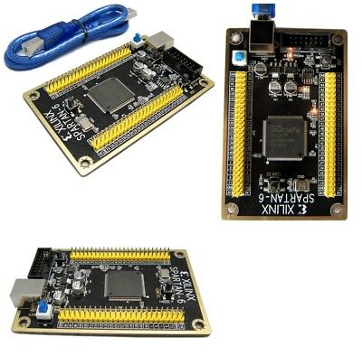

Hi
I'm looking to create a small and cheap embedded solution for Linuxcnc on a Raspberry to drive 3D printers. I was thinking to create a shield board for it based on a Spartan 6 using the SPI port (like the 7i90HD).
I found this little dev board for only 17$ on aliexpress it's a XC6SLX9 :
There is an M25P40 (4 Mbit) onboard.
Do you think it's possible to do that ? Is it legal (maybe the firmware license ?)

Yes, you should be able to do this, the HostMot2 firmware is open source.
Basically you would need to generate 3 card specific files for the Hostmot2 source:
XXXXcard.vhd (card specific info like number of GPIO etc)
XXXX.ucf (physical pin mapping)
PIN_XXXX.vhd (logical pin mapping, there can be many of these, and these are not card specific but rather number_of_GPIO_pin specific)
You can use these 7i90 versions of the above files as a starting point
i90_x9card.vhd
7i90spi.ucf
(plus any of the PIN_XXXX.vhd files)

Thank you again, if i understood clearly what you are saying, the only thing that i need to change is the Eprom pin assignement.
my I90_x9card.vhd (no change)
Now 7i90spi.ucf i need to declare my eprom
but there is 2 spi ports on the 7i90spi.ucf :
Which one is for the eprom and which one for the raspberry ?
Is it for the JTAG tool ?

You cannot change the EEPROM pin assignment if you expect the FPGA to load its configuration on startup (the configuration SPI pins are always on the same FPGA pins)
The host interface are the "COM_SPIXX" pins. These can be moved to any pins
with the limitation that COM_SPICLK must be on a GCLK pin
And yes the FPGAXXXX pins are the JTAG interface
You will also need a clock, the 7I90 assumes 50 MHz

SO how can i put a config file ? in the FPGA itself ?
There is a clock onboard, it's a 50Mhz on pin 55 (it's a 25Mhz on the schematics)
so i have to modify this line :to this :
I'm downloading the ISE 13.4 to compile the firmware.
Replied by gtt38 on topic Flash a XC6SLX9 dev board as a 7i90HD
NET "CLK" LOC ="P50" | IOSTANDARD = LVTTL | DRIVE = 4 | SLEW = SLOW ;NET "CLK" LOC ="P55" | IOSTANDARD = LVTTL | DRIVE = 4 | SLEW = SLOW ;I'm downloading the ISE 13.4 to compile the firmware.

Yes, you change the ucf file to change the pins for the clock source
(you will likely have to change al the GPIO assignments to make sense
with the I/O connector wiring also)
Is this a 144 pin package? (I was assuming that), if so its SPI configuration FPGA pins

Yep 144
This dev board is really simple to let a maximum of pins available.
it seems to match on my board exactly like a 7i90. 38,64,65,70 just tested, these chinese made an error on the schematics for the pin 65.
I ve 2 leds on pin 87,88 and an another one on pin 71
