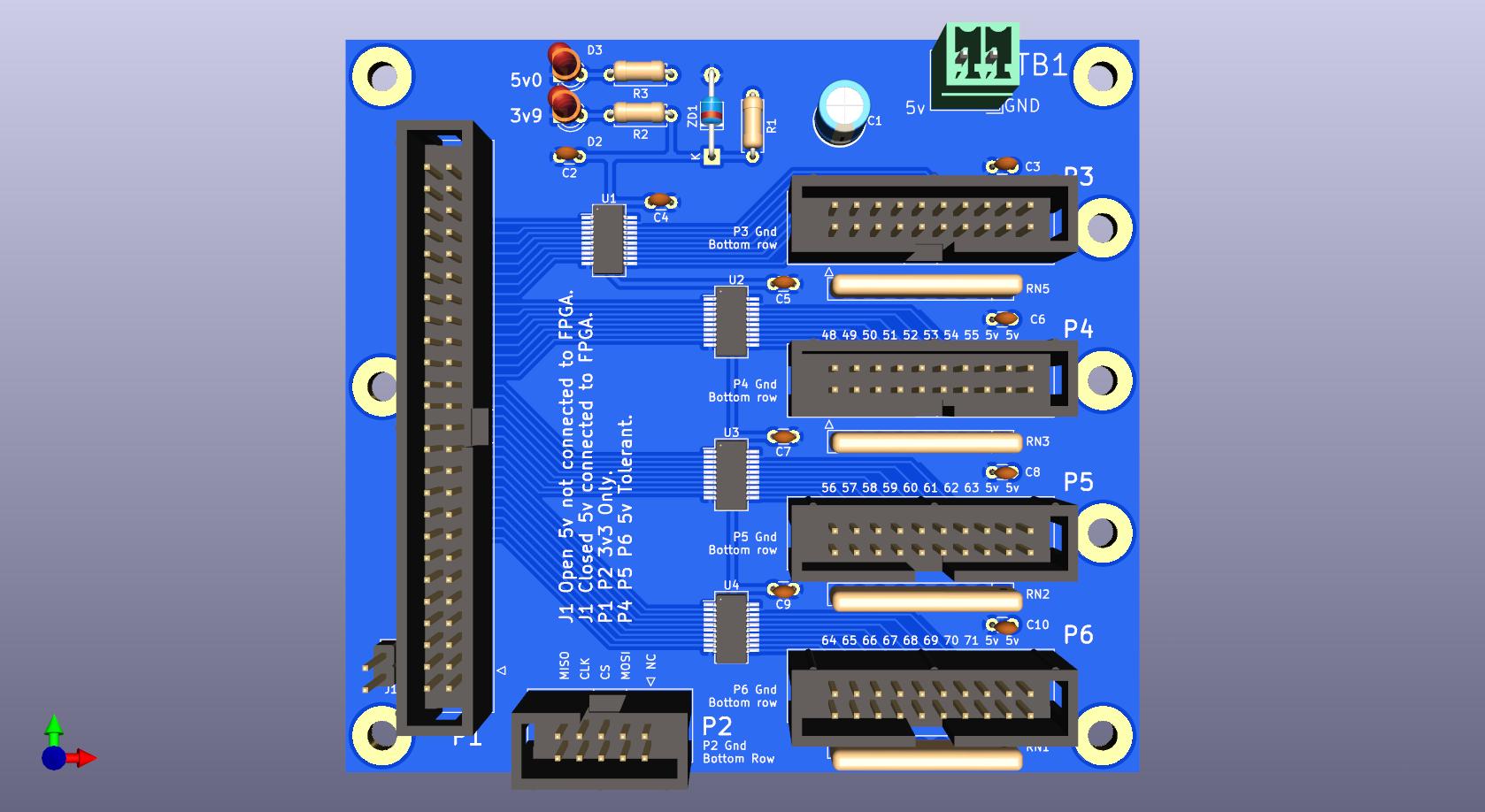

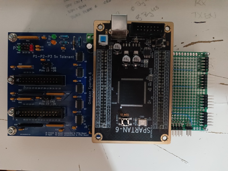

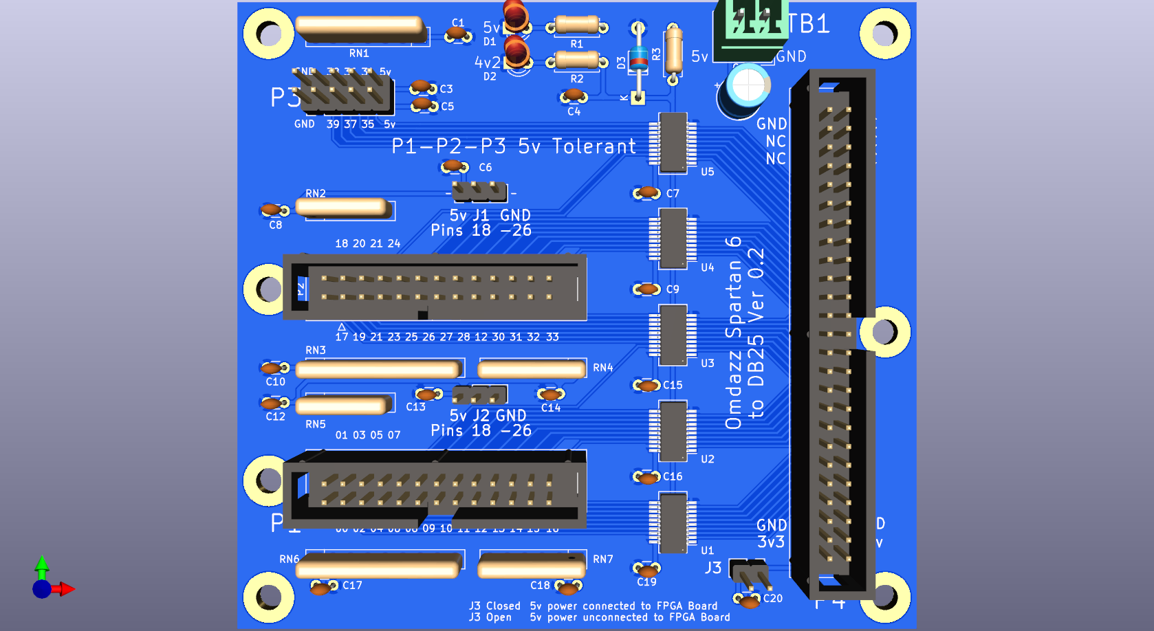

I've got a couple of prototype boards that work with the same Dev board which is about AUD $70 dollars now. It has the FET bus switches and has 2xDB25 connectors that will work with a standard Parallel Port breakout board or with the Mesa DB25 boards. There's also a 2*5 pin header that gives you 6 extra GPIOs with GND & 5v. That's the board that connects to the left hand header if you look at the dev board with the USB connector at the top.
The second board has the SPI connector 2x5 so that there's a ground wire between each signal. Then there's 4 of 2x10 connectors that have 8 GPIOs 5v power on the top 10 pins and ground on the bottom 10 pins.
On all boards the signal from the FPGA are routed through a get bus switch running on a 3.9v power rail, and on the "world side" pulled up to 5v, this gives about 3.2~ volts on the FPGA side . Pretty much the way Mesa do things.
The only smd parts are the bus switches everything else is through hole, makes assembly easier. Too many dollars to get the PCB fab house to assemble the board.

Some rendering of the boards I described, the dev board had the header pins changed to female and located on the underside.
Board 1:
Board 2:
Dev board with board 1 & prototype board 2
