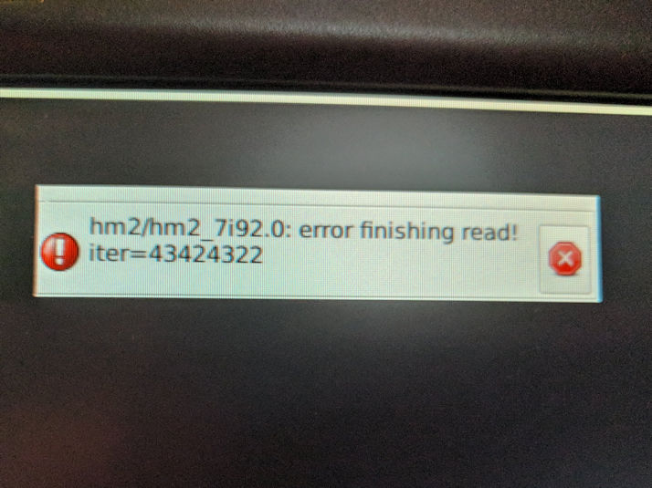

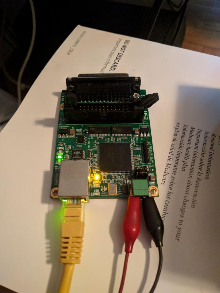

16 Jul 2019 19:37 #139591
by 10K
Replied by 10K on topic Mesa 7i92 Read Error
Mesa took a look at the board. They tested it for 72 hours at -51C and at 100C without a problem.
I put it back in my system. It gave the read error in 1 minute. I reset and got the error in 10 minutes. Another reset and it ran for about 8 hours before the error. I pulled the Mesa board from my enclosure, and powered it by itself with an external power supply and used a different Ethernet cable. Error in 8 hours. That test confirmed to me that I'm not experiencing any sort of electrical interference from another component in the CNC electronics enclosure
I then tested it on another computer. (This was incidentally the third computer I've tried.) I installed the pre-packaged version of LinuxCNC-uspace from the LInuxCNC website. I copied over my .HAL and .INI files. I used just the board with an external power supply. It ran for 18 hours before the read error with approximately 43 million reads. (See photos. Board is shown after failure. The green ethernet light blinks when it's working, but all lights were steady when I took the photo.).
I thought about one of PCW's earlier comments about the power being interrupted. When I used alligator clips to provide power to the board, I noticed that it seemed a little touchy on the connection, and I thought that maybe the power plug was not making a good connection. I replaced the power connector with a different type. I connected the board to the regular computer it's used with, and it failed after an hour with a count of 2.5 million. (Looking back at my records, several of the failures over longer periods have been around the 3 million mark)
I'm really at wit's end with the board. I've been trying to get it working for two years, and have tried out every suggestion I've gotten. Because it sometimes takes so long to fail, it can take an entire day to test even a small change. I don't think it's the computer, since I've tried three different ones. I don't think it's the install, as I've tried both the pre-packaged install and several built up from the various parts. I don't think it's electrical interference in the enclosure. All that's left is something caused by my .HAL or .INI file, or a board defect or design problem that did not show up in Mesa's testing.
Is there something I'm missing?

16 Jul 2019 20:25 #139592
by tecno
Replied by tecno on topic Mesa 7i92 Read Error
Run a test with UPS, you might have power-line issues.

16 Jul 2019 20:29 - 16 Jul 2019 20:35 #139594
Replied by PCW on topic Mesa 7i92 Read Error
Pretty strange, maybe a little more information would give a hint:
What version ofLlinuxCNC are you running?
what does "uname -a" report?
What does "ip a" report?
What times do you get if you ping the 7I92?
Also not sure of the 7I92 firmware version, newer versions will light the /INIT LED
on a watchdog bite. This can be a handy diagnostic to determine whether you have just lost
communication (the /INIT LED will be on) or there was a power cycle/reset (The /INIT LED will be off)

16 Jul 2019 22:01 #139615
Well the first ping of the test machine is broken (almost 6 ms)
You can check if the 7I92 has the watchdog -LED feature by exiting
LinuxCNC, if the INIT LED lights up, it has the feature

- Posts: 18025
- Thank you received: 5295
17 Jul 2019 00:33 #139652
You might try updating the firmware, at least it would be a bit more diagnostic
