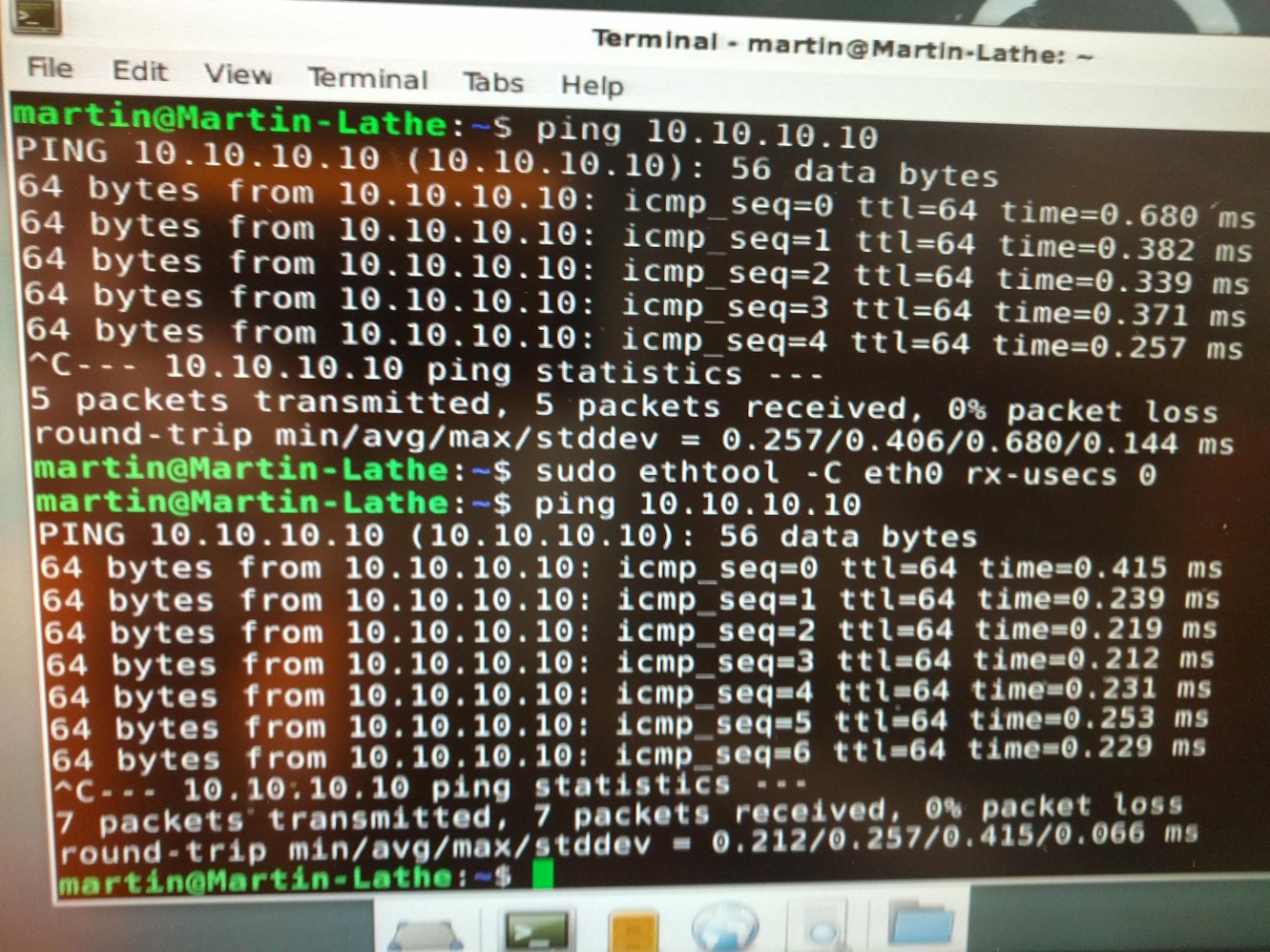

28 Jul 2019 00:50 #140780 by 10K
Replied by 10K on topic Mesa 7i92 Read Error
I made the following changes to the Ethernet settings:
etc/network/interfaces file
auto eth0
iface eth0 inet static
  address 10.10.10.12
  netmask 255.255.255.0
Ethernet connection 1 - IPv4 Settings
Address 10.10.10.12
Netmask 8
Gateway 10.10.10.1
DNS servers 10.10.10.1
I installed ethtool
sudo apt-get install ethtool
I ran
ping 10.10.10.10
before and after I issued this command
sudo ethtool -C eth0 rx-usecs 0
The results of the ping are shown in the attachment
The average ping dropped from 0.406 to 0.257, a 37% decrease. I saw something I saw before and discounted - the initial ping time was much longer than the remaining pings. I'm not sure if anything can be done about this.
I ran a test on the lathe computer, again using only the 7i92M and an external 5V power supply. The test ran for 18 hours without an error. I had to stop it at that point because I was going to be away from it for several weeks.
So, very promising results so far. When I get back to it, I want to test it with the 7i92 in the electronics enclosure. I want to see if it's just the ethtool command that's giving better results, or the other changes I made to network settings.
I see that I can make the ethtool changes persistent by adding the following to the /etc/network/interfaces file
pre-up /sbin/ethtool -C eth0 rx-usecs 0
I also would like to be able to put the computer back on my local ethernet, so that's another thing to test. For this i'll have to change the settings made to Ethernet connection1, since they disable all other ethernet connections.
