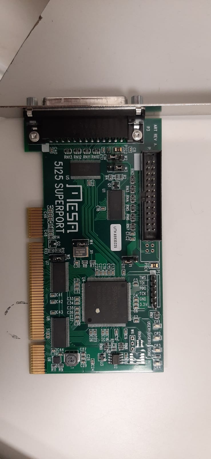

12 Dec 2019 10:50 #152523
by barisduzenli
Replied by barisduzenli on topic Rotary Delta Robot 4 axis
Hello,
We are using and AMD Athlon 64 PC + 5i25 + 7i77 and Delta Servos as mentioned above.
We wired as as in the atthached pdf file and set driver parameters (Speed mode, Servo on and disabling limit switches).
We could not get any movement. Drivers working in jogging mode.
I observed that CR1 doesnt flash or light up only CR3 as yellow and CR16 as red light up.
It is our first robot project experience. We scan the forum but still I can not be sure wiring is exactly right.
Thank you.

12 Dec 2019 11:14 #152525
by bevins
Replied by bevins on topic Rotary Delta Robot 4 axis
Are you sure your drives re in velocity speed mode? Alot of drives come default as step/dir.

12 Dec 2019 11:23 #152526
by bevins
You pins and inputs working? Hal configuration menu item. You can check your pins and ignals live.
If linuxcnc starts, dont worry about the LEDs on the card.

12 Dec 2019 11:54 #152527
by barisduzenli
Yes I changed P01-01 to "02" P02-15...P02-17 to"00" to disable limitswitch errors. And P02-30 to "01" to Servo On.

12 Dec 2019 11:55 #152528
Replied by tommylight on topic Rotary Delta Robot 4 axis
mesaflash --device 5i25 --readhmid
What does it return?
How is the 5V side on the 7i77 powered ?
