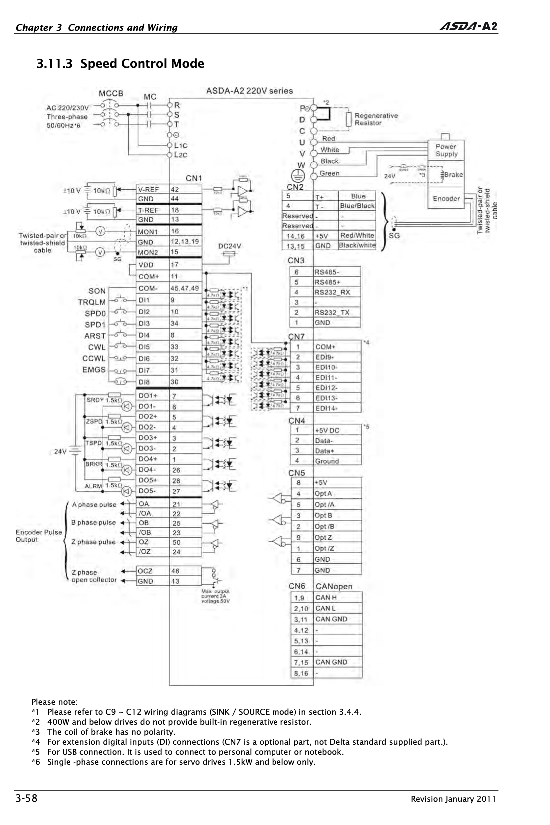

I looked at the manual and it looks like your not connected to analog ref gnd should be pin 44. .
7i77 aout => pin 42 delta servo
7i77 gnd => pin 44 delta servo analog input signal gnd
You have it connected to 13
Also you can try with battery.

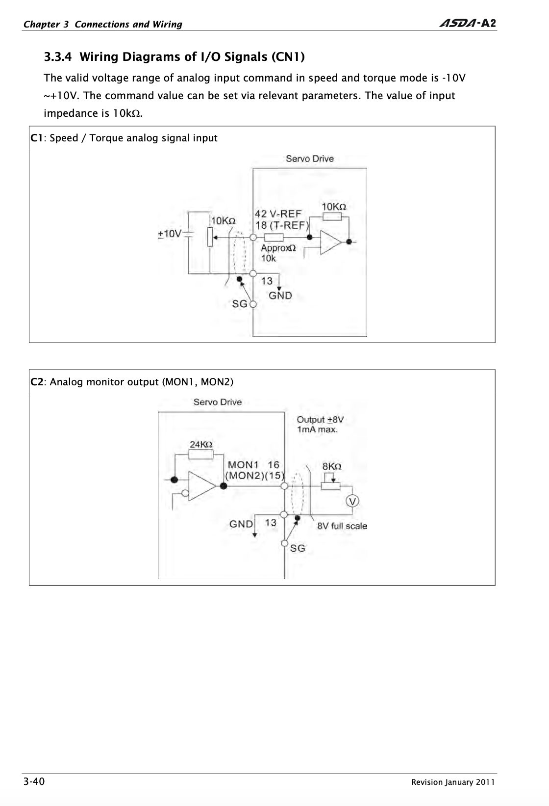

Yes, I saw in page 58, as you mentioned GND is Delta's pin 44. But in page 40 it is "13" too. Even I will change pin "13" to "44".

You can also disconnect the wire for +-10v velocity control and use a 1.5 volt battery connected to the +-10 input of the drive, and that should tell you which side the problem is.
If it doesnt move then it is not Lcnc side unless the drive is not enabled.
Replied by bevins on topic Rotary Delta Robot 4 axis

Hello bevins, I tried to drive servos with a 1.5 battery. And, it works. I am checking wiring. And I will try to measure drive outputs of 7i77.
Replied by barisduzenli on topic Rotary Delta Robot 4 axis
