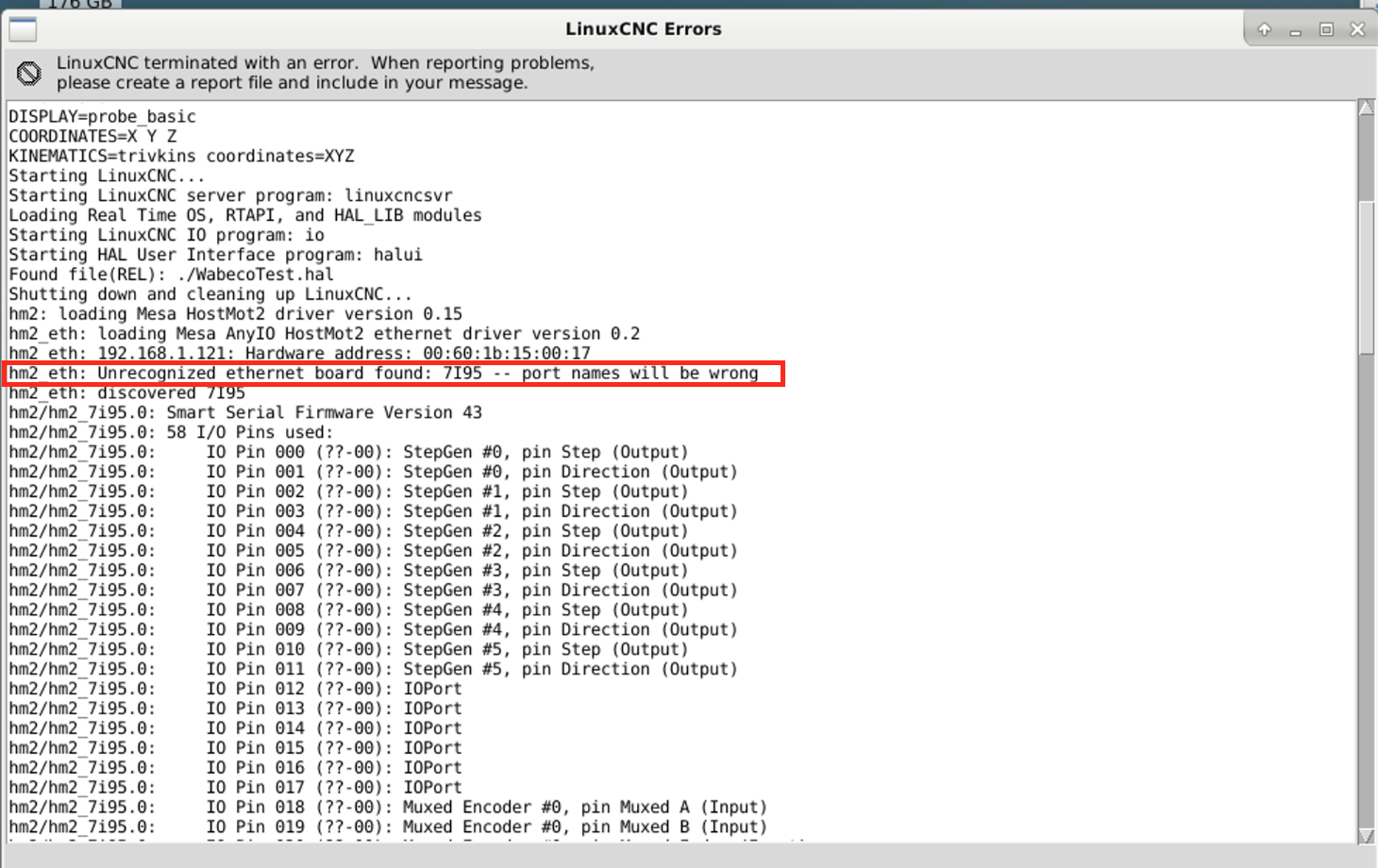

Mesa 7i95 was created by Gnevko
- Posts: 18025
- Thank you received: 5295
27 Nov 2019 18:13 #151376
Replied by PCW on topic Mesa 7i95
That will not interfere with basic operations but to support the isolated inputs you would need to install linuxCNC via source and apply the latest changes that provide 7I95 support

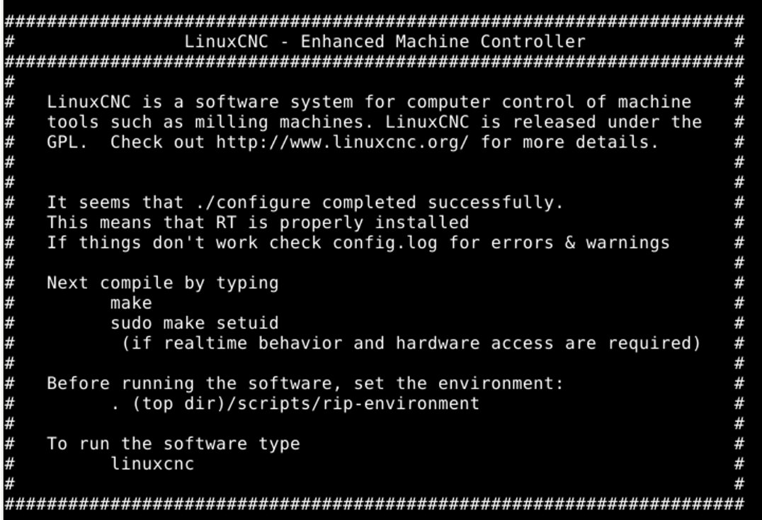

27 Nov 2019 20:45 #151393
by Gnevko
Replied by Gnevko on topic Mesa 7i95
At first I build linuxcnc without your patch and of course I received the same result as at start, but after I copied files -
something is going wrong hier but I can't understand what exactly:

- Posts: 18025
27 Nov 2019 20:51 #151395
Did you copy the new Makefile to the src directory?
- Gnevko
- Posts: 59
- Thank you received: 10
27 Nov 2019 20:52 - 27 Nov 2019 20:55 #151396
by Gnevko
yes, i checked it more times
copied to following directory: /home/cnc/linuxcnc-dev/src/
Last edit: 27 Nov 2019 20:55 by Gnevko.
- Posts: 18025
27 Nov 2019 21:27 #151399
Yeah the makefile was missing the latest new module
try refetching newmesa.zip, it should be fixed now
