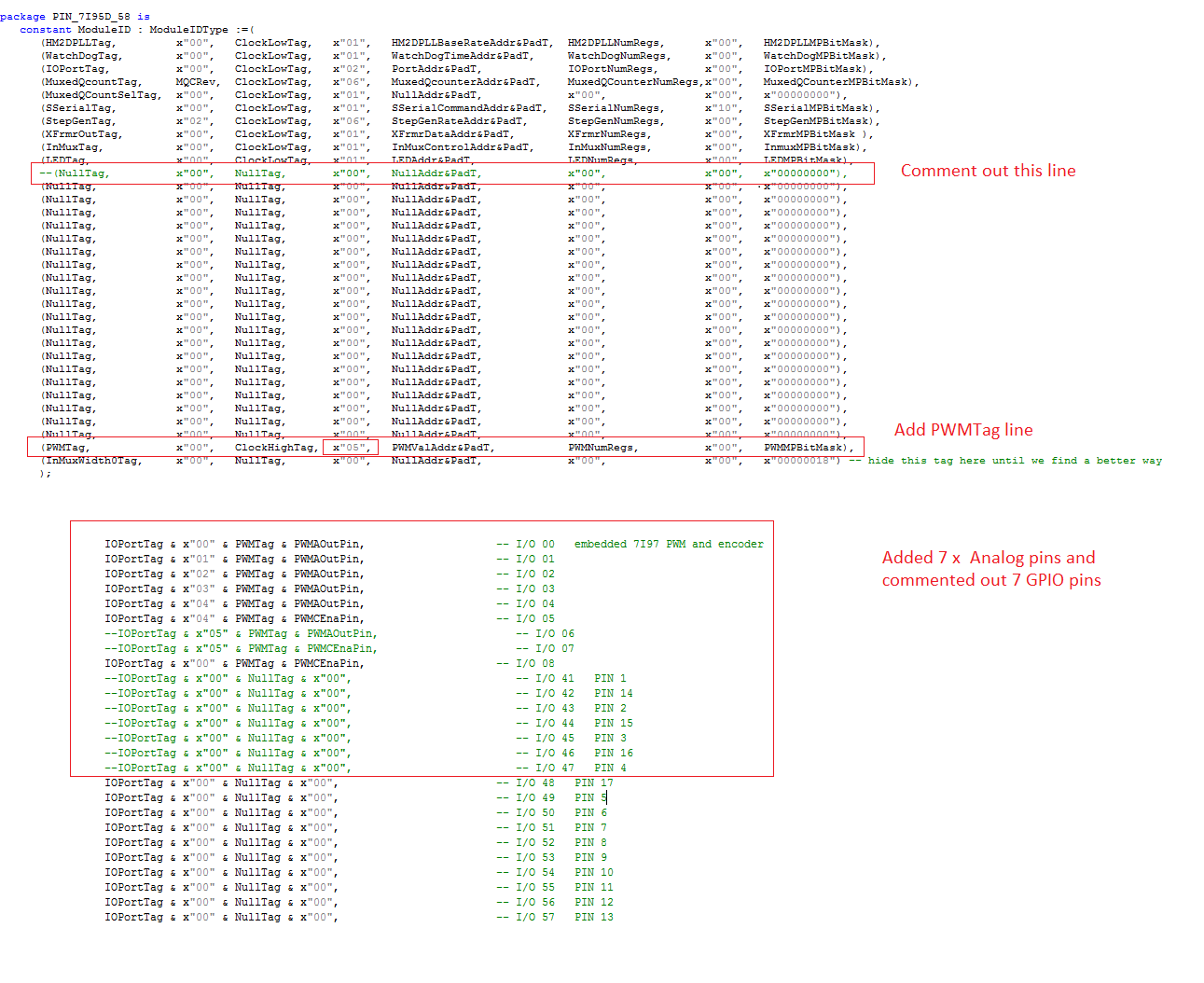

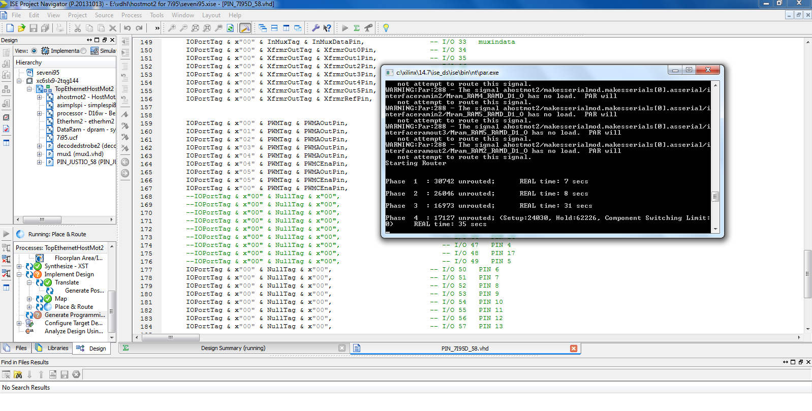

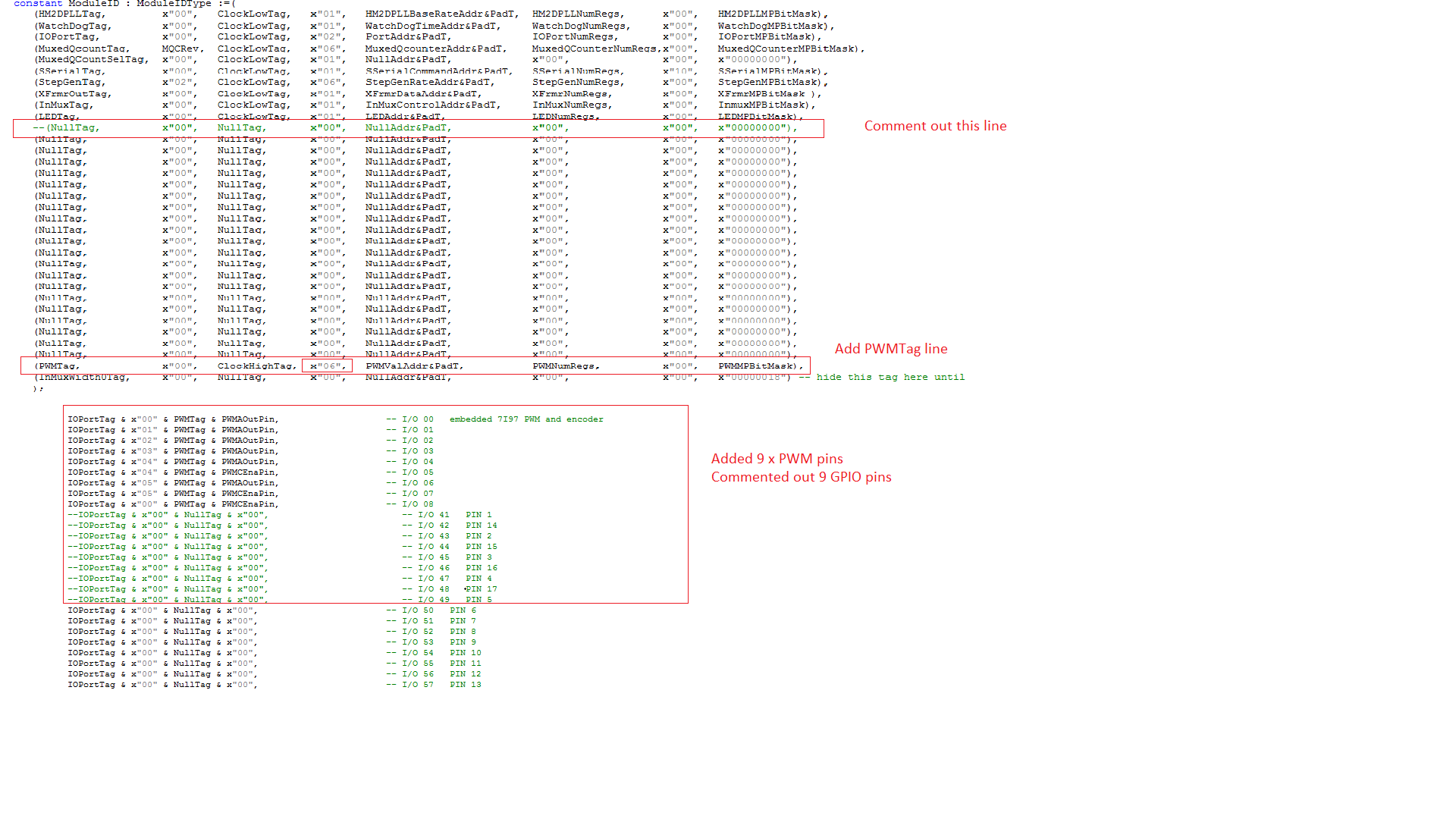

Hi Peter
i'm adding 4 x PWMAOutpin + 2 PWMCEnapin on 7i95 expansion port as below (copy from PIN-7i97D-51.vhdl and changed PWMTAG INSTANCES entry = x05) . And ISE can compiled to end without problem
I changed to 5 x PWMAOutpin + 3 PWMCEnapin but ISE stop at phase 4 during compile
Pls help to assist on this

21 Apr 2020 15:20 #164968
Replied by PCW on topic Mesa 7i95
You are probably out of FPGA resources, you might have to remove some unused
functions to add 6 PWMGens. Also when you add the PWM module to the
module descriptors, there must be no intervening null tags (the driver stops looking
for modules at the first null tag)

22 Apr 2020 05:42 #165046
by Hamada
Replied by Hamada on topic Mesa 7i95
Hi Peter
it worked after I cut StepGen INSTANCES entry to 4 only
Thank you so much
Hamada
