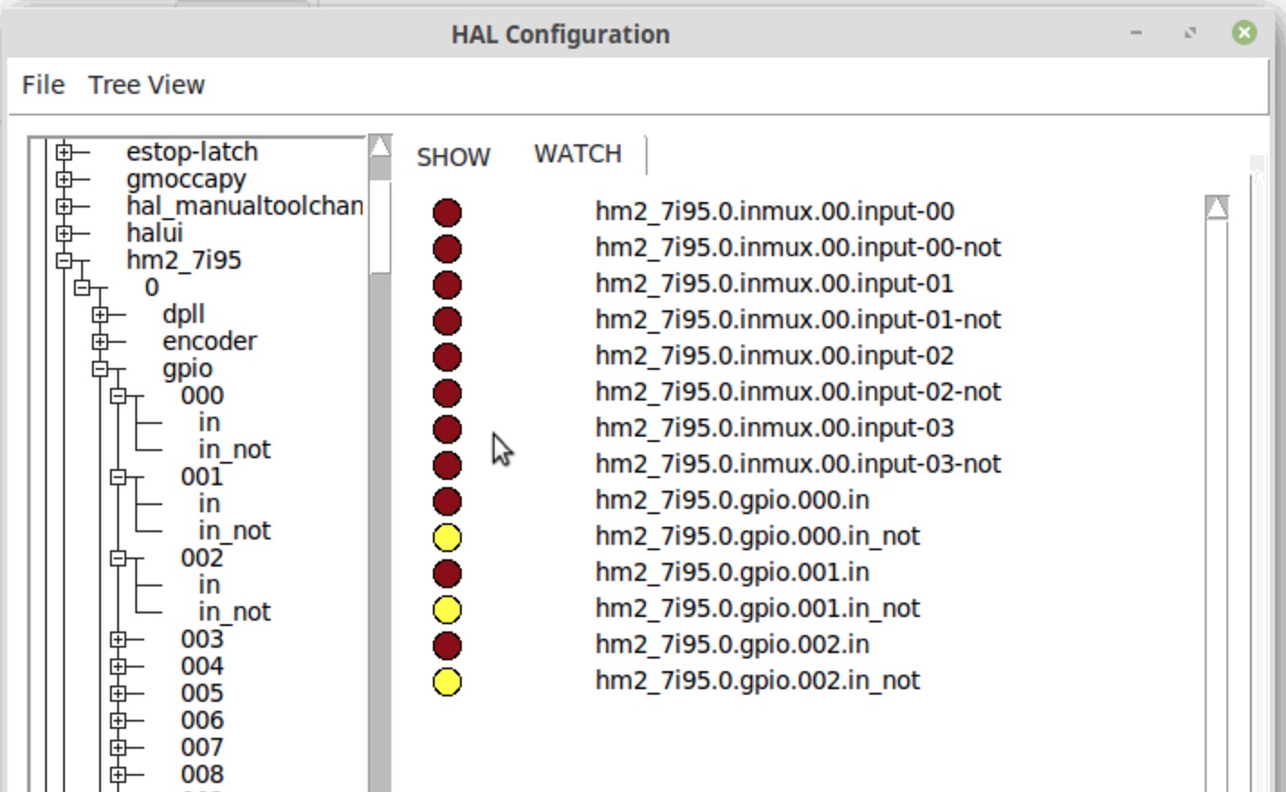

I noticed a problem with the 7i95 input / input-not pins in LinuxCNC 2.9 latest version. They normally flip-flop.
input-00 low
input-00-not high
input-00 high
input-00-not low
but input-xx-not stays low all the time.
input-00 low
input-00-not high
input-00 high
input-00-not low

Replied by PCW on topic Mesa 7i95
Yes, just fixed this but I don't have push access (missing parenthesis in "not" expression)
will try to get this pushed asap
Note, fix just merged so a pull of master will fix this now
