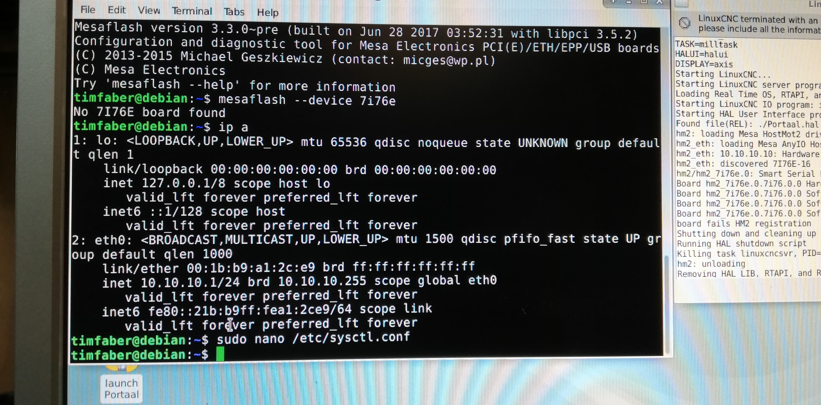

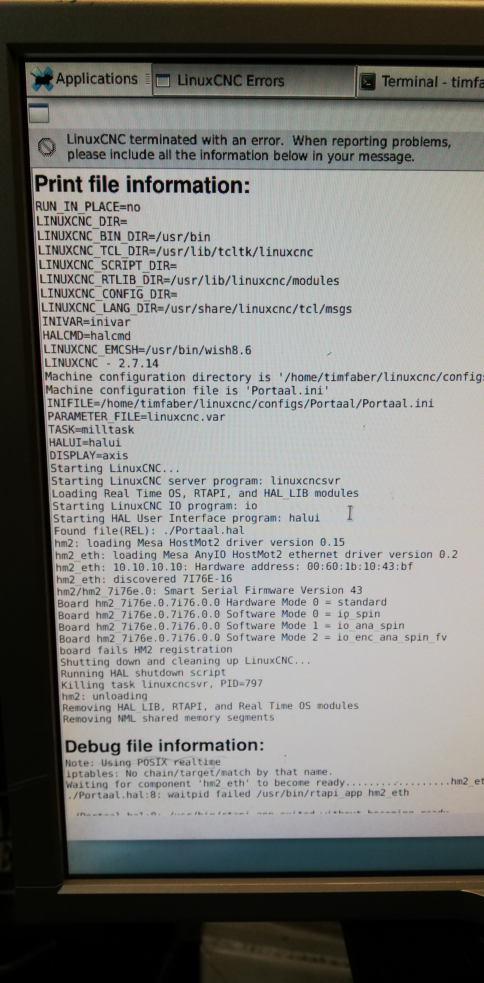

I'm building my own gantry cnc and want to use linuxcnc, i've ordered a mesa 7i76e card and wired it up. Used the pnfconfig to make a linuxcnc configuration for my machine. changed the ip in the hal file to 10.10.10.10 (jumper 3 up). Now when i want to start linuxcnc i get the error see attachment. i've also included some other information.
Now the strange thing is that i can ping to the mesa card and even managed to start linuxcnc but got another error (attachment). it seems that powering/dispowering my drives influences the starting of linuxcnc in some weird way.
And also, mesaflash doesn't recognize my card??
Anyone knows what im doing wrong? btw im not realy familiar in this "IT" stuff, more of a nuts and bolts guy

What does
mesaflash --device 7i76e --addr 10.10.10.10 --readhmid
report?

wow quick reply, mesaflash --device 7i76e says: No 7i76e board found. Also just added some more attachments
That's expected unless you use the entire command I showed

And your
Ip -a does not look right, there is no host ip or you have set the host ip to 10.10.10.1
There is a sticky topic in the boards section about properly configuring the network for use with Mesa boards.
Editing network files is not adviseable on new distros as they use multiple files for that and usually editing one of them makes a mess.
forum.linuxcnc.org/27-driver-boards/3559...ethernet-mesa-boards

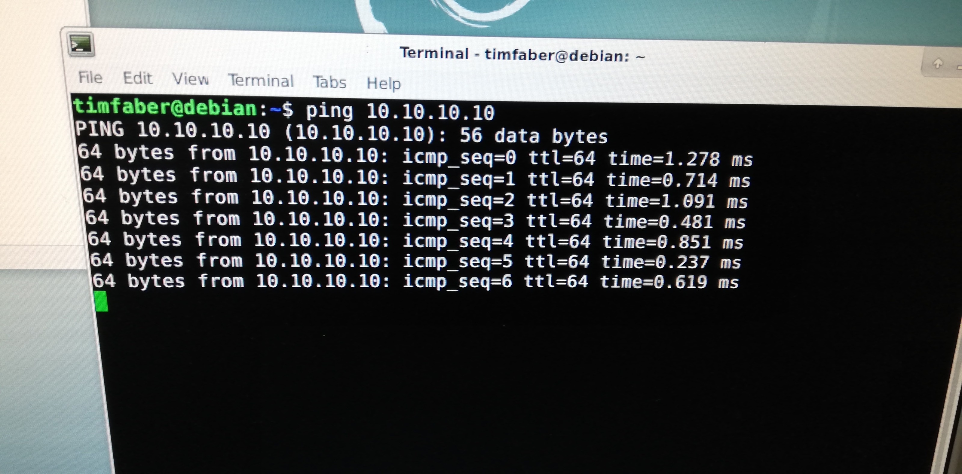

Your ping times are pretty terrible, It may be that you need to turn off IRQ
coalescing in the driver as mentioned in the hm2_eth man page
You could try the by hand first with:
sudo ethtool -C eth0 rx-usecs 0
and then retry pinging the card

I've tried to set it up as described in the sticky topic. But that didn't seem to fix it, is it right that that way should change the address of eth0 if I type ip a. Because it doesn't on my pc.

I've just changed 10.10.10.1 to 10.10.10.11 for eth0 which now is shown in ip a. That should be right?

The 7I76E needs to be powered before LinuxCNC starts, thats about it.
The error could be due to loss of packets because of some network setup error
(note the > 1 ms ping time, that's completely unusable)
Edit: here's the result of pinging a 7I76E here:

In your attached picture, the debug info says:
iptables no chain/target/match by that name
That means you have edited one of the networking files manually and they ended up not working. Now you have two different host names for your PC, they must be the same.
Linux keeps two files with the hostname:
/etc/hostname
and
/etc/hosts
Again just so other users can see this: it is never advisable to edit networking files manually
