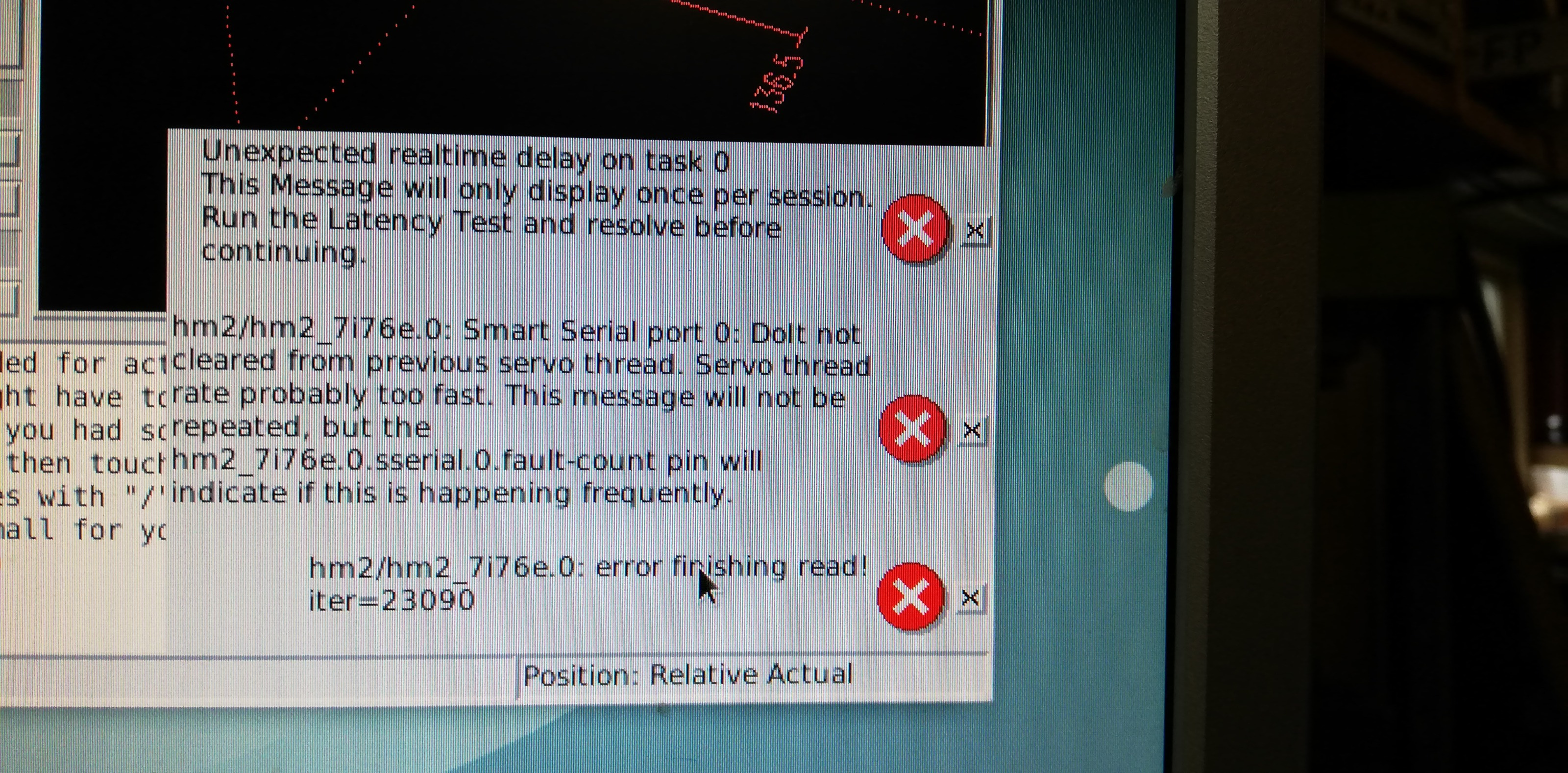

So this morning I started off with an fresh Linux install. Configured the network as described by tommylight's post. Turned off IRQ. And Linuxcnc started without problems, ping times around 0.13. Is there some way to always turn it off, because after a reboot the ping times where bad again and had to turn off IRQ again.
Now I still am getting the errors in the attacent, does this have anything to do with the fact that I haven't put much time into configuring the Hal and ini file?
Further more any tips on proceeding to configure my cnc/hal/ini?

The errors you have show a real time issue, likely with networking.
These would be expected if you did not disable IRQ coalescing,
or if you have the servo thread rate set too high, or if the basic
host PC latency is too high.
Did you run a latency test?

Yes I did run a latency test, it had a max base thread around 340000 ns and a servo thread around 320000 ns. And set it in the pnfconfig

The error seems to be about the serial ports, but I'm not using those? My setup is just a mesa card and steppers atm

The servo thread should be set to 1000000 ns (= 1 ms)
This is not something you should normally change
Also when you run the latency test you should not have a base thread:
latency-test 1ms 1ms
or
latency-histogram --nobase --sbinsize 1000
or

When I run the latency 1ms 1ms I indeed don't have a base thread. Changed the servo thread back to 1ms, now linuxcnc is running without errors. Only thing is that my cr1 led comes on.
Also don't have any steppers running yet, but have to double check my wiring and the documentation.
Anyway, thanks a lot for the great help so far!

The watchdog time out is set on 500000ns. My ping times are still around 0.1.

"The watchdog time out is set on 500000ns."
This is 0.5 ms which will cause an instant watchdog bite at a 1000000ns (1 ms) servo thread period
Normally this should be set for 10-50 ms (100000000 ns to 50000000 ns)
The servo thread is the real time thread that runs almost all LinuxCNC real time operations
including the generation of position waypoints for motion control, reading positions for
spindle synced motion, or probing operations etc etc, basically everything LinuxCNC does
in real time is done at the servo thread rate.
If your drive has + and - inputs you can wire them to the 7I76Es + and - outputs for differential drive
which has better noise immunity than single ended drive.
If the watchdog bites no motor /spindle motion will be possible (that's the main the intent of the watchdog hardware)
